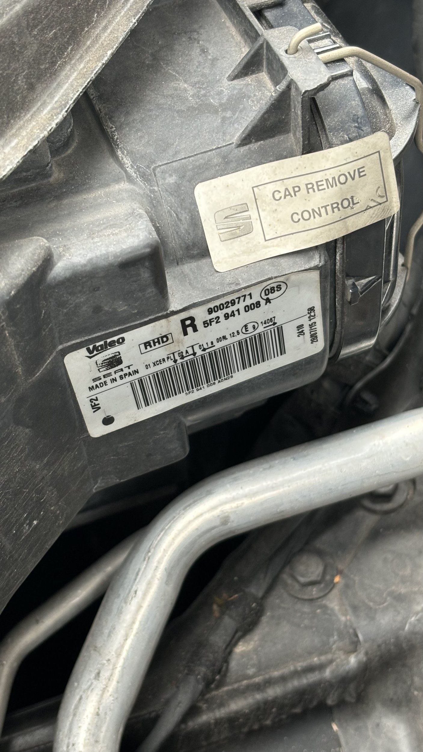

I have a 2015 Seat Leon FR Technology with LED headlights.
A few months ago I started to notice condensation in the drivers side headlight. Soon after, my light started flickering and showing up warning lights on the dash. While I have managed to remove the condensation, the headlight has completely stopped working.
I have looked at replacement headlight units which is working out quite expensive!
It looks like another option is to replace the control module ballast?
Has anyone been in a similar situation and replaced the control module with success? Is it better just to replace the whole unit anyway?
Also does the headlight unit need reprogramming/coding or are the modules/full units just plug and play?
Thanks
Headlight picture attached below
