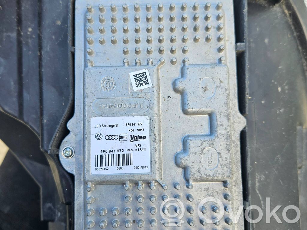

Yess, I think we mean the same. The module I'm talking about is located on the underside of the headlight. Should be like this for pfl;

Remember that the term/description "ballast unit" was only used for "arc light" ie gas discharge lamps/tubes striking-running in HID section of headlights, LED headlights and filament headlights don't need that kind of device.
Just clarifying this, nothing more intended.
