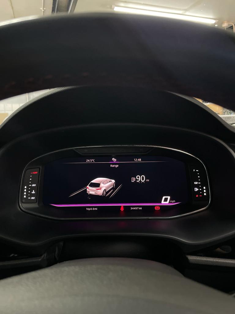

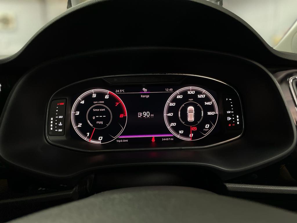

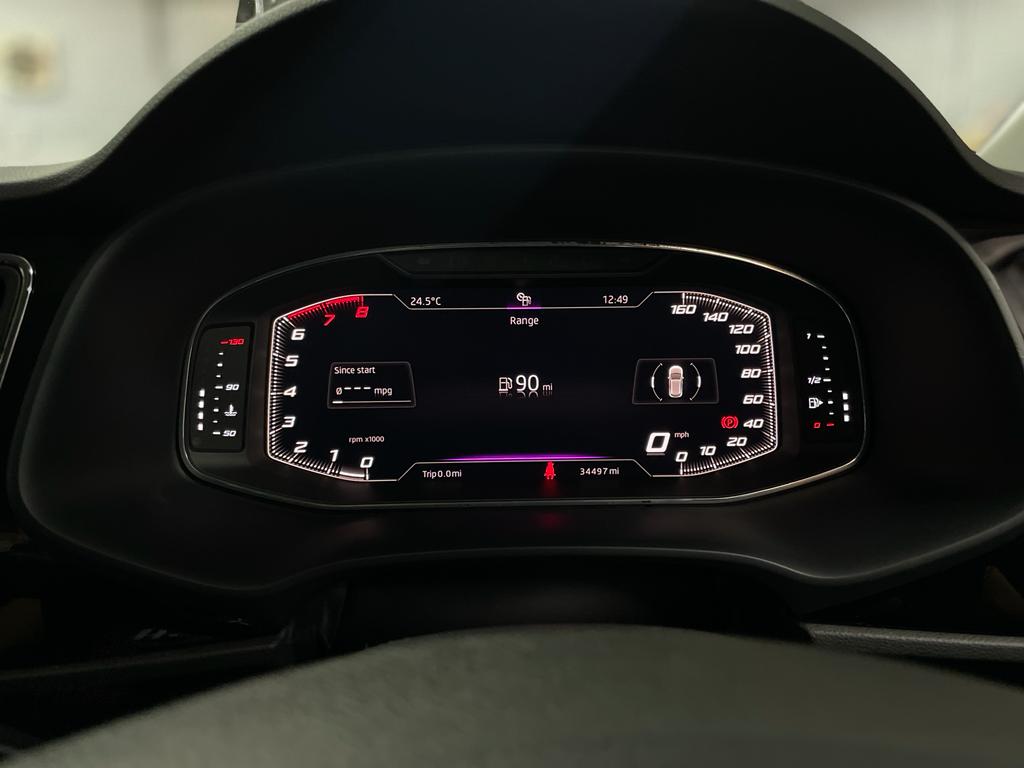

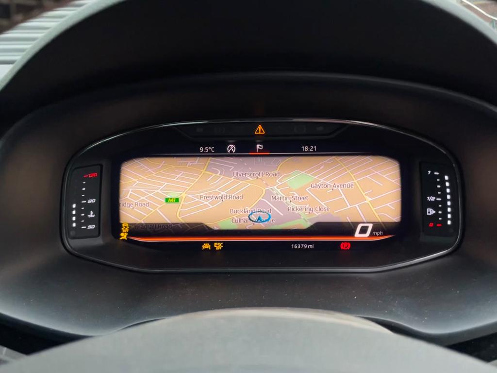

I’m wondering which MIB unit I need and which Virtual Cockpit to be able to display navigation maps directly on the VC in a Seat Leon 2017.
Currently, I’m considering the following MIB units:
- 5F0 035 020 J
- 5QA 035 874
- 5QA 035 858A
And I plan to pair it with this VC: Virtual Cockpit 575 920 321 A.
My questions:
Which of these MIB units actually support map display on the Virtual Cockpit? Does the MIB need a specific software version or map license to enable this? Are these combinations compatible with my VC 575 920 321 A?
I want it to look like in the pictures.
Thanks in advance.

Map data is transferred to virtual cockpit via a fiber optic cable.
You would need to buy that cable too.
And accordingly the infotainment unit should have the matching port to connect that cable, so it's the first thing to check when buying a unit.
As for the navigation, it is a protected feature, so it should be installed and activated via official or unofficial ways.
Most of the secondhand units sold in retrofitter circles would have it installed/activated already but make sure before buying anyway.
