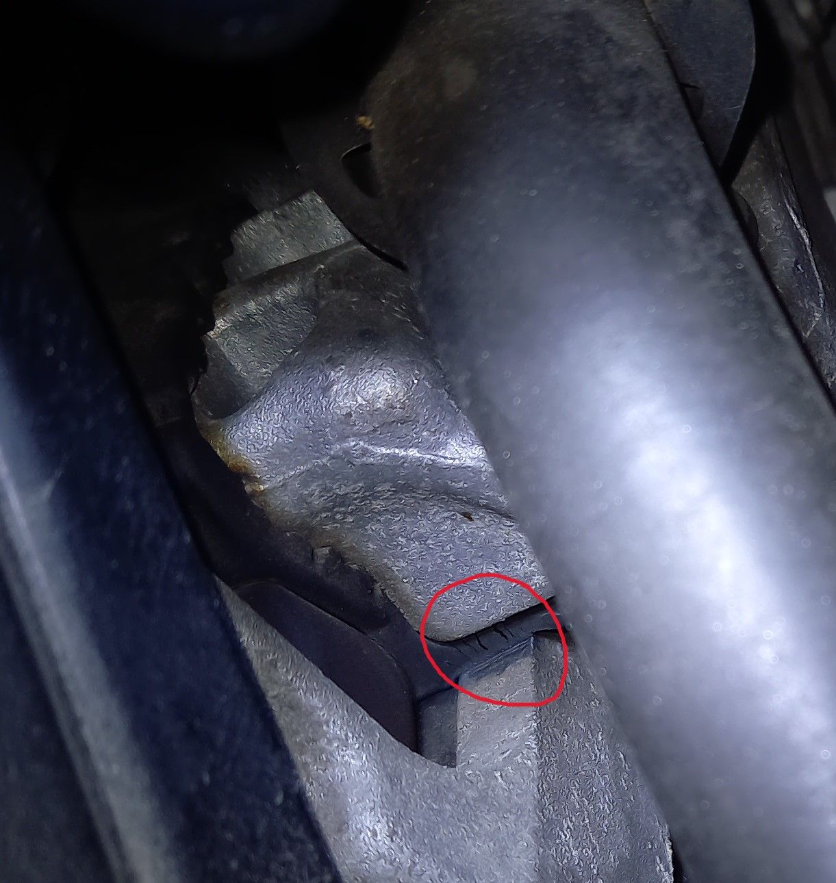

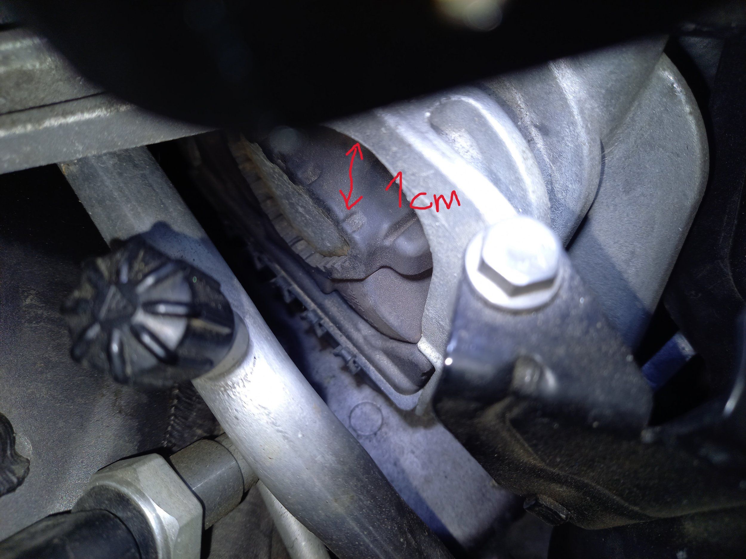

I checked the engine mount, i found little squeezing rubber, one side, and other i can barely put my finger to the frame and rubber.
Is this ok, or worn out?
