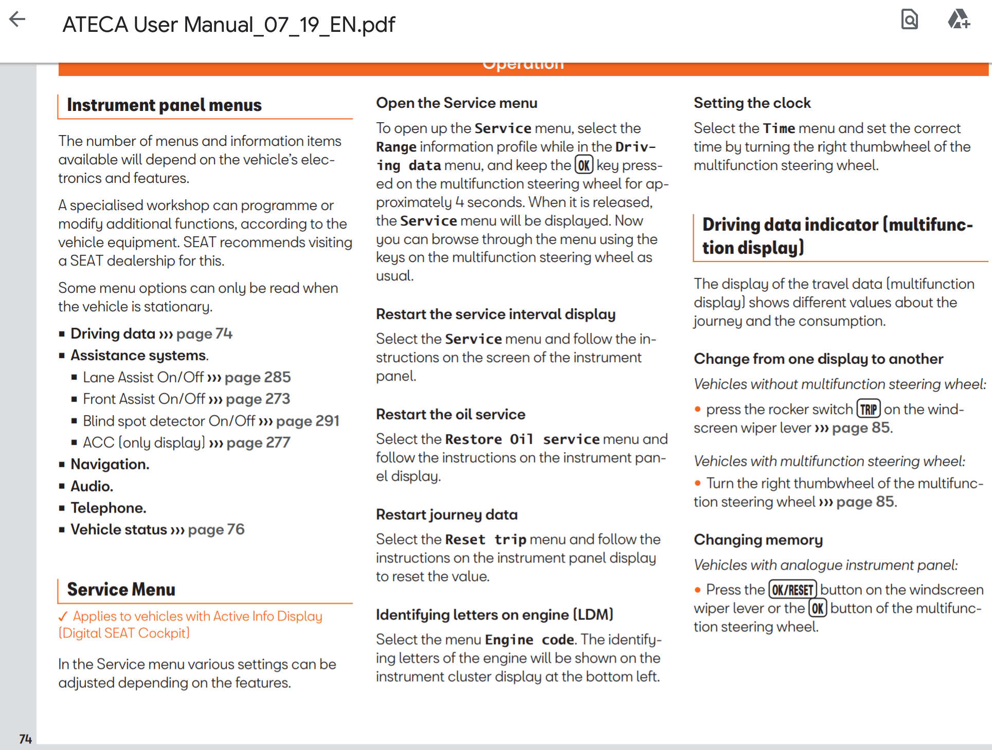

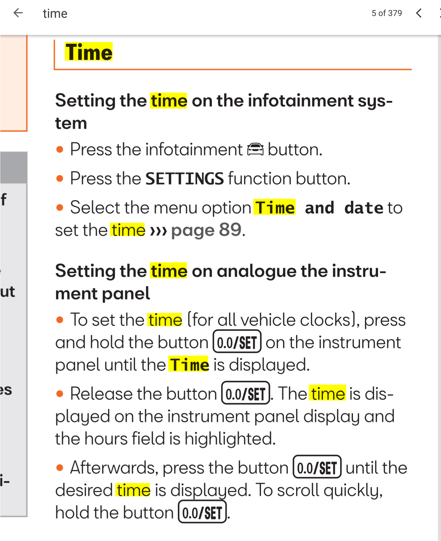

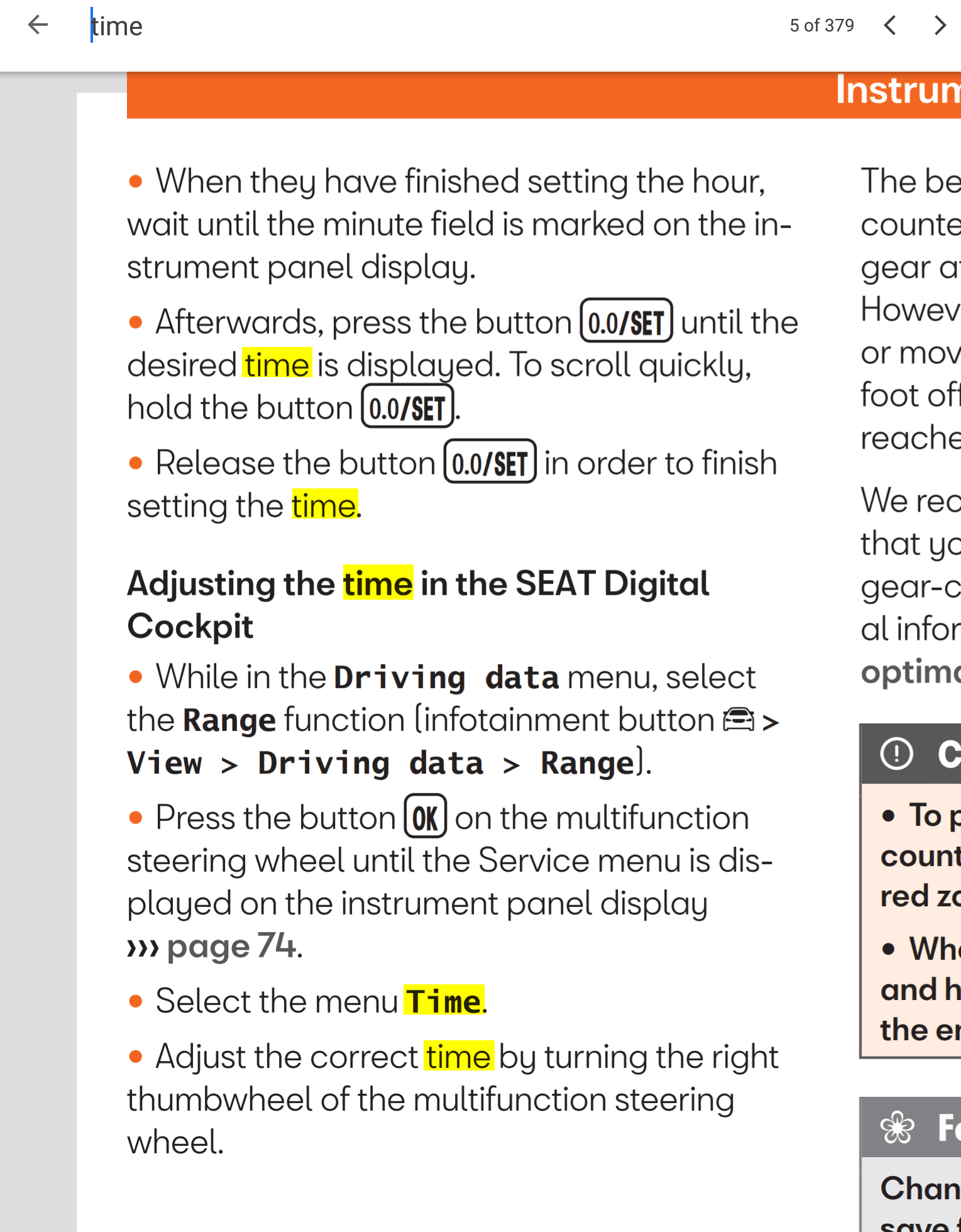

Have three pages from the manual. Whether it's analogue or digital the process is different. This covers both. Mine being analogue is the trip button like a digital clocks, yours being a digital display is the thumb wheel.
What you do to toggle between automatic time selection and manual isn't jumping out of the manual at the minute. That above is the manual method. I need to go over the menu in the car to find that but the above should get you going.

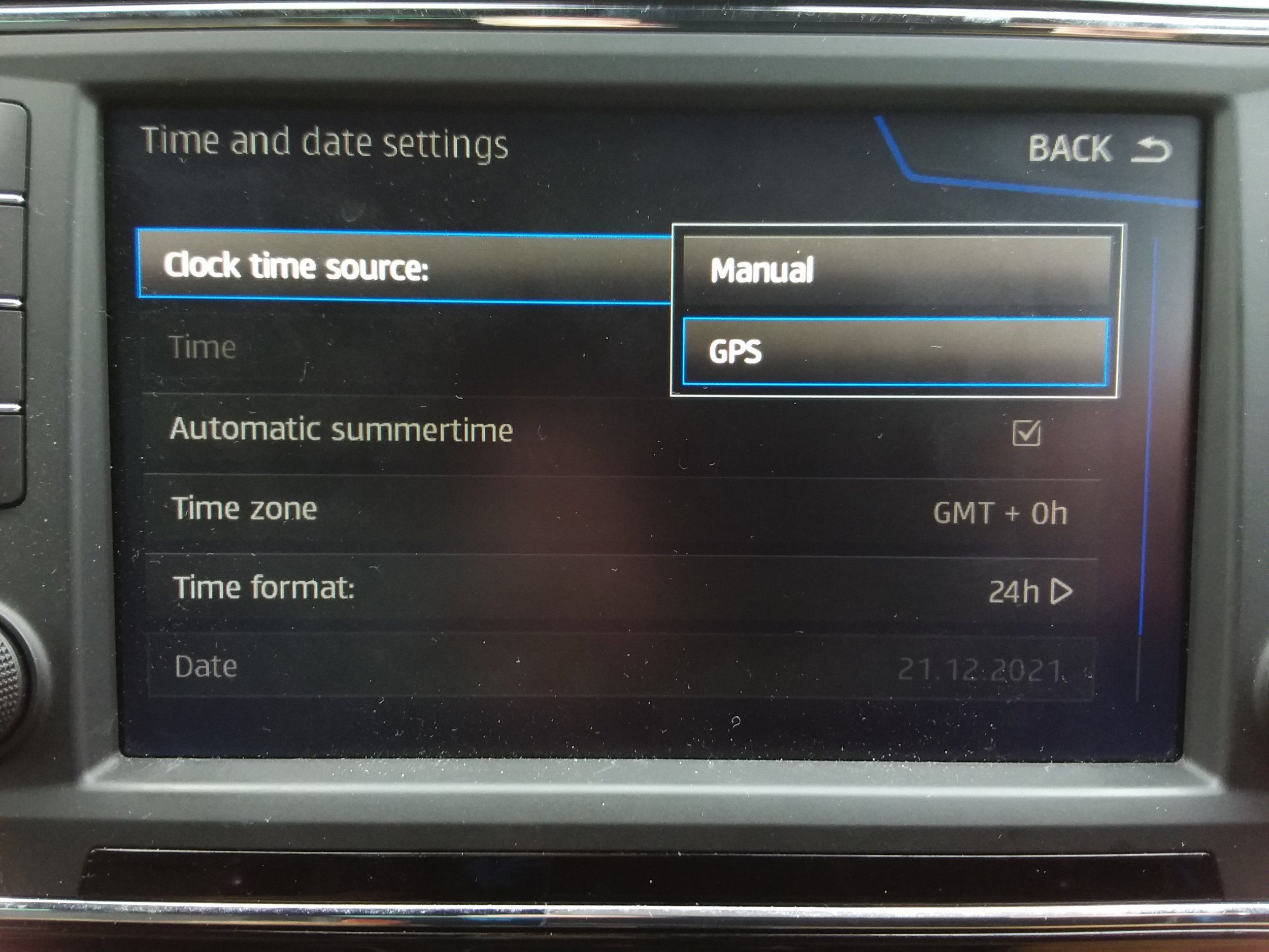

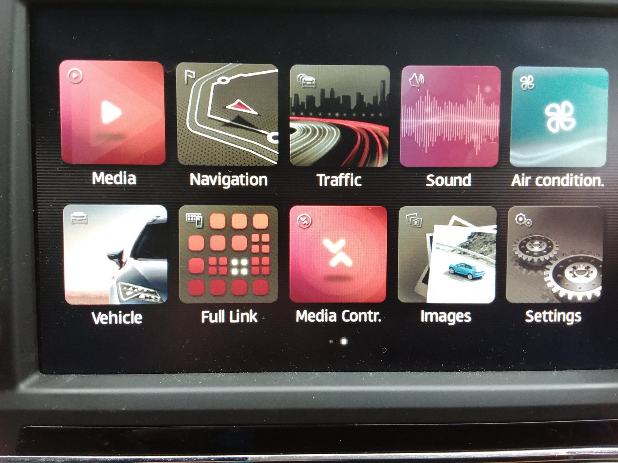

Auto time set

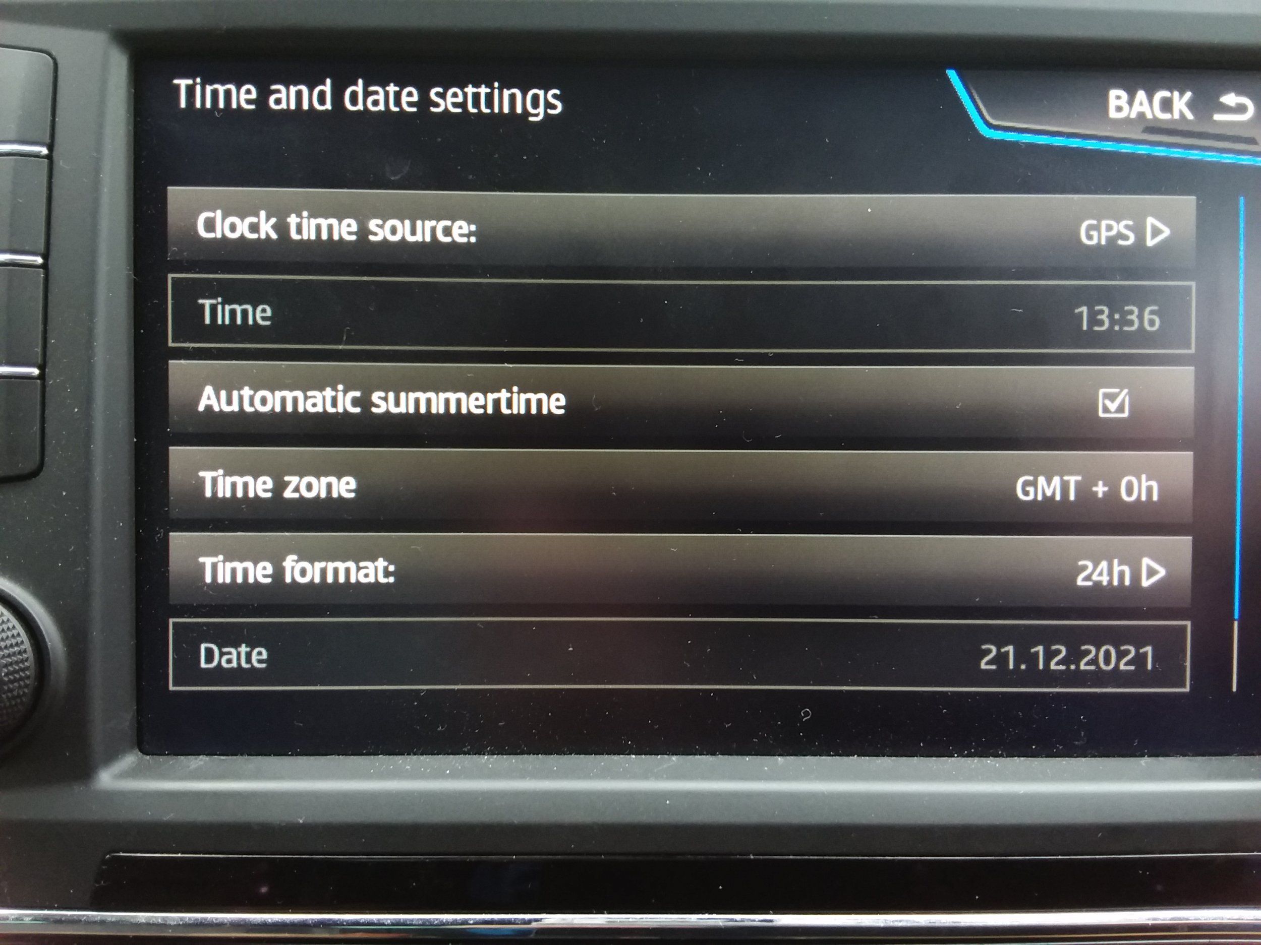

The missing bit I was looking for in the manual I have photographed below. These screens are common to the pre facelifted whether analogue or digital cockpit. The one that Seat was setting to clock time source to manual rather than GPS. There was suppose to be a firmware bug but I'm sure they fixed it by now. The Arona with the digital cockpit on delivery was on manual source e.g. you set it like an old fashioned clock. I reverted that to source, GPS. No problems. I'd recommend that for the Ateca
Somewhere, a long the line, my Ateca got reverted to manual. Just set that back to GPS. Either way I don't have issues unless I fumble the trip button which I reckon this mistake you can only make with the analogue cockpit since the setting is different for the digital cockpit.
Recommend. Set it to GPS and automatic summer time and you should not have any problems.

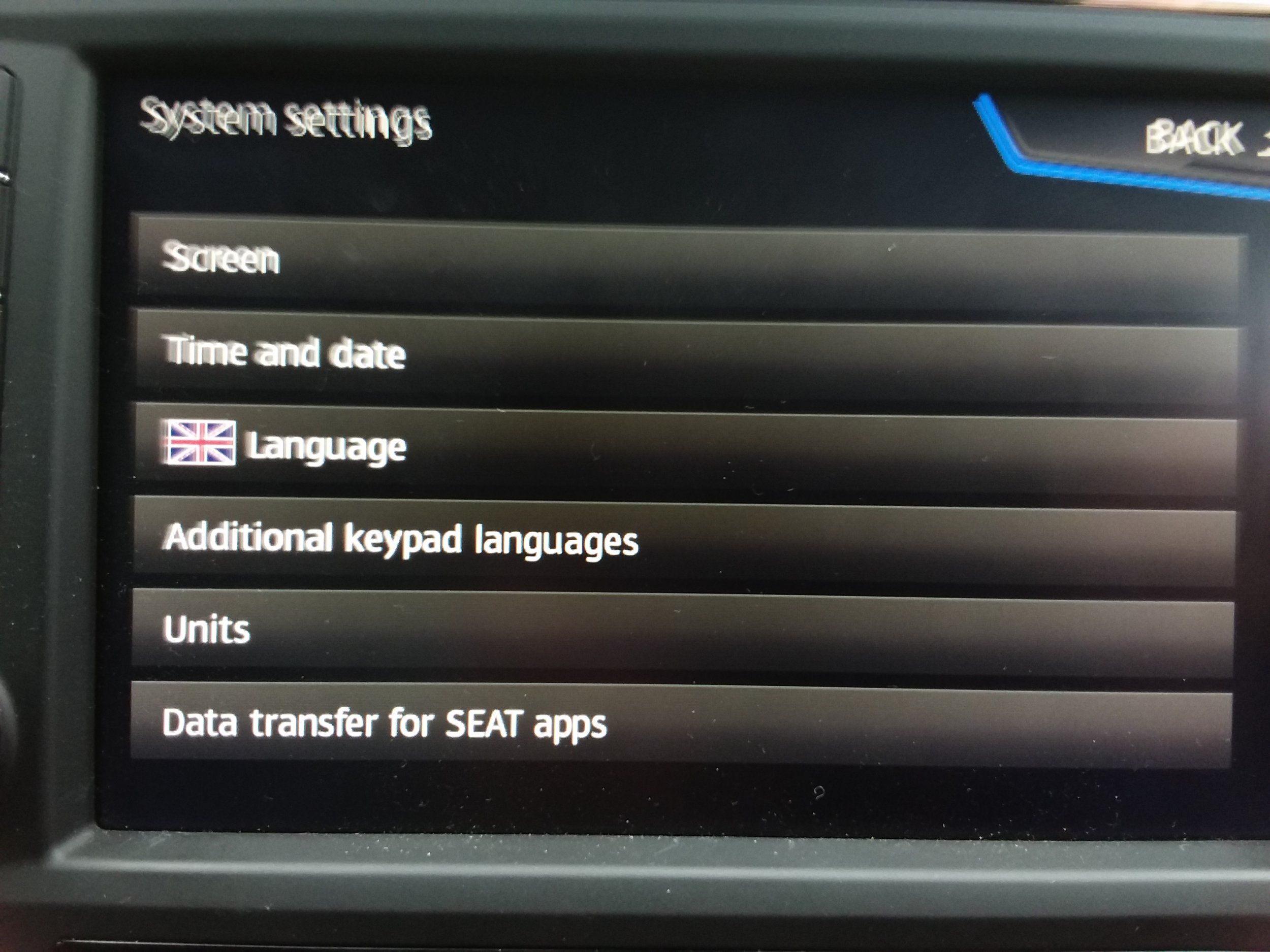

Do this:
  1. engine on,
  2. Infotainment menu button,
  3. settings,
  4. time and date,
  5. then click the options.
Bob's your Uncle - no problems.
If you get problems with the time jumping an hour set back to manual and do it that way (keep on automated BST)....
(old grey matter I seem to recall that I once suggested the GPS time package info was different by GPS provider. The later versions use the US, Russian and Chinese satellites as do mobile devices these days. Might be why it gets confused on auto sometimes on specific firmware ?, set to Auto, give it a try, if issues revert to manual using the screens)

Auto time set
Do this:
  1. engine on,
  3. settings,
  4. time and date,

Thanks Tell, I sorted it out that way. Cheers.

Saves putting the time in if taken by GPS... not too sure how mine got reverted back to manual... I will check how the Arona got left when we take it out (I know I put it on GPS since it was delivered on manual, same mib2 standard unit as yours). It's designed to be set to take the time off GPS so it doesn't gain or loose time but if in doubt flick it back to manual once the time is shown as correct. You would only do that if the GPS hour skip issue occurred which dates back a few years which I'd think they had fixed in software releases by now.
