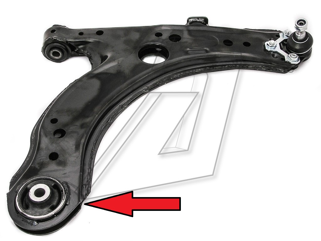

We also noticed that on both sides the lower control arm bushing is really greasy but they presume its the wax leaking from the chassis. The greasy part is marked by the arrow.
Only thing they found in VAG database is that it could be dirty wheel bearing housing (wheel hub), and the manual says it should be removed, greased with high temp grease and put back. They ordered the grease and they will call me when they have it in stock to do the maintenance under warranty.

Somebody has already posted reporting "greasy" areas near these front wishbone rear bushes - and thought that they are filled with hydraulic fluid - and so had ruptured and that was why there was some thing like grease around there - does that sound to be the same as what has happened to your car?
Nope, they checked in the database, cupra ones are pure rubber, not the hydraulic type.
About the sound, yeah it is a clunk. My problem is that it wasn’t there before and now its getting on my nerves. It happens every time when I am parking out so imagine the annoyance. Its not ‘somethings gonna break loud’ but it is ‘stabilizer rattle’ loud. I am sensitive to car noises, cupra suspension on sport or cupra mode is too loud on bumps anyway, keeps me wondering if something is worn all the time. BTW this bushing on control arm seemed way too soft for a sportscar when mechanic checked it with a crowbar.

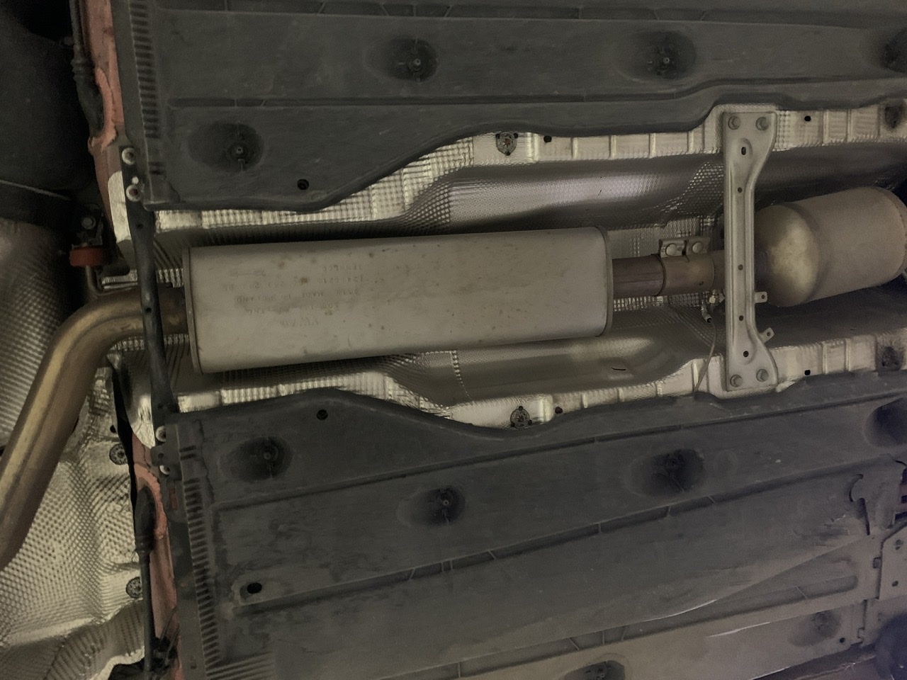

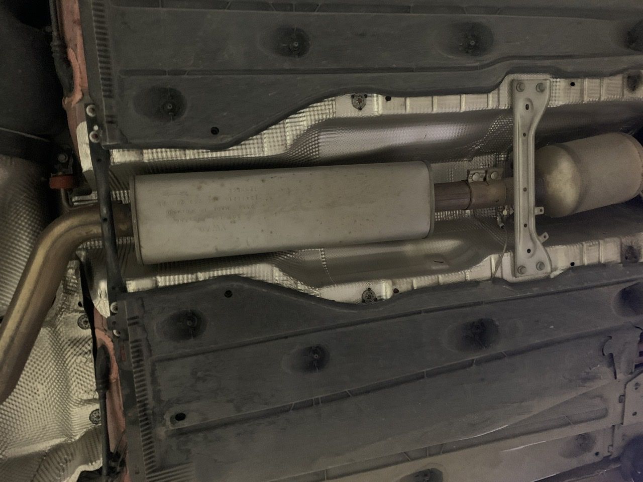

Here is a bonus pic for thread followers if anyone is thinking of doing the res delete in local shop for GPF cupra, as I am.
I am actually. Will the local provide the replacement pipe or will they order a part in?
Do you reckon they will let you keep the res box or will they want to keep/reuse it?
r3d
Nov 21, 2018
56
33
They will make the pipe and remove the res box. I want to keep it to be able to put it back if I wanted to.
The problem is the stainless steel pipe of that size (66mm diameter I think) is not that easy to bend properly - most places bend up to 60mm, but the guy that owns the shop is a racer and knows people so he said he could do it. I think it will cost a lot less that the res delete part (its a piece of pipe that costs 150 pounds, come on!). He made a new exhaust for my friend's civic type R fn2 from engine to tailpipe for only 450 euros, all stainless steel, stock dimensions.

Mm the garage I am talking to have the replacement pipe as a unit to swap in, I haven't got the details from him yet as to who provided the pipe and whether itll be welded or using clamps.
I am hoping to keep the box also purely for peace of mind.

Nope, they checked in the database, cupra ones are pure rubber, not the hydraulic type./QUOTE]
That was what I'd have expected it to be, but the other thread/poster claimed it was hydraulic, I posted back to say that, but after you mentioned greasy areas near your ones, I thought that I had got it wrong, Audi tends to use hydraulic mountings on the S4/RS4 well on engine mountings and maybe some others and it seems that some of their ones have contacts on them so that the driver gets a warning when one has failed! Good to know it is not an issue with Leon Cupras.
