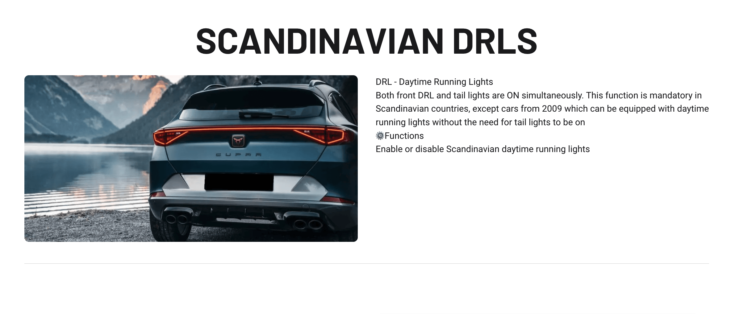

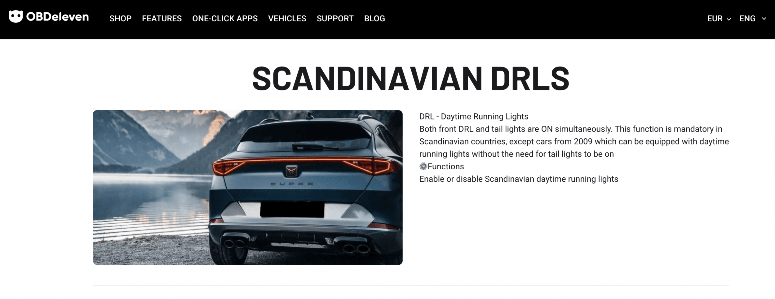

An OBD-11 App is available for that.

Hi This feature is called 'Scandinavian DRL's' I have activated in on my Ibiza using the CARISTA App. Its generally available on ALL VAG vehicles. Done it on several family SEAT and VW cars.
