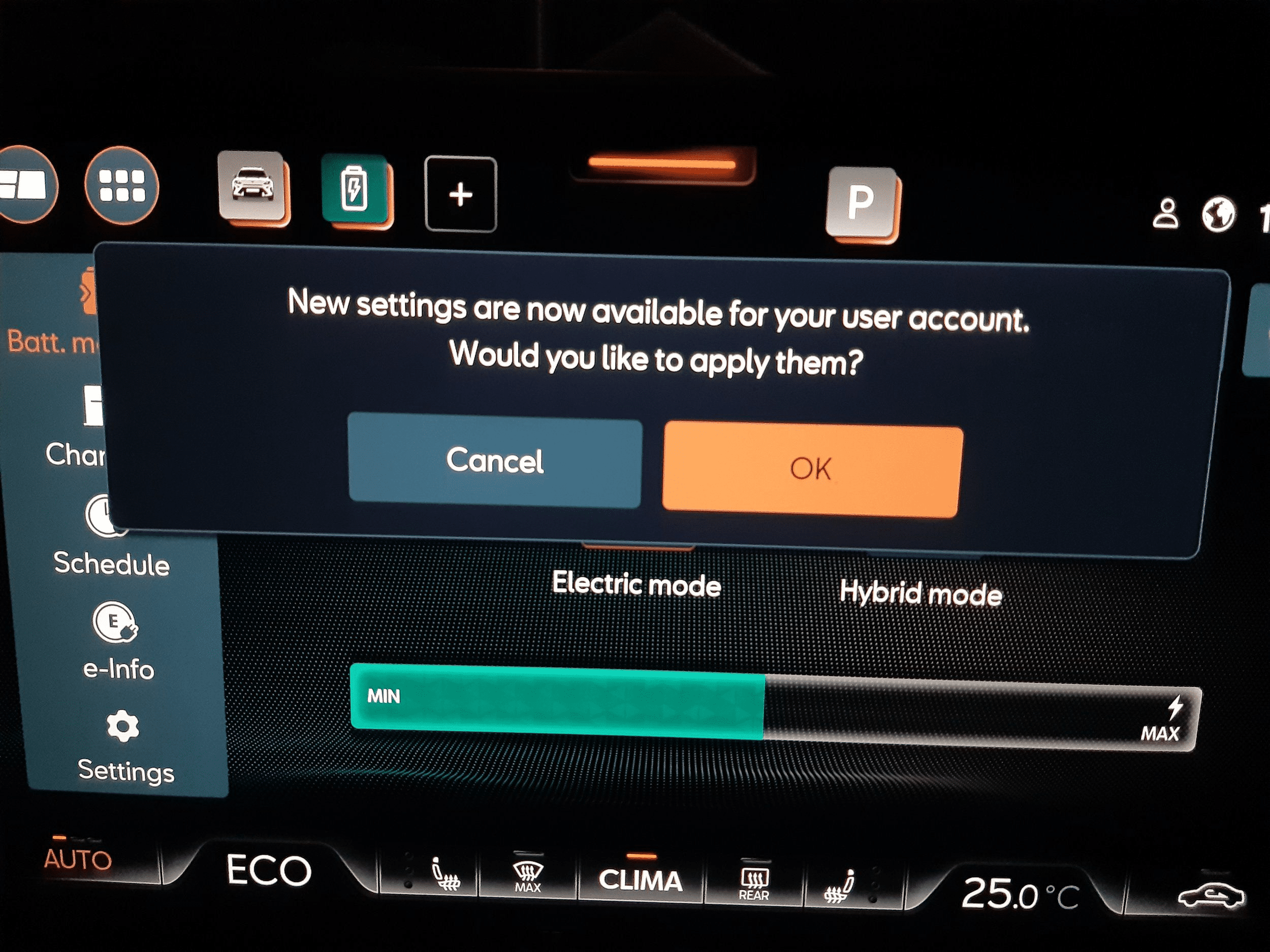

Cheers yes if it comes back ill be sure to photo or video the fault. We are still on the previous software rather than 2768. The loan car we had recently did have the 2768 software, but that was suffering from this message on every start which was super annoying. whether you said Ok or not
