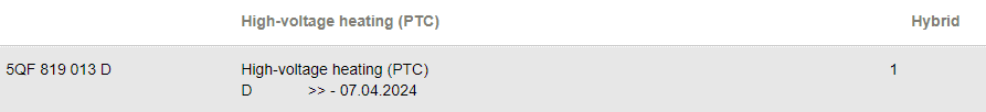

Correct - the Formentor PHEV does not use a heat pump for heating. Uses high voltage PTC heater.
It does use the AC heatpump via a heat exchanger for HV battery cooling.
