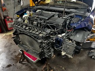

Hi All
Well, a trip to the local garage found that it's the radiator that's leaking, in the bottom right corner!
Cheaper than a Waterpump and thermostat housing I guess!!

Well, it's good to see that Seat made replacing a radiator an easy job!!!😡
