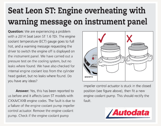

No problem. My widget started to fail/stick and caused very intermittent overheating which was very hard to diagnose. As a result the water pump (+ cambelt) AND thermostat (+housing) were replaced. That was not only expensive but the thermostat housing is under the charge cooler and it's a real faff to get at. There are 2 ways to do it and one of them involves removing the dipstick ?‍♀️.
This is an image of the `switchable` pump. The metal shroud/collar moves up and down to cover the impellor and effectively exclude the main coolant circuit and radiator when the car is cold. It allows the car to warm up quicker and improves emissions targets blah blah blah. When the car is warmed up, it `opens` to allow the impellor to utilise the main cooling system.
It's ok when it works but when it fails or starts to stick, it stays in the closed or partly closed position and your car overheats very quickly.
In this pic, the red arrow points to the widget and that moves up and down (open/closed) to allow the impellor to work. It was only designed to reduce start up emissions etc and it isn't necessary for any other reason that I can see. Due to its resounding success, there is now a wide range of OEM non-widget versions available.

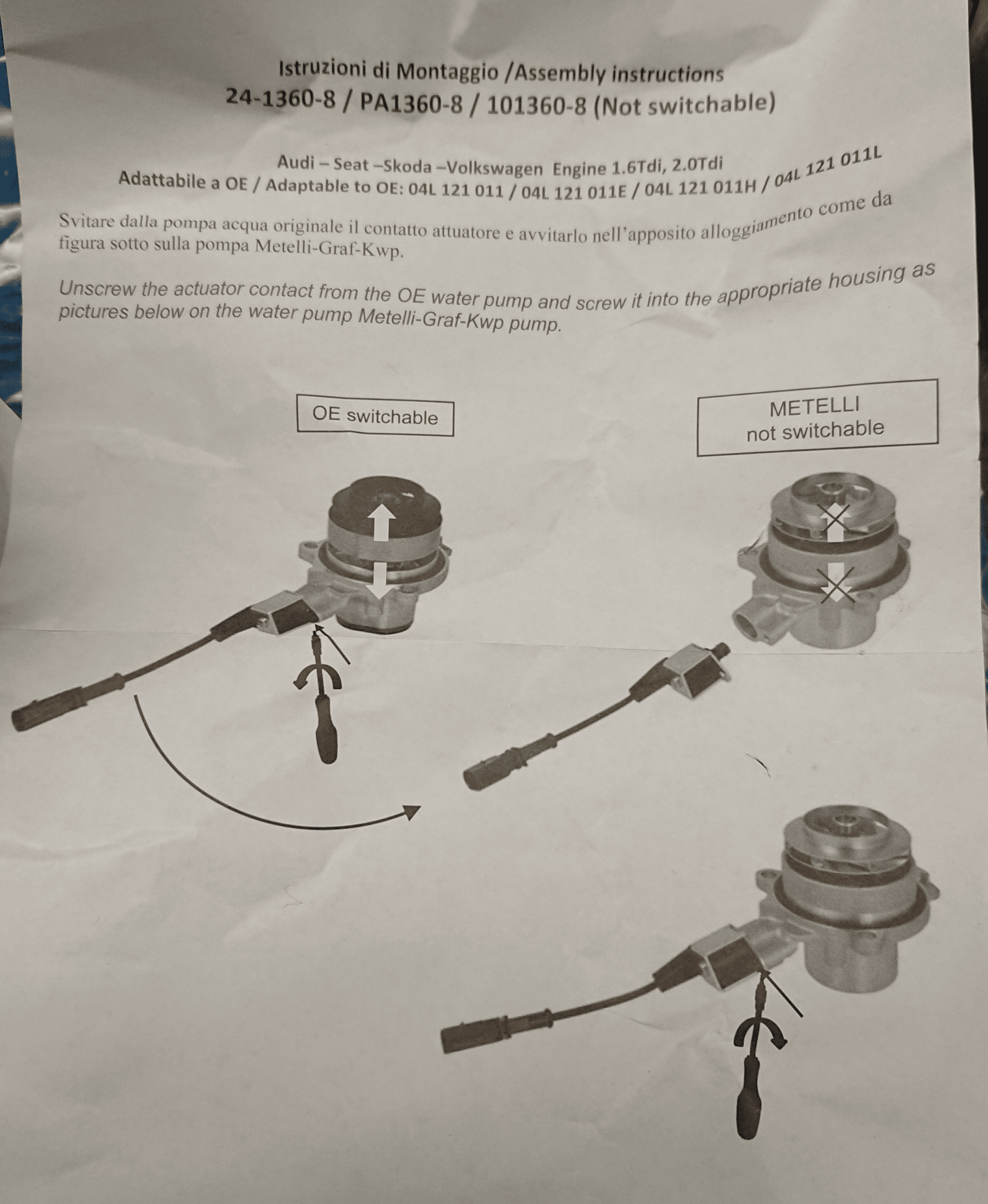

I'm pretty sure that mine was part of a Gates cambelt kit - this is the paperwork that came with it. I've had no issues since it was fitted in early 2020.
This is a close up of my pump, where the widget got stuck halfway. This caused a rapid overheat but then it would suddenly release and temps would drop. That was why we thought it was the thermostat initially as it behaved like a sticky thermostat. That got replaced with no joy, so the pump was next. Got the cambelt done at the same time. It was a tad early but worth doing as well.
There you are - now you know the dirty inner workings of the really annoying water pump.
Up to you if you go non-switchable. Not everyone has issues, but if you do, it's a nightmare.

When I did my cam belt I went with a new genuine pump with 'electric widget'
My original one was working fine. They are changed every 5 years anyway so figured it was low risk? There must be thousands of engines running fine with these.
I'm not saying it impacts every car but there was certainly a bad batch that impacted ST TDI's. Newer pumps may well be improved versions. It was such an unpleasant (and expensive) experience for me that I'm happy to stay away from them.
Agreed, If I was in your position - and had a stuck pump shroud and overheating issues I too would probably fit an aftermarket one without shroud.
Just adding some balance - and that (for me at least) they don't seem to be a common issue - yours being the only one which springs to mind on here? Compared to the heater matrix issue which I would say is very common/design issue - I think this coolant pump issue is rare.
You have to way up the chance of having a stuck shroud within 5 years before the next cam belt change vs using an aftermarket pump (none genuine) which can also have their issues (bearing/seals are not perfect) and the longer warm up time - which maybe can effect other parts of the engine if more short journeys are done? Maybe it increases DPF warm up time? Maybe negligible?
