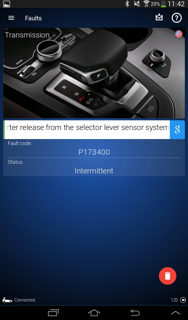

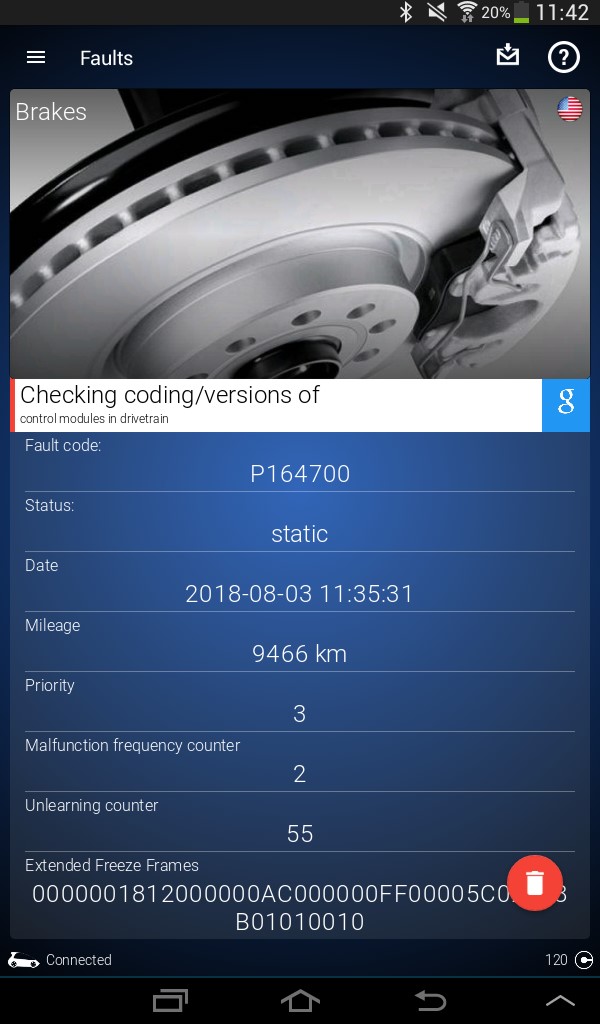

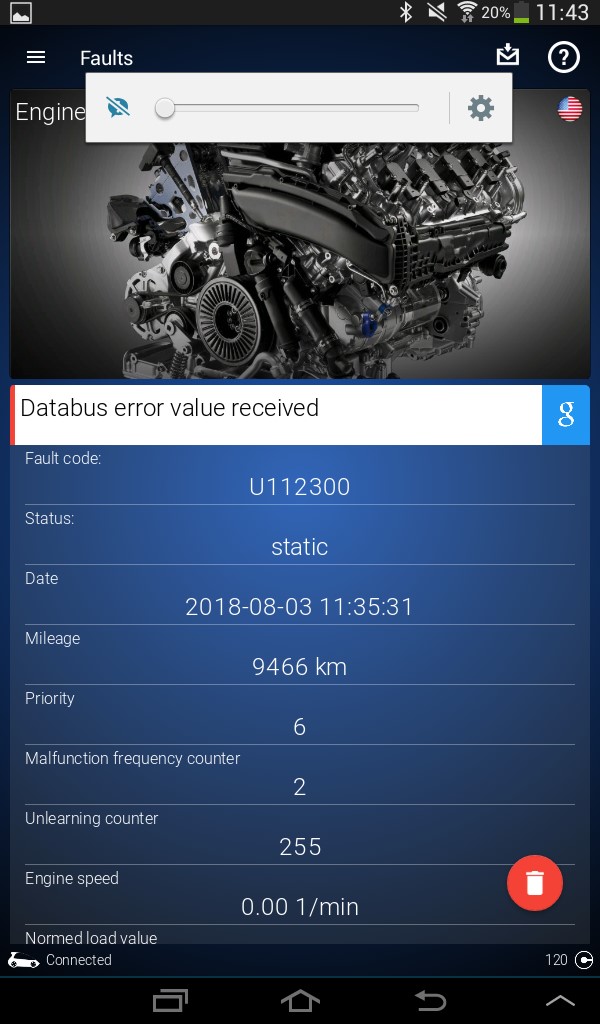

Completed some testing on the Throttle Mods available via OBDeleven on a facelift Cupra 300, 67 plate non ACC.
Starting with a stock car, no mods a full system scan was completed which showed no errors/faults identified.
Attempted the Audi Throttle Mod as shown below
Select Control unit 01- Engine
Select Long Coding (1)
Select Byte 0,
Change Bit 0-2 from Seat to AUDI (02)
Completed another scan post mods and got the following errors/faults ( as well as an Amber Cruise Control Indicator with an Apostrophie when the Cruise Control Switch was moved to On.)
01 - Engine: U112300 Databus Error Valve Received.
02 - Transmission: P173400 Starter Release From The Selector Lever Sensor System.
03 - Brakes: Checking Coding/Versions of Control Modules in Drivetrain.
All faults were reset and the Audi Throttle Mod reversed.
Another scan was performed and this indicated no errors/faults.
