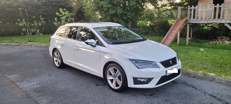

Hi, first post, new owner here, I have a new to me 2015 FR ST 1.8TSI , 1 owner, 180KMs . for me its been an odd step from a long term mk5 GTI DSG back to a manual car again. Anyways I have an odd feeing the throttle is unusually jerky. I feel that lifting off the throttle while moving there is a bit of an abrupt switch to the power cutting out after 0.5-1 seconds later. and the same while engaging the throttle. it a little jerky between power on off. I get a bit car sick over thinking about it. Also in stop start traffic it hard to creep smoothly at v low speeds and I have to feather the clutch a bit too to avoid kangarooing's. I have other manual cars long term so this is not a critic of my driving style or ability to drive !!
Can anyone relate to this accelerator feel ?
