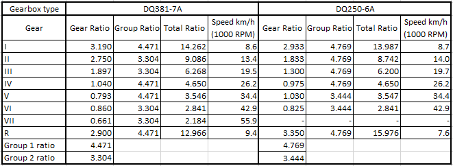

Based on the info available at seat.com about DQ381and info found in an older Leon brochure about DQ250 ratios, I put together the following table:
It shows that gears I-III are very close (with DQ381 being just a little bit shorter) and gears IV-VI are identical. I was quite surprised by that, I was expecting DQ381 to be shorter for gears I-VI, with VII being a little above VI from DQ250...
The speed for 7th gear 1000rpm is 55.9/1.609=34.7 mph, which is in line with the value given two posts above.
Giving absolute maxima of:
1: 36 35
2: 58 56
3: 82 81
4: 109 109
5: 143 143
6: 155 155
7: NA 155
Both assuming a rev limit of 6,700 which seems accurate from my own car and intervention of the speed limiter at 155 mph which, of course, i couldn't comment on.
