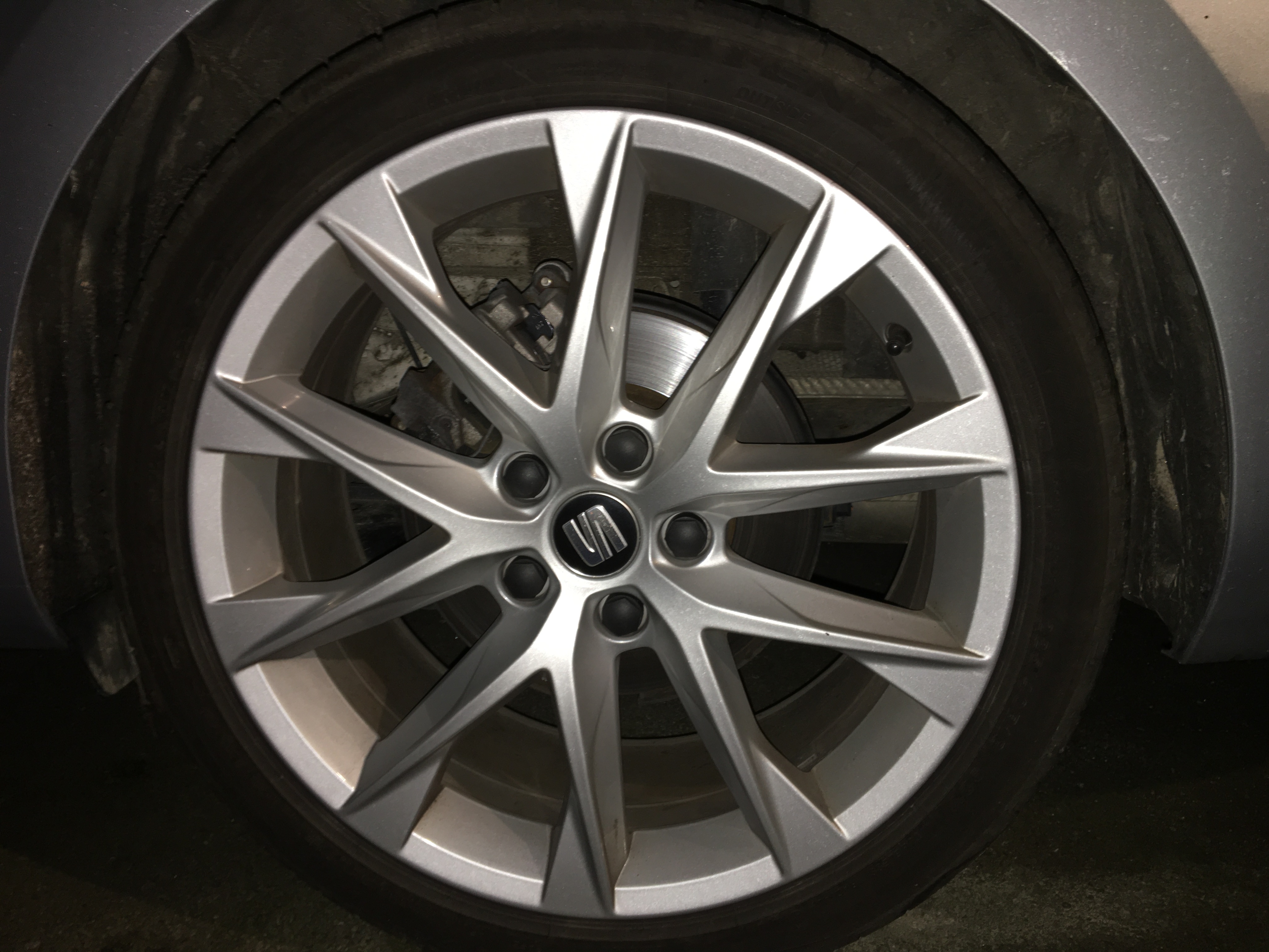

If your rear brake calipers are inline horizontally with the centre of the wheel then you have independent rear suspension,
if they are at an angle of about 45' to the wheel centre then it's torsion beam.

Or follow information above about brake calipers. My mate has a mk6 golf and his calipers differ to mine so suggests he has independent rear suspension

Is that Leon specific or general observation?
Reactions: Walone
Torsion it is then.

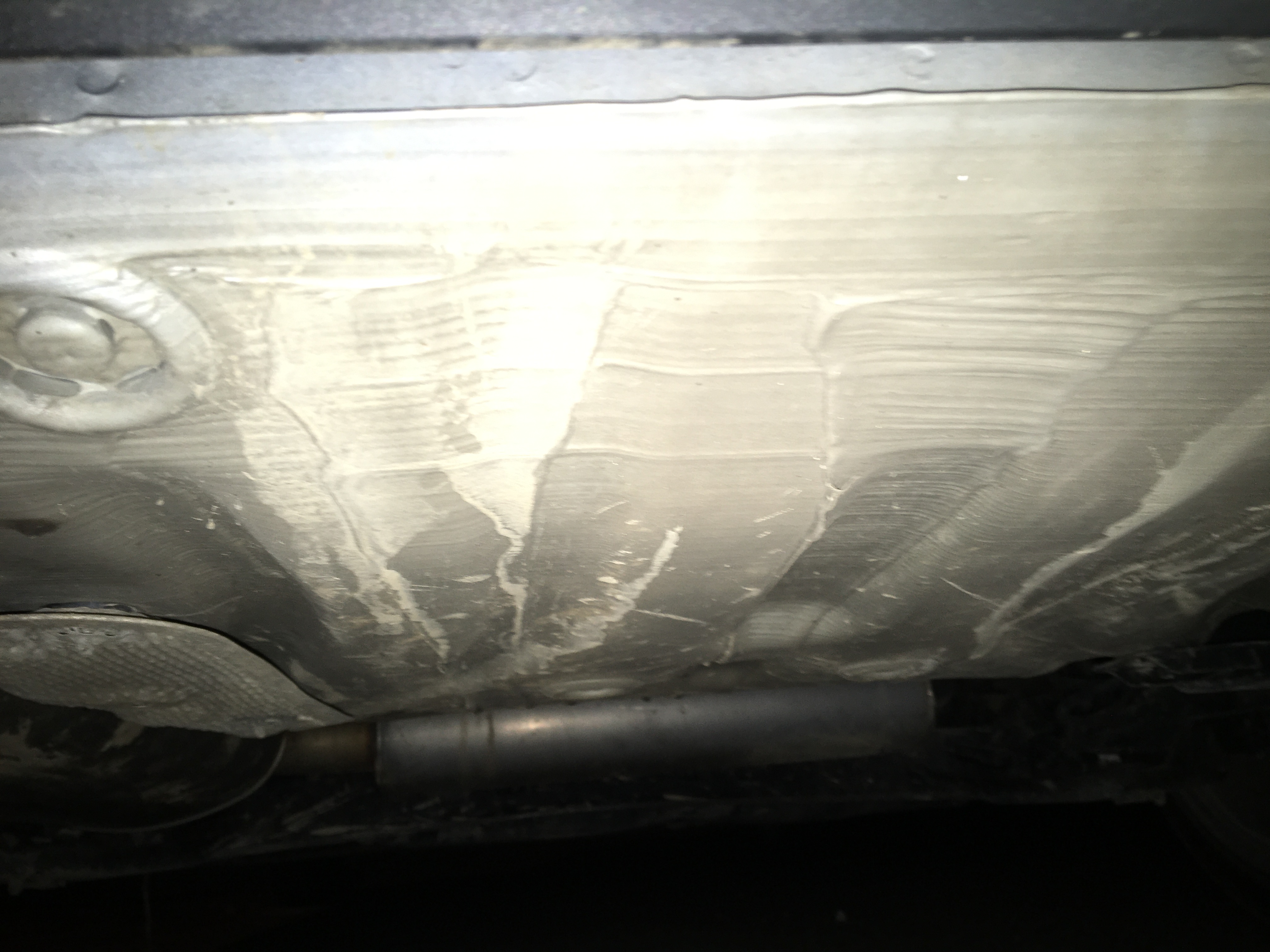

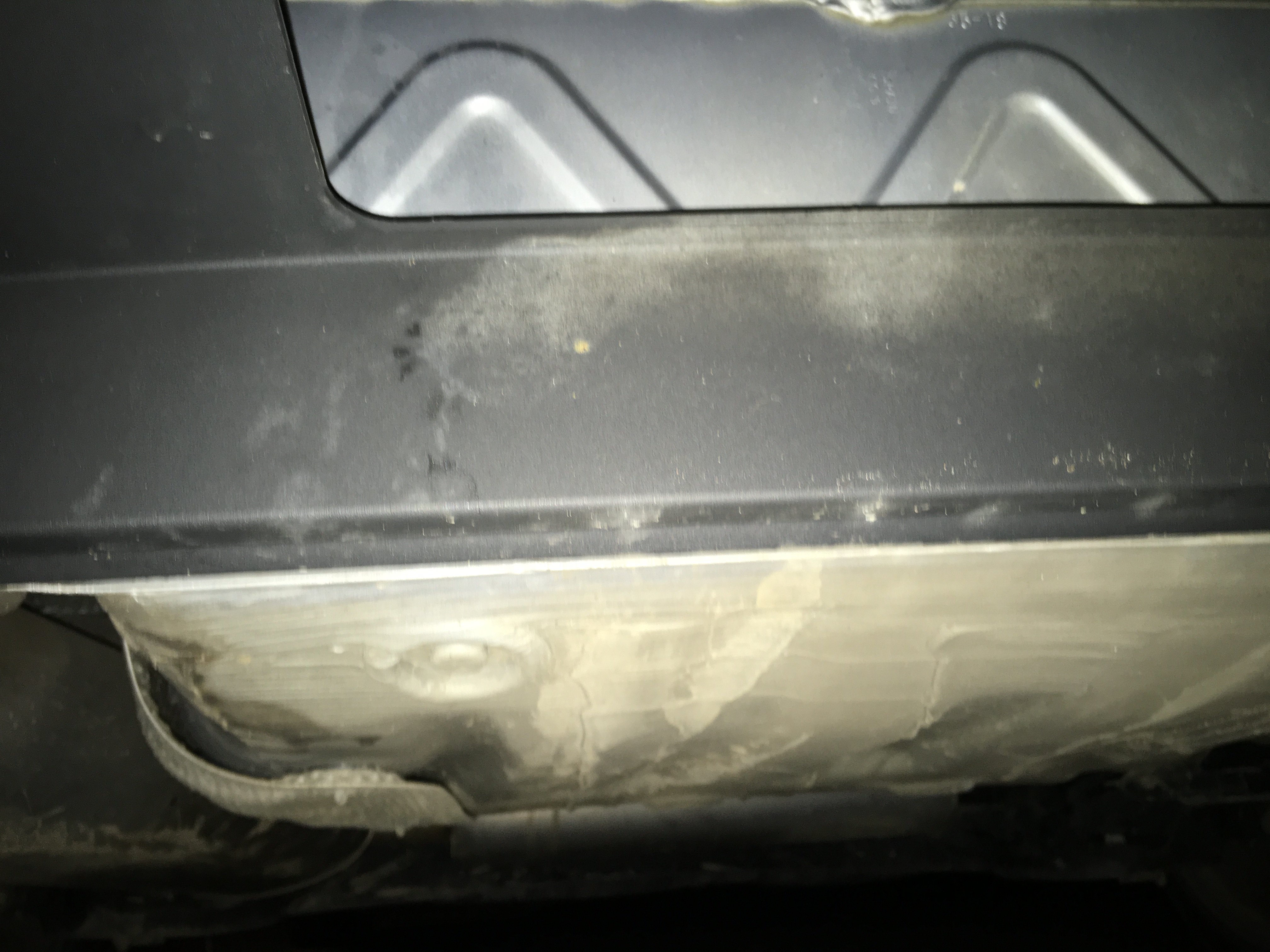

Couldn’t get a decent pic underneath this time of night but what’s the weird creamy colour stuff on bottom of boot floor? That normal?
