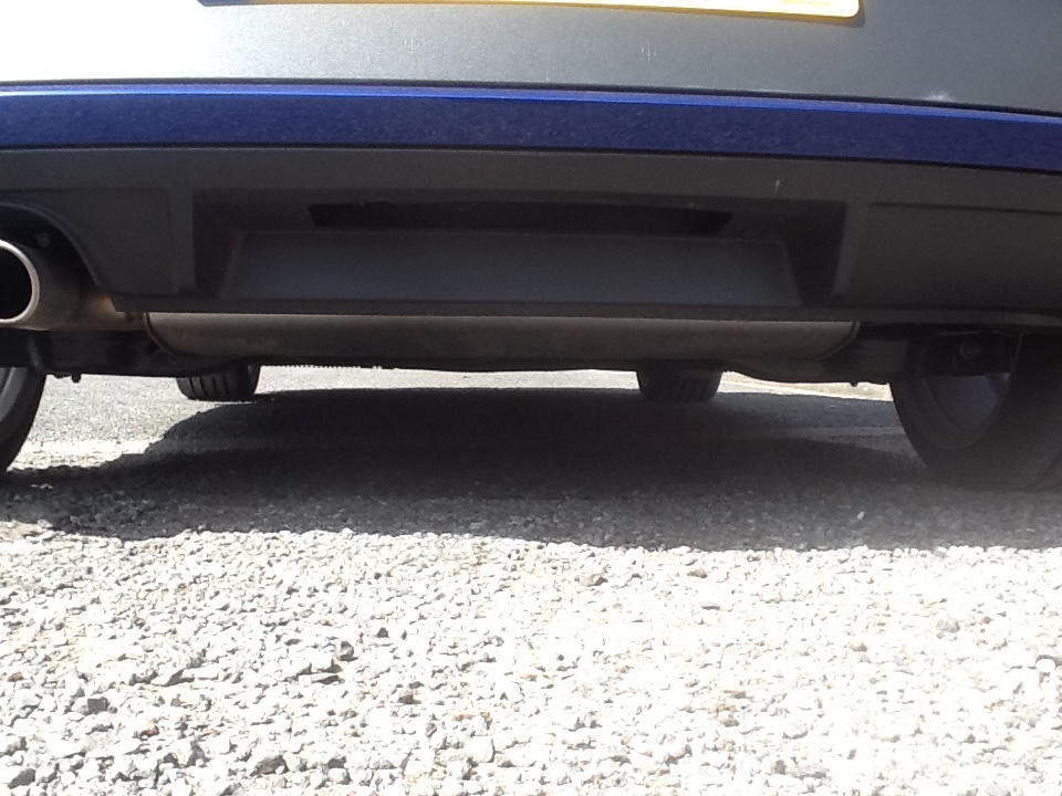

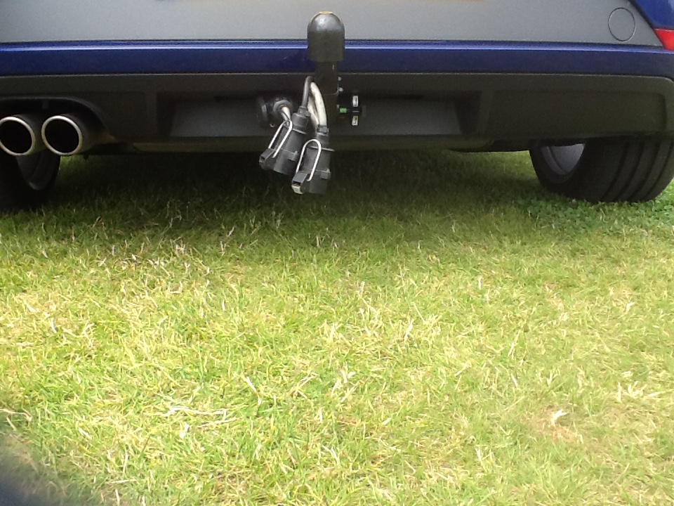

I have a Westfalia towbar fitted to my 5 door. It just has the standard 13 pin electrics fitted.( not dedicated ). It works fine. I just have to remember to press button to switch off the parking sensors and reverse slowly when I am coupled up to stop the brakes on car coming on. Towbar was fitted by Hedley tow bars in Durham. Pics of coupled and uncoupled.
Looks like a very neat install. The brakes coming on when trying to reverse, is that an inbuilt Seat thing to stop you reversing into stuff? As in, if I got really close to something normally (without anything on tow) it would put the brakes on?
