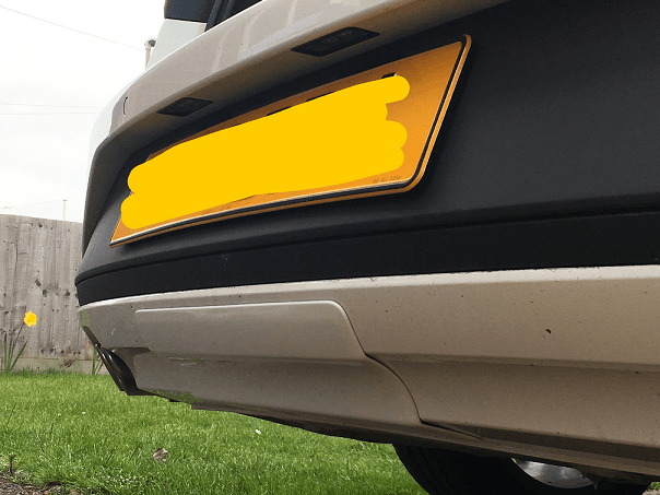

And underneath from our car: -
I'm assuming this hole is there to accommodate a factory towbar - however, has anyone fitted an aftermarket removable swan neck to a facelift FR hatchback, with this cutout, and know whether it needs any additional cutting or whether it goes in unmodified?

Hi, its unclear if you have the pre or post version, but if it is the post as you say it should fit without any additional cutting
I have the ST and have the hole as mine is a 19 plate and it sits where the hole is and just sits just out of site and the electrics
just fold down so you can plug the electrics in
