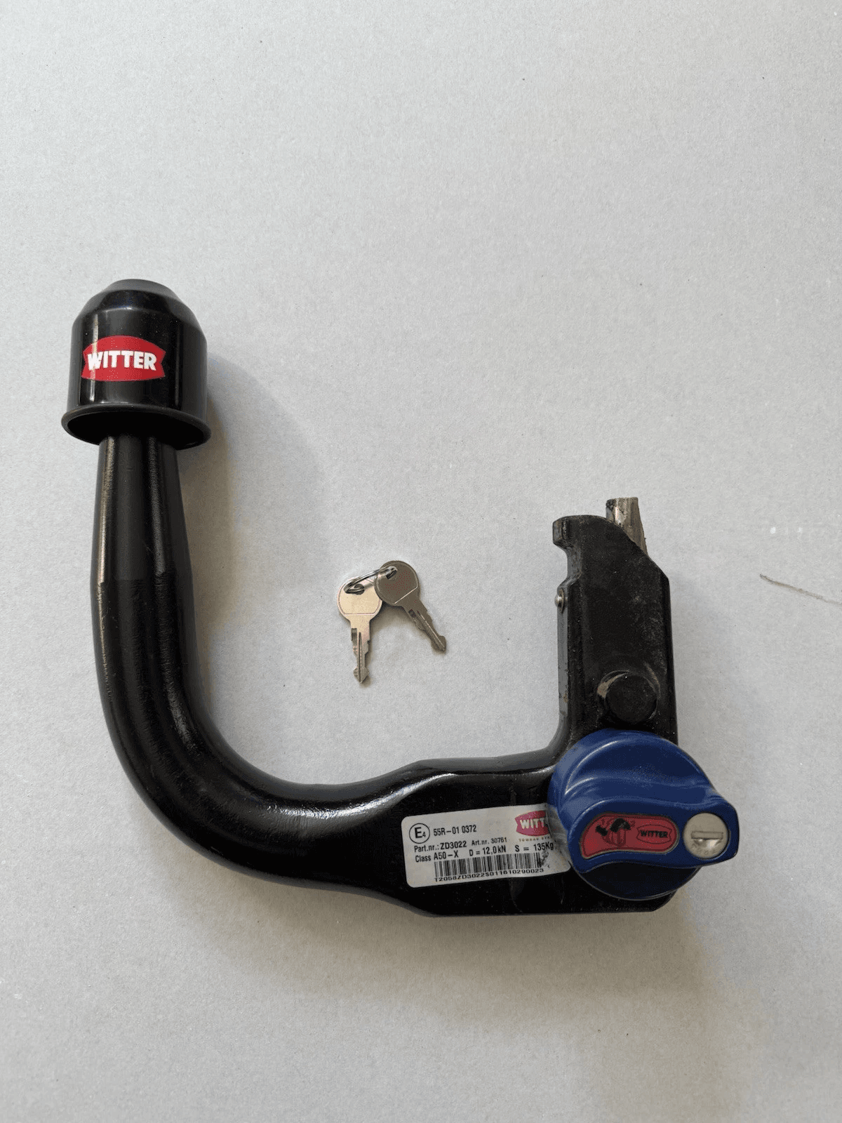

I have a Witter detcheable swan neck like this:
They did have to cut out a section of the bumper and that is visible but it doesn't bother me.
Total cost was about £550.
I have used a MTB carrier with 2 bikes and also towed an army style trailer with a 500kg hay bale and never had an issue. They do recommend that you remove a detacheable when not in use as they can seize up if left on semi-permanently. Mine only gets put on for use and then removed straight after. I would absolutely recommend spending the money on a proper fitted one and not spliced or other cheaper option. I also had to declare it on my car insurance!
