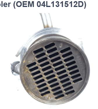

Regarding egr cooler.
04L131512D
was replaced circa 2016 by
04L131512BQ
Which went from rectangle holes - to round. These egr coolers are subject to large thermal stresses - and would think the round version copes with this better? Personally I would only change this if it was leaking.

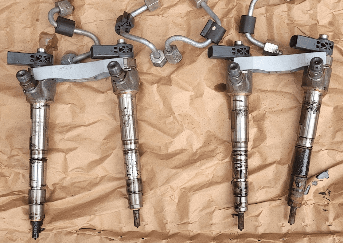

Would be interesting to see photos of your old injectors as well?
These are mine - when I changed my cylinder head cover a couple weeks ago:
Right one a bit rusty - and the tip on the left one a bit black and sludgy! I had to disturb the right one when I changed my diaphragm last year - might explain its rust.
I'm planning on getting their spray's tested, though my idle injector deviation is fine.

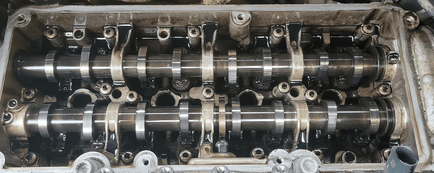

These are my cams - look perfect at 160,000 miles!
I'm closely monitoring my oil consumption, it does use a 'little' but much less than VW's official 'allowance' i'm keen to see if this new cylinder head cover reduces my oil consumption.
