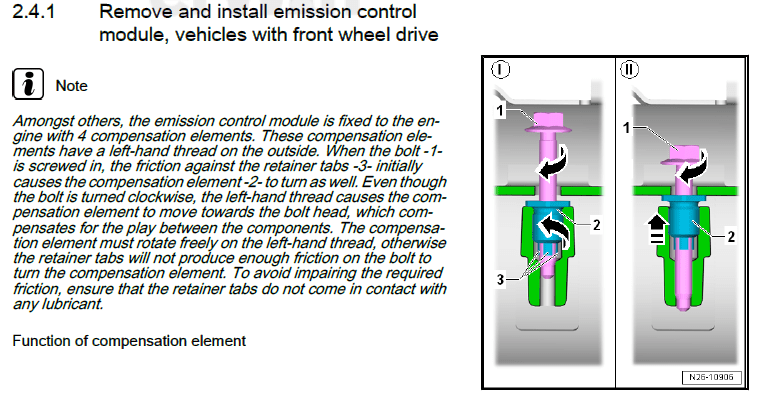

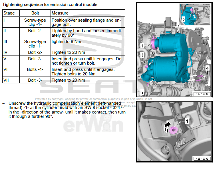

The DPF has a weird mounting system - 4x compensation elements.
Were these adjusted correctly?
You are supposed to connect the flange clamp to the Turbo first - then fit the mounting bolts by hand, in quite a complicated tightening sequence.

Thanks for that. I'm pretty sure that is what they are doing. The DPF is literally catching on the bodywork and they say they'd have to put a big dent in the DPF to fit. I guess we'll see how the really expensive genuine one gets on when it arrives.
