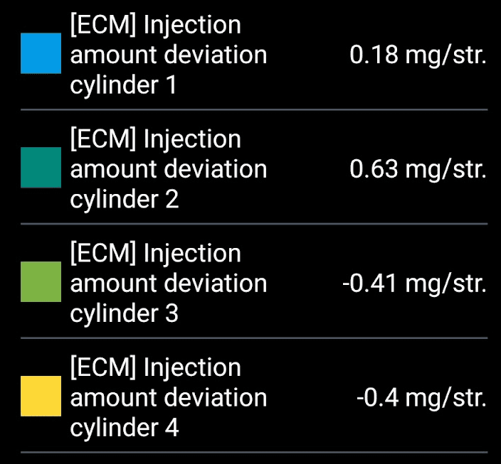

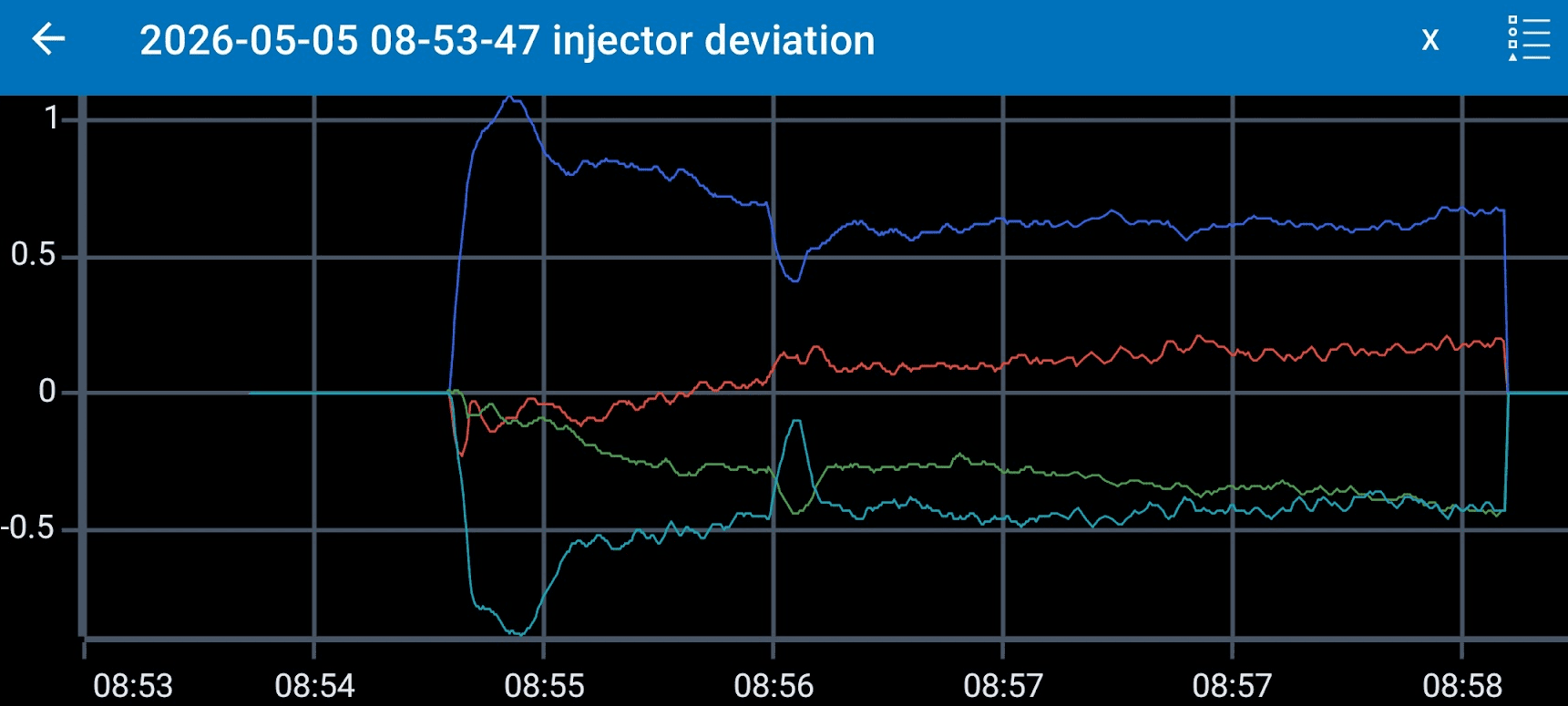

Thanks for the updated.
Would be great to know your idle DPF pressure?
FYI This is my (hot) injector idle deviation settles to around +-0.5

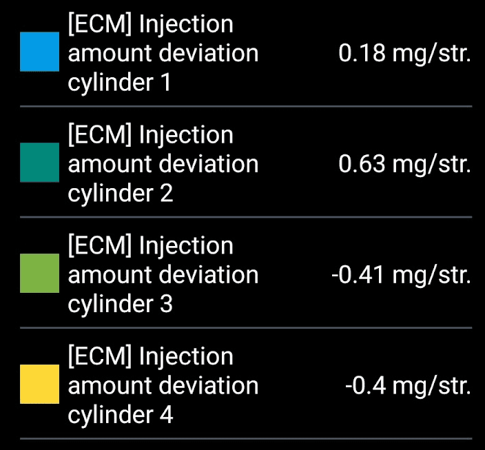

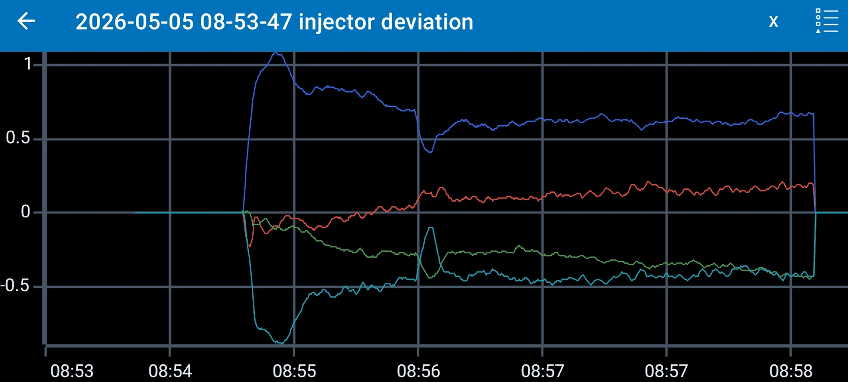

Your injectors look better behaved than mine.
