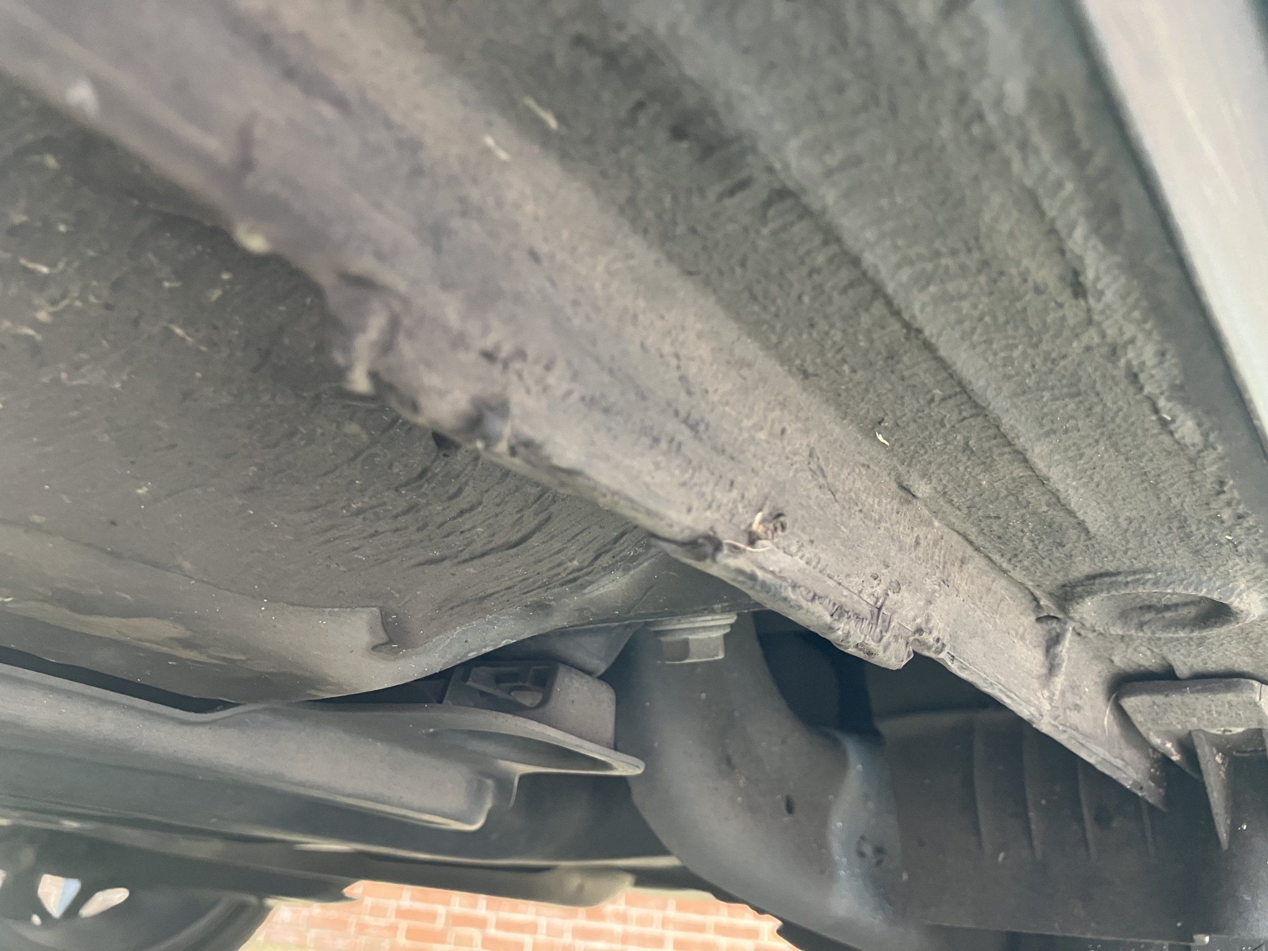

Numpty question. Where are the jacking points on my VZ3, manual is useless. Is it the ‘knifedge’ where one of the rubber blocks (above) sits?

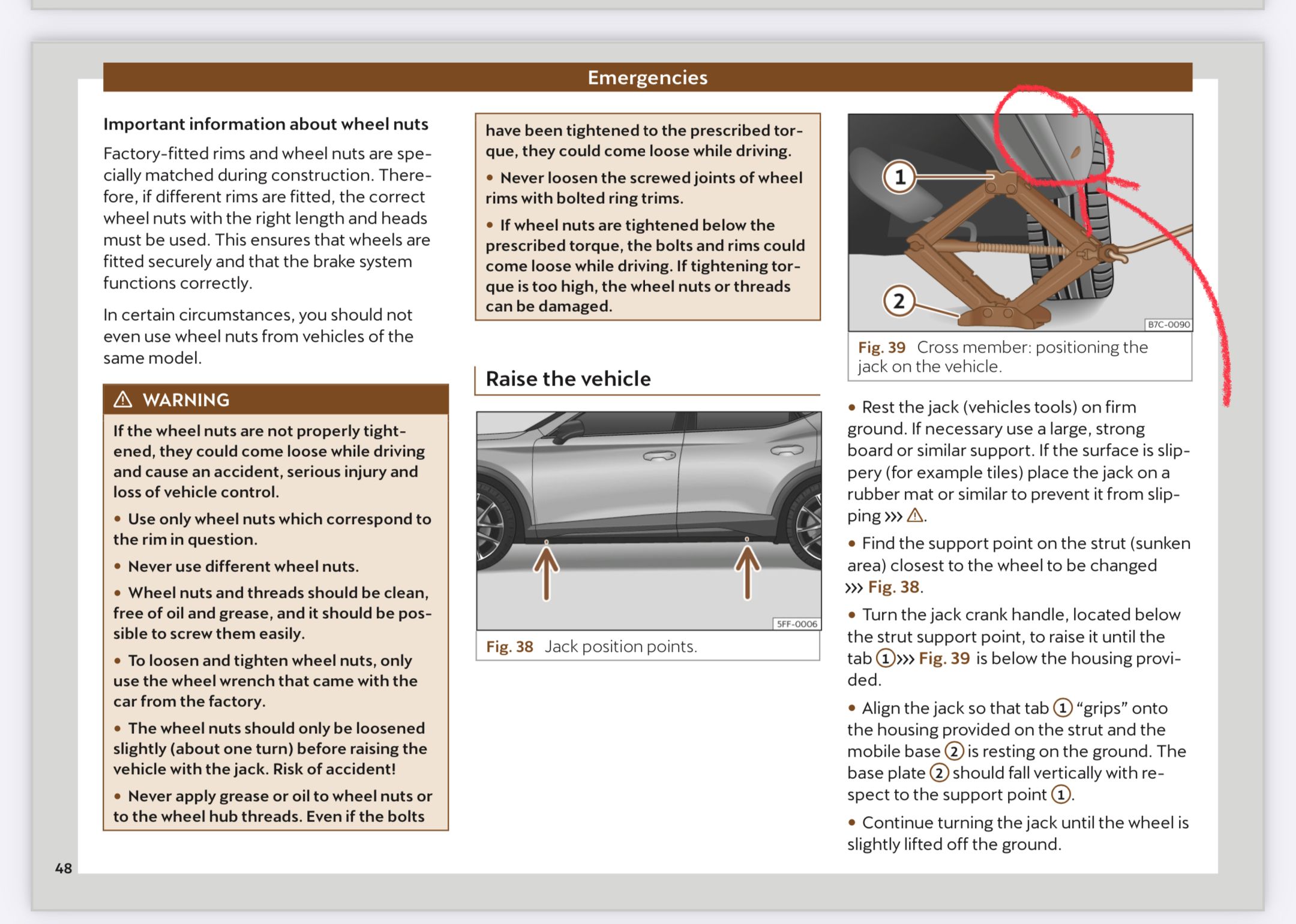

There should be two indented areas on each sill (one indent behind the front wheel and one in front of the rear wheel) immediately above the jacking points - arrowed in figure 38 on the screenshot below from the owner’s manual. The owner’s manual bizarrely refers to the sill as a strut - maybe that’s what the sill is known as in Spanish and perhaps the English version of the manual is a literal translation of the Spanish version?
The indent in the sill above the jacking point is more clearly shown in figure 39 (I’ve arrowed and circled it)
