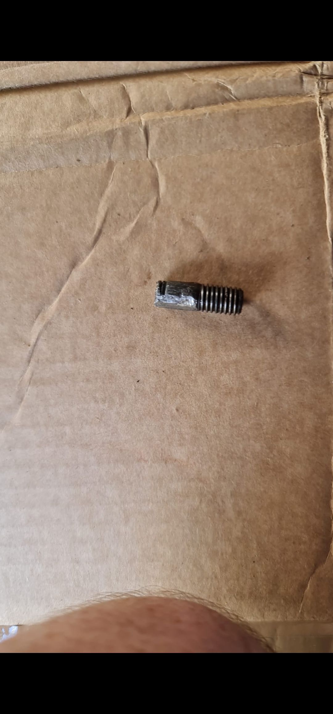

Well it came out. Soaked in WD-40 overnight, and twisted out with vice grips. Going to pick up a new stud from VW and hope it doesn't happen again.
