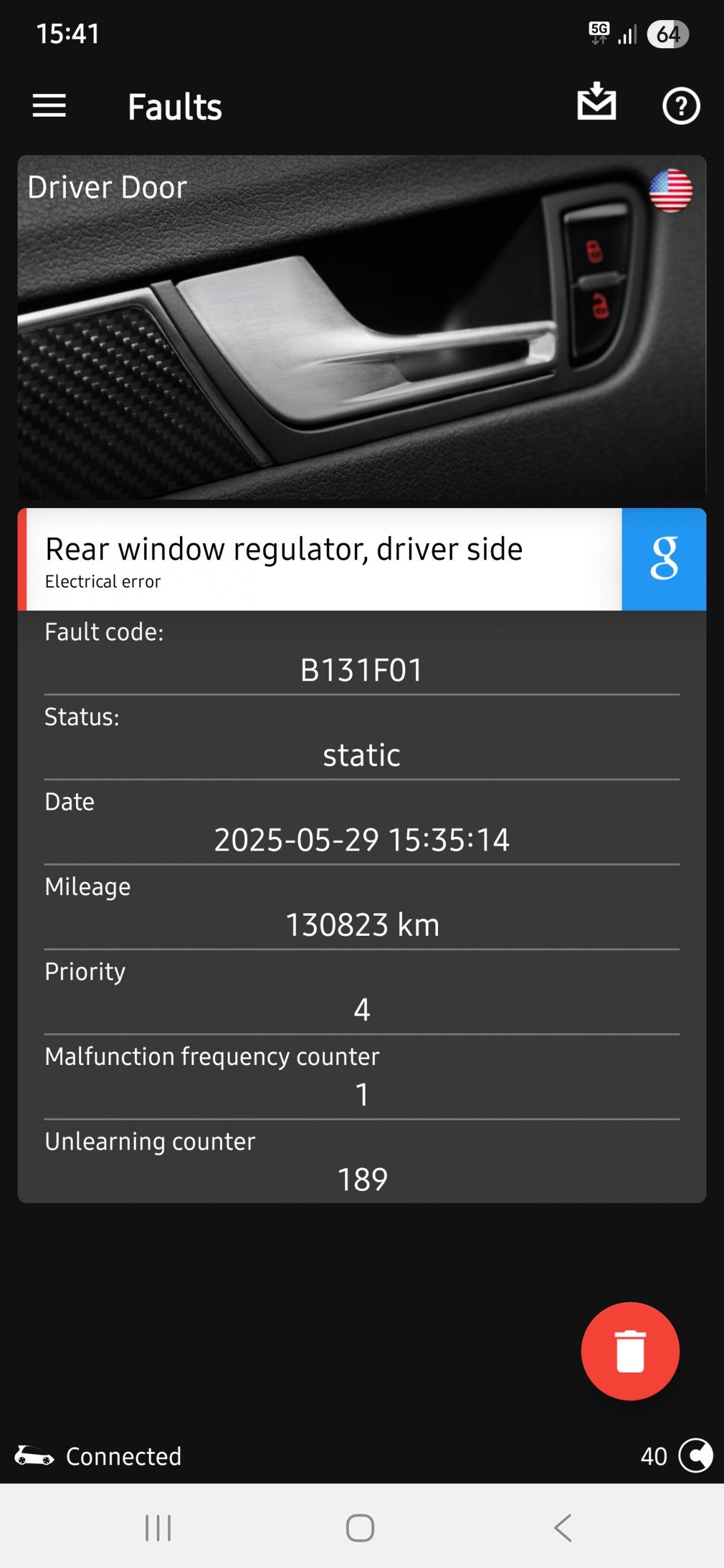

Hi mate mine did this and when I connected my obd connector and did a scan there was a fault code to do with the windows. I cleared this code and was able to set the windows up again. Code never came back at all think it was due to the cold weather at the time. I use carista and the free car scanner app to do this. It's brilliant mate highly recommended
Right okay - will have to Invest in OBD

The error log with the error "basic setting missing" is completely irrelevant for programming the window. I recently had 10 errors in the door control unit and was able to program it.
How do you learn the window?

Hi mate was only saying it worked for me. I have reprogrammed the window many times but on this occasion it wouldn't do it until I cleared the fault and I was instantly able to re learn the window mate
