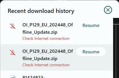

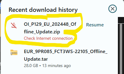

I wanted to use the newer maps you suggested by each attempt to download them, I keep getting cut off:

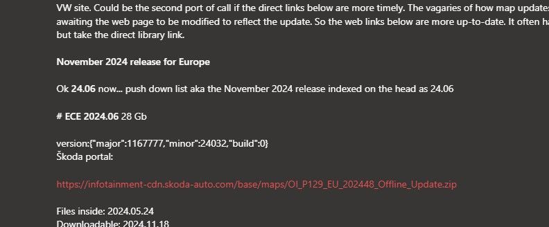

They have problems with the server at the minute. I say it's like hot cakes on map updates, get them whilst you can. Looking at the Briskoda site it had come up before and got corrected. Skoda server issue.
This one is the VW link 6 months before:
I will check whether VW has bettered this in the meantime. No... That's still the latest VW one on offer. The Skoda one might come back in the meantime. A dead server may be. I'll edit the YY.MM for that one in later.

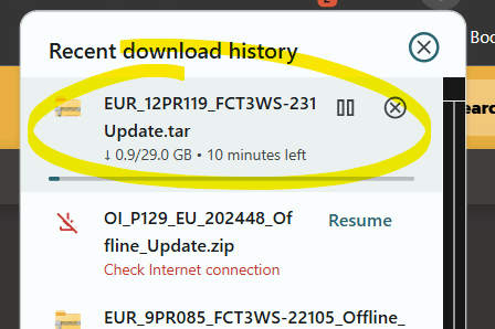

oh wow thats working thank you:
nice yeh itll be good to do the one thing once. cheers mate. just hopefully it didnt do much or start anything on my last attempt with the older Seat files but I didnt really see any indication of a update starting. I should have got a USB key or external SSD drive that flashes when data is moving, unless an update in progress bar should have showed up if its working?
Tell
Full Member
Yes you unzip with 7zip the built file explorer misses out a file that will give you 23.12 if you install it. It either works or doesn't work in the car it won't leave you with empty maps. That's the most recent file that VW has on their system for download.

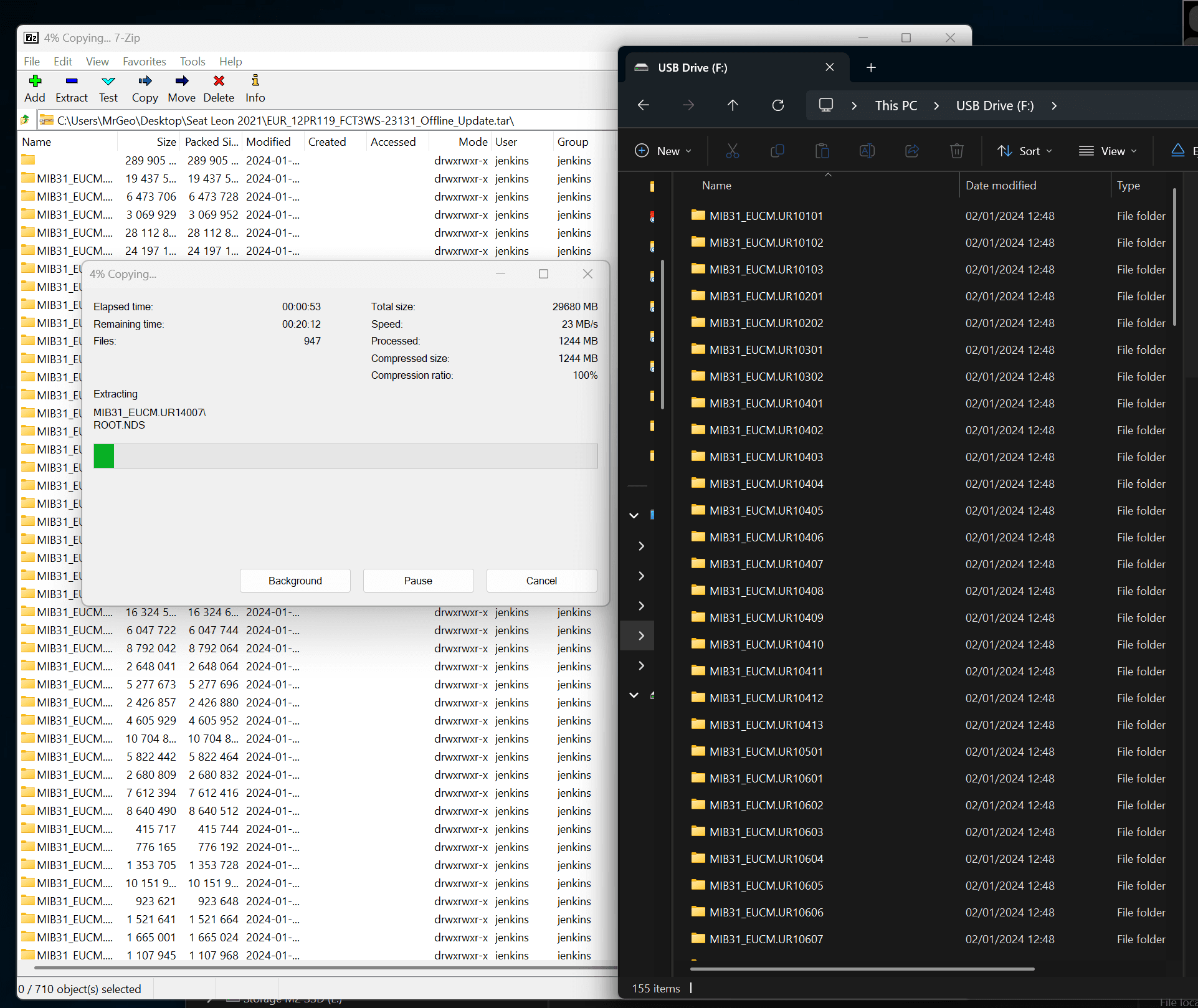

Hey Tell thanks for the updates and further information, i sadly just got back from the day job but will refer to your screen shot to make sure its primed for my attempt tomorrow mate. I do have new questions after my night drive back ahahha but will search for relevant thread for it.
extracting now to a exFAT formated drive as noted in the Seat PDF
failing that will try NTFS but will have to wait till tomorrow.
