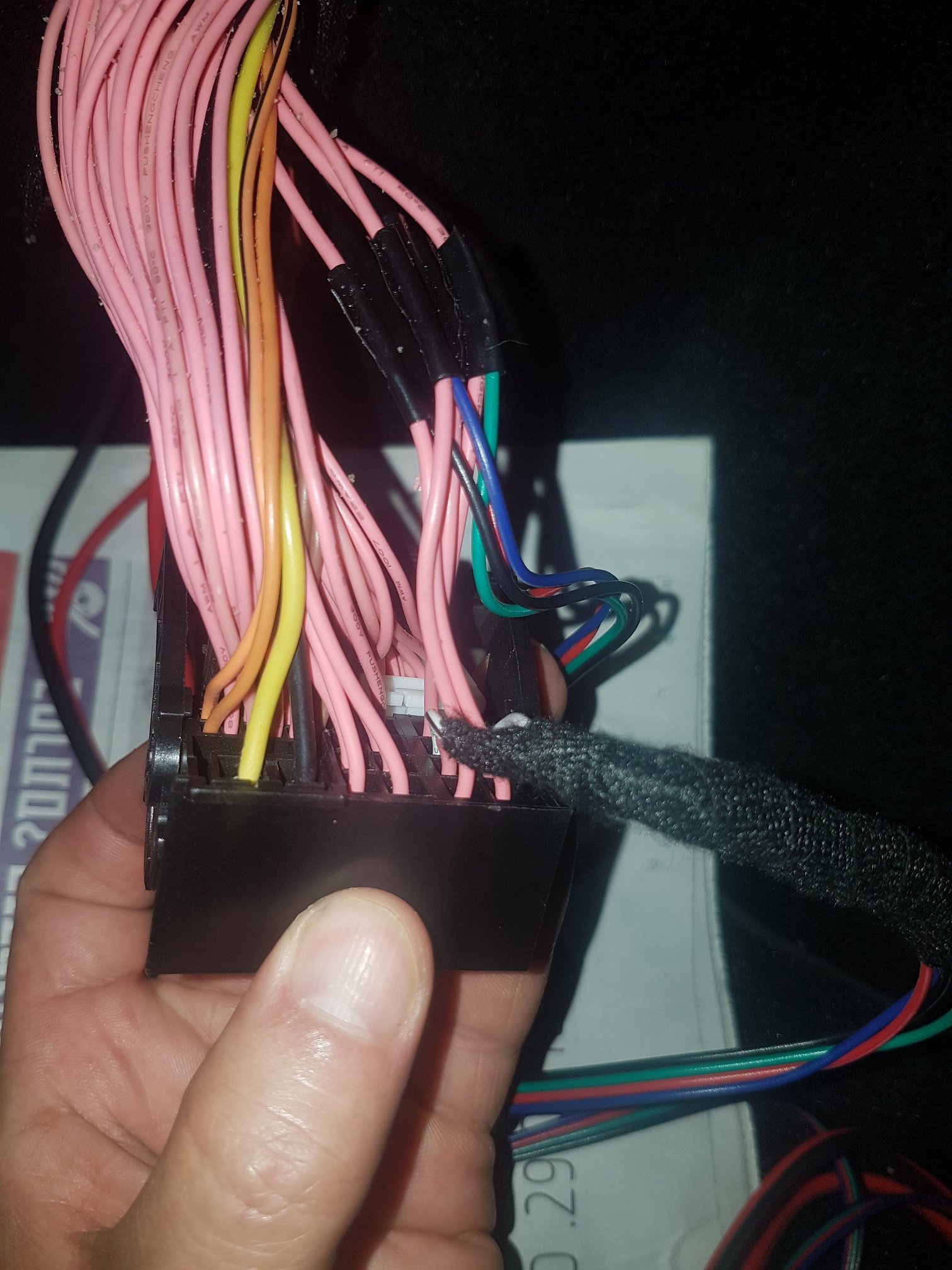

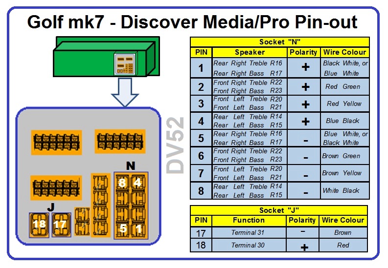

Hi Everyone,
The car is cupra 2016 1.8TSI
I am in the middle of installing new front speakers and the only information that I found was the MK7 pin-out table, which was good for the rear speakers but not for the front.
Pin 1,5,4 & 8 are for the rear speakers (as you can see in the MK7 layout) but,
Pin 2,6,3 & 7 was supposed to be for the front 2-way system(mid-bass & tweeter) but apparently they are for the tweeters only and now I need to find out where are the cables for the front mid-bass speakers...
My guess is that pin-out 9 to 12 will be for the front speakers but I don't know yet.
Anyone know/?

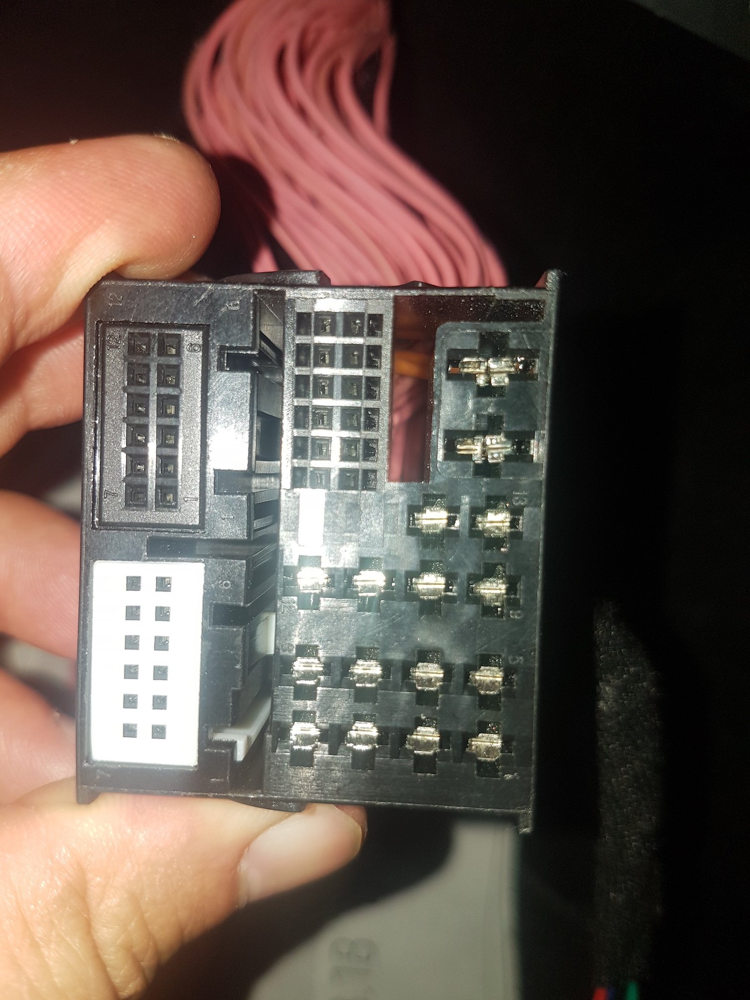

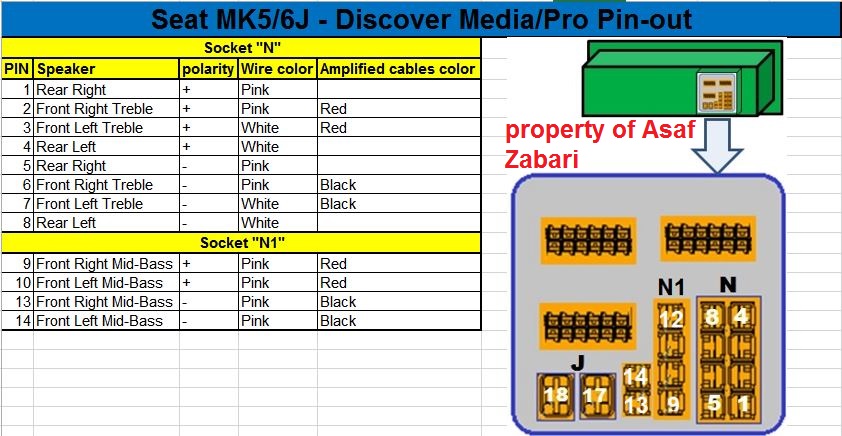

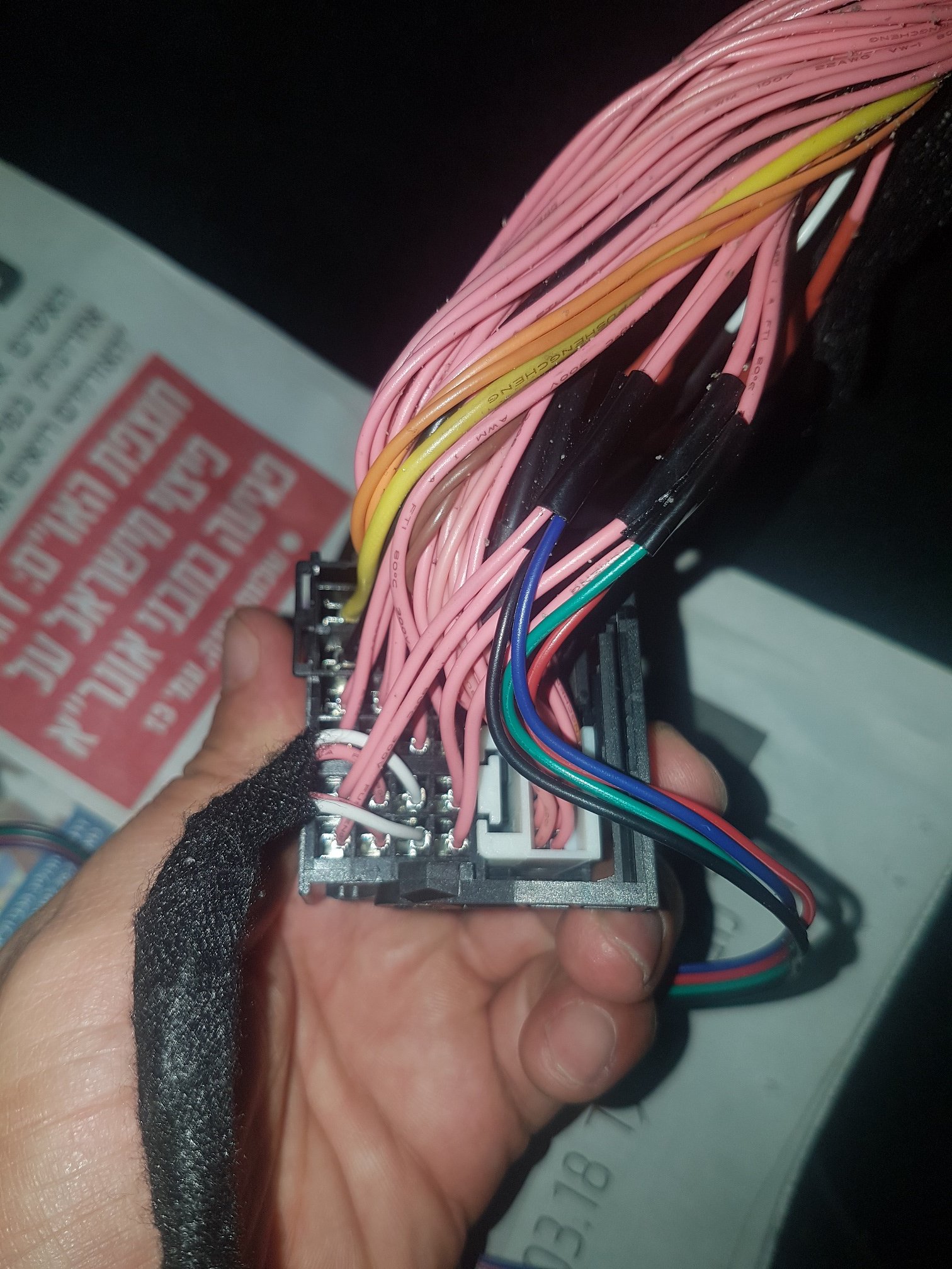

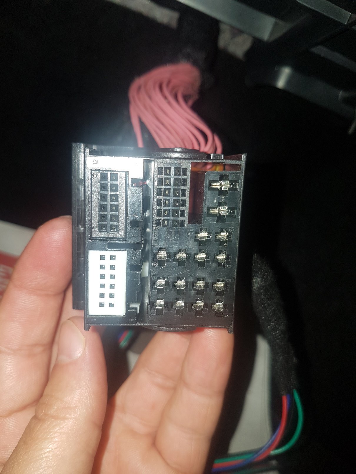

Hi Mate,
thanks but I managed to figure it by my own, for some freaking unknown reason my HU plug is different then you all(even my friend which has the same car,same year has your HU plug).
Mine was different see pics.
So I finally solved it and created new table for anyone else.
Hope it will help.
