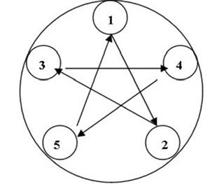

Some VAG cars can be susceptible to vibration if the wheel bolts aren’t tightened in a star sequence - like in the picture below. Some tyre places might not do this, and they might also over-tighten the wheel bolts with an air gun rather than using a torque wrench set to the Cupra’s specified torque setting.
The bolts should initially be tightened finger tight when the wheel is still raised off the ground, then tightened a little more (but not fully torqued to the correct setting) with a socket wrench. Then lower the car to the ground and tighten to Cupra’s specified torque setting. All bolt tightening stages should be carried out in the star sequence as per the above diagram to minimise the risk of vibration.
I install wheels exactly as you've described. I do it myself. Still vibrates ;)
