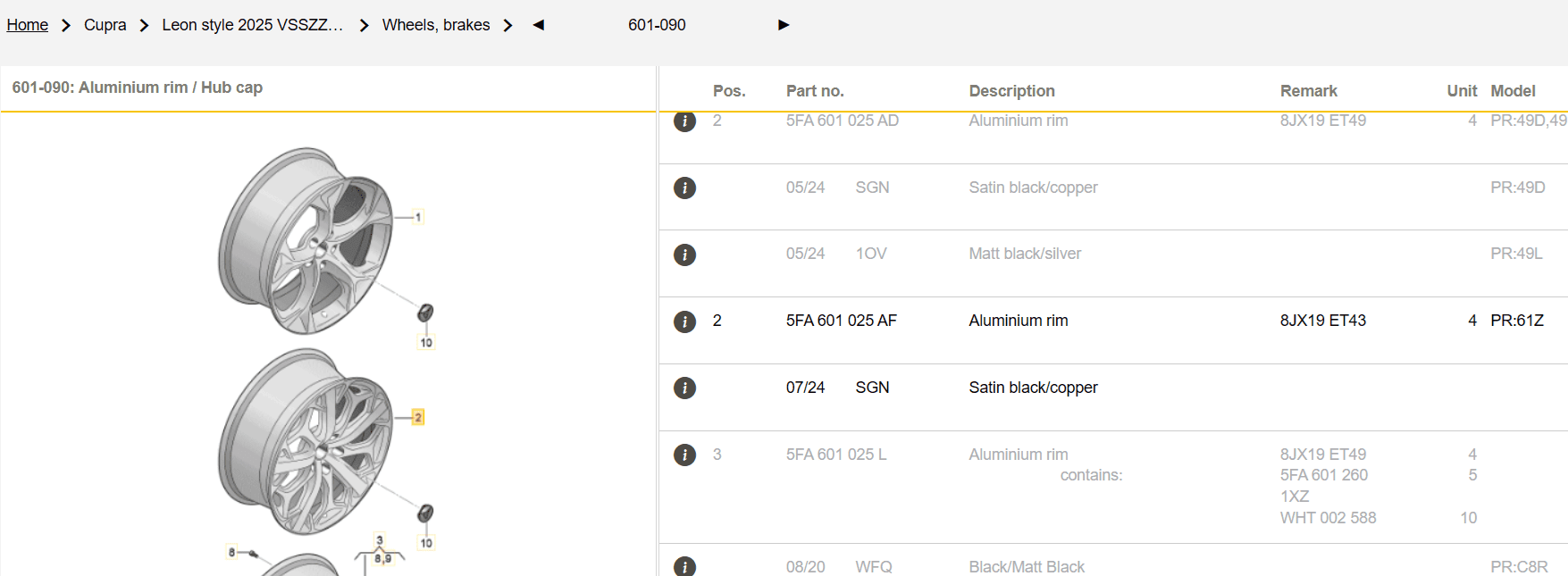

Several actual Cupra configuration pages refer to this wheel as "19" Hailstorm Copper/Black Forged Machined".
So I looked it up in parts catalog to find some more info about it but interestingly there is no item, in the sections related to 2025/2026 Leon 19" wheels or accessories, matching its design.
Only information I could find is on sites like ebay etc.
Looks like it is 8x19 ET43, PCD should be 5x112 like all other current VAG group wheels.
Also there is a part number as Z236359V3AFPS4, which looks nothing like any other VAG group part number.
Now I wonder what another lookup in parts catalog using your VIN would result, I could also check that if you send it to me via PM.

I believe the part number is 5FA601025AF (found from an advert where there was a genuine OEM used one for sale). Agree with @serdar_18fr - spec dimensions look to be width; 8J, offset; ET43 and PCD; 5 x 112.

The interesting thing is that there's no 19" wheel item, in related section of the parts catalog, matching this wheel design. But now you supplied a part number, I can look it up again using that number, probably later this evening. I'm also wondering what a search through VIN would show. It's a curious case! 🤔
First I looked up the part number and found the wheel, with the paint code at the end, so the exact part number is 5FA601025AFSGN.
But the illustration is incorrect, that's why I thought there was no item matching the actual design.
Probably SEAT forgot to include the correct illustration or just didn't care.
Then I looked up the VIN provided by @Loadmaster748 and verified that it *is* the wheel in his car.
Specs we already found are correct too: 8x19 ET43.

Many thanks Serdar - the PCD of 5x112 rings a bell, but I did assume that the rim width was 8.5 - probably a wrong assumption.
I will PM you.
