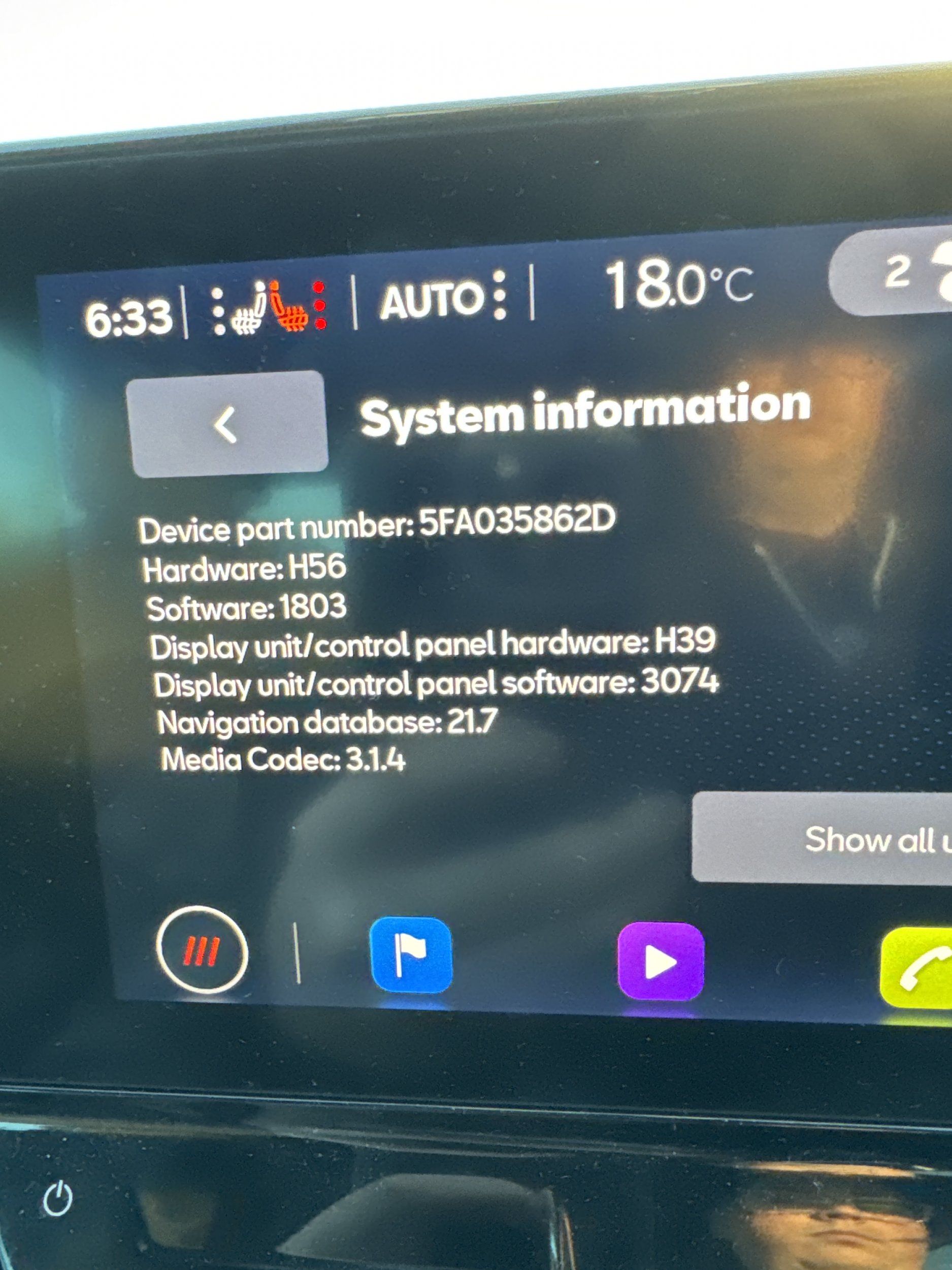

Correct, only Waze. Apple Maps is fine. I don't use Google Maps. Never have, never will! Haha. I will test, I don't think my car is on the latest version, could this be an issue?

Is it worth updating my software too?

Your infotainment software would probably benefit from the update, if only to make it more responsive.
On the Waze problem then remember that it is the phone doing 99% of the work, the screen is just a dumb display for it. I've got Android but most problems I've found were down to the phone, the app or Bluetooth itself.

You can, but they will charge for updating unless the update is related to a warranty fault - or wait until you have a service due and ask them to perform it during the service.
Alternatively you can obtain it as a download from the forum sponsor, East Yorkshire Retrofits. I did the update myself at home and it's very easy.
