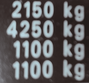

Hi,
Don't suppose any of you friendly Cupra Ateca owners could either take a photo of or let me know the details on the weight plate (usually in drivers door shut), i am very close to closing a deal on one but the dealership don't have a demonstrator so just need to check the overall train weight permitted which is on that plate.

Hope this helps

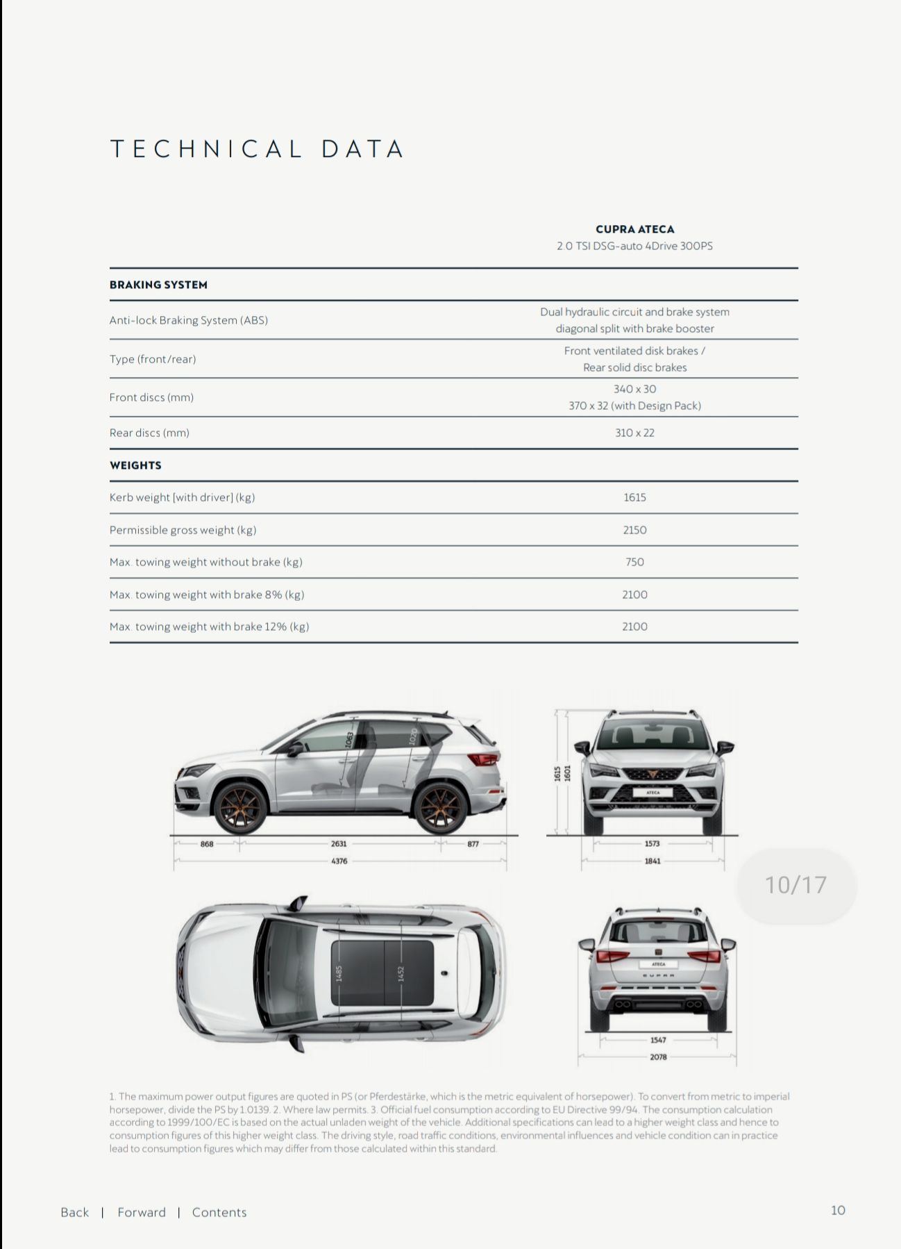

Hope this helps
Yeah i did find that on their site but it does not give the maximum train weight and this can often be a lot less than the maximum towing weight plus the maximum car weight but thank you
its that figure i am looking for.
