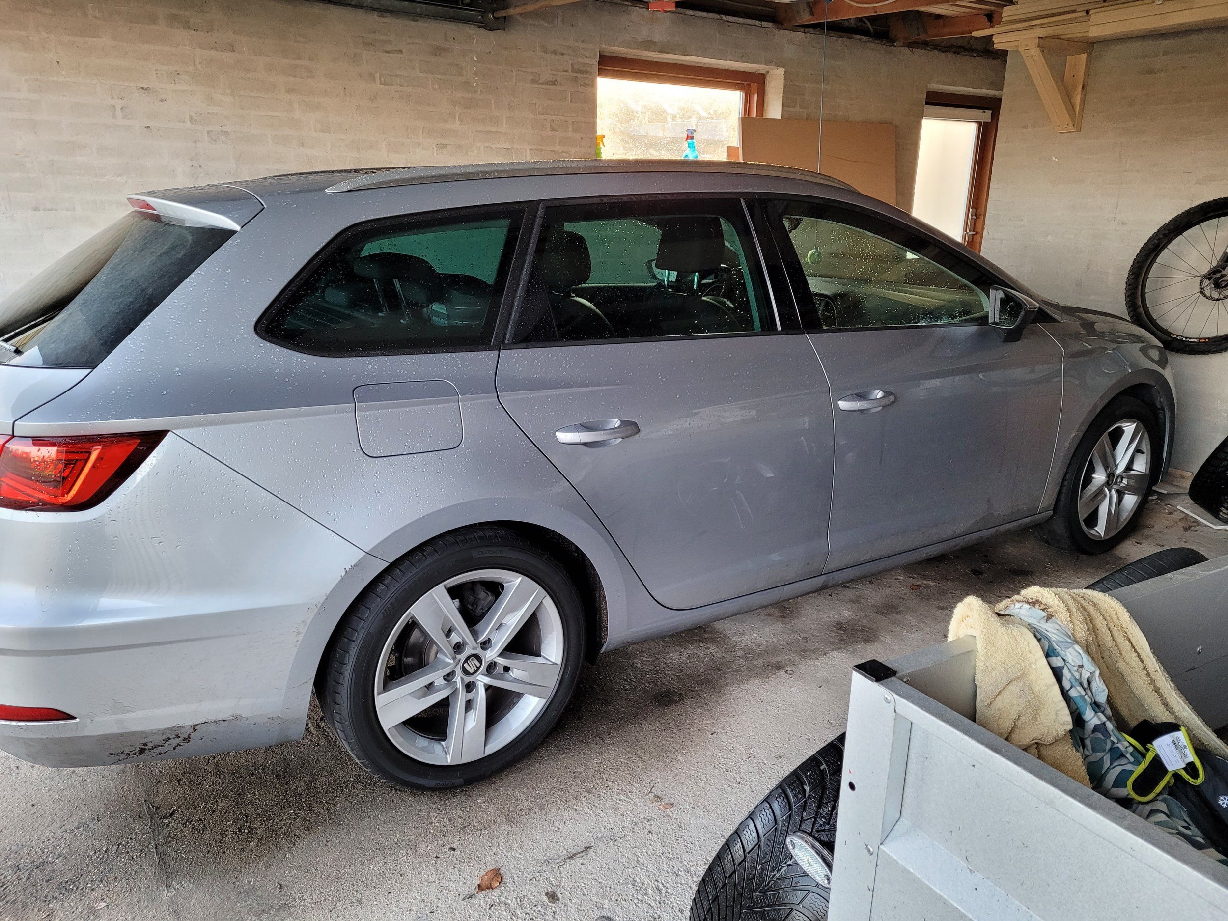

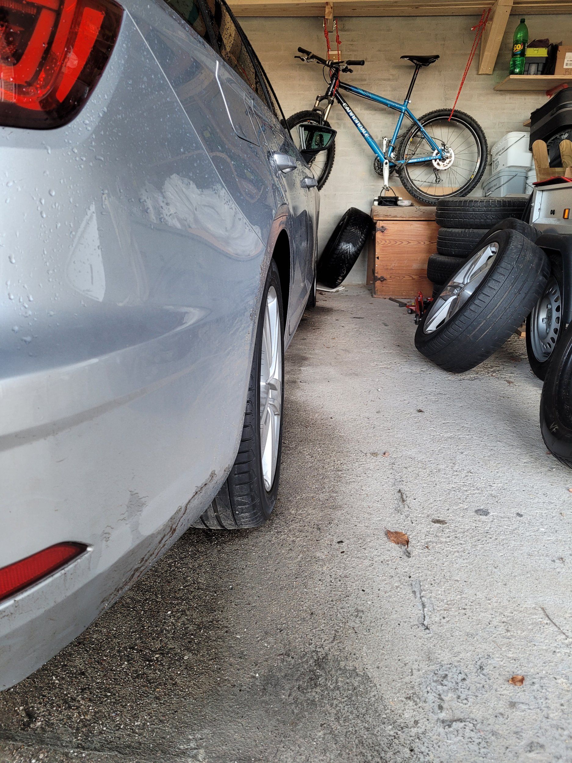

I apologise firstly for starting another wheel spacer thread as I realise there are a few doing the rounds. However, I really can't find the answers I'm looking for, so hoping you knowledgeable people can help me out.
I've tried measuring what size spacers would bring my original 17" alloys out to the edges of the arches to give the car a nicer look. By putting a straight edge directly down from the arch and measuring back to the top of the wheel, I get measurements of 25mm for the back and 20mm for the front.
Does this seem a bit excessive? I've read on numerous threads that 10-15mm seem to be about right, but of course, it depends on the car, year, alloys etc.
If 20 and 25mm sounds right, does anyone have a link where I can get them from?
Many thanks everyone!

If you bring it out flush to the arch then the tyre cannot travel into the wheel well anymore. The tyre will foul on the arch.
Buy a set of 20mm spacers first
Stick them on the rear. If it is okay after running for a bit try them on the front and get some 25mm for the rear
If too tight keep the 20's on the rear and get some 15mm ones for the front
Reactions: Damo H and ccarty85
