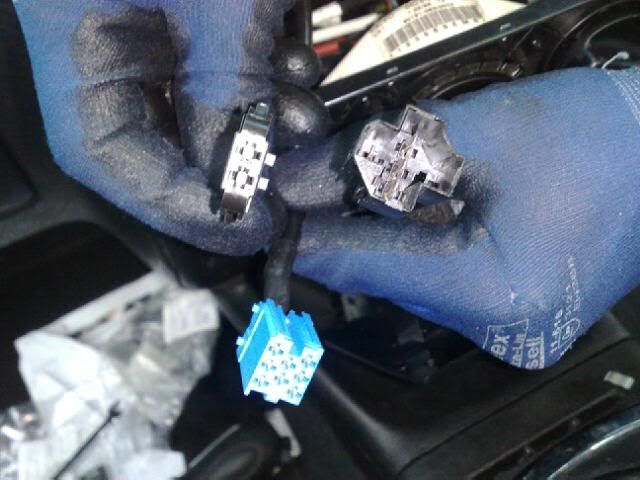

Mate has just sent me this picture asking where these plugs go, if anyone recognizes them?
Believe they're behind the dash as he was replacing a pedal box, thinks they may be airbag as the airbag light now won't go off.
Help appreciated
Dave
The airbag wires are much smaller. The light is often turned on when people put the car back together. I think it has to do with the battery, mine was flat when I changed my pedal box.
Not sure what those connectors are from. The top left one might be one for the steering column (into the stalks) but I don't recognise.

i think the small plug and the blue plug are the rear window heater switch and airbag light but im not sure as it looks like he is by the heater controls
Took the whole dash out, so I presume everything like that would be disconnected?
Think the only things not working are the fog light telltale, handbrake light and the fact the airbag light is on.. Or at least that's what's been discovered!
Have to just tell him to keep at it, I can't see that there'd be plugs not connected to anything at all, must have missed something!
the blue plug isnt connected in mine (1.9d base spec) but it floats behind the dash
Help appreciated
Dave
blue plug = cd changer
small black plug = speaker
silver plug = gauges
