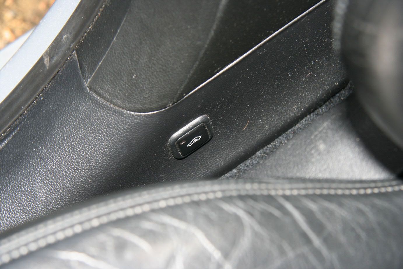

Compared to mine, you have the fuel flap switch in the place I've got the motion sensor switch.
I definitely think someone has relocated the switch from the central console.
Does your central console have a blanking plug where we have our second switches, or is it clean? If the latter then someone has also replaced the central console moulding with one from a non-TCS/ESP car with just the space for the fuel flap switch there, and put the TCS switch into that.
Never occurred to me anything was wrong, until iread a post yesterday about the fuel flap was on the centre console and bill saying the other day it should be there too.
I have a TC switch ( no cover) at the bottom and an ESP above it although the ESP does jack so it's there just to fill the hole.
Well that's not surprising. You don't get separate switches for TCS and ESP: you get one switch for whichever system you have. Your ESP switch is just filling up the hole where the fuel flap switch came from.
As you have a Leon Cupra you should have ESP. You could swap the top over to the operating switch so at least it has a cover and is labelled correctly, or swap the whole switch.
