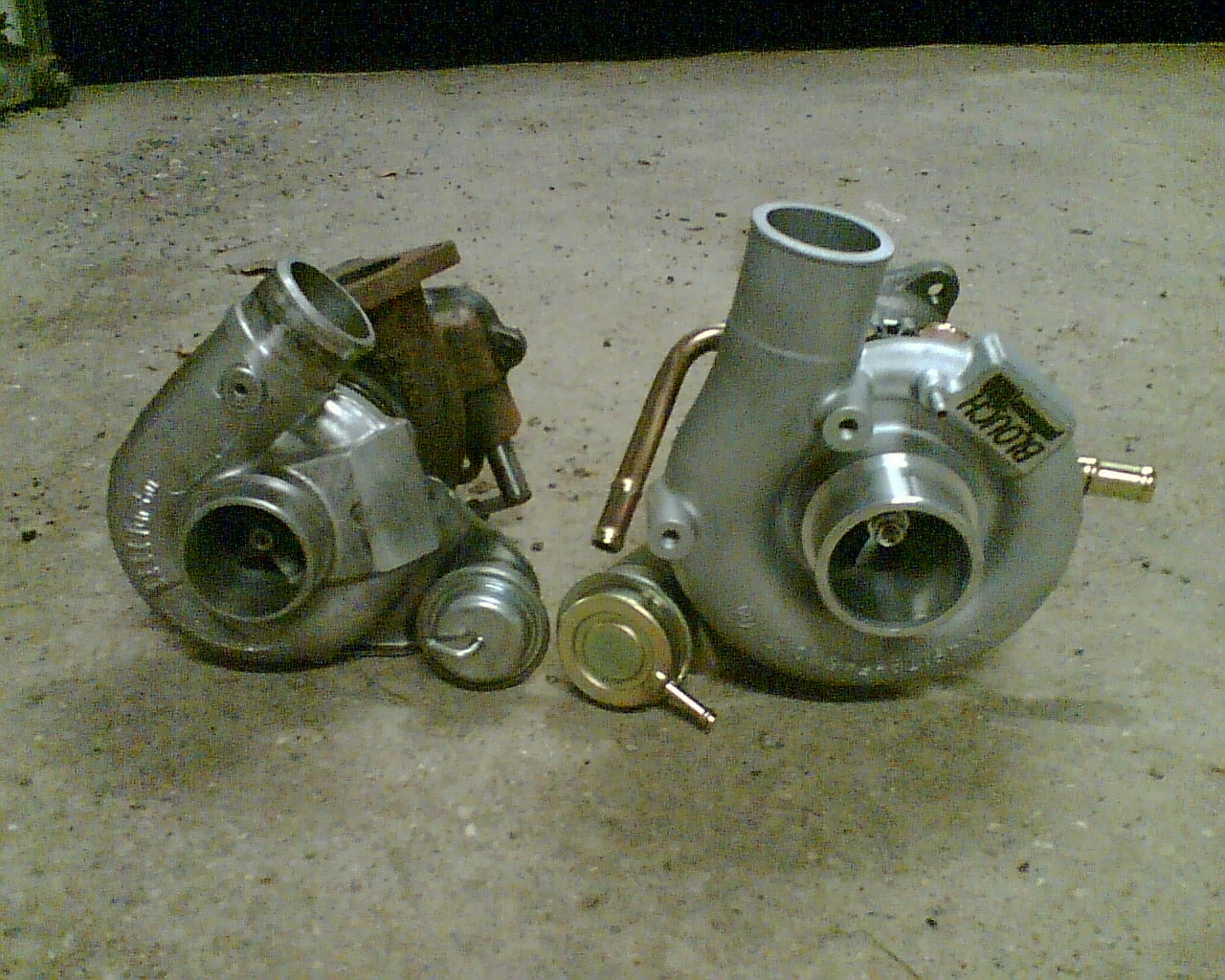

lol must agree! the difference between my old vf34 and my new tdo5/20g is this!

wow ,a full on tdo6 compressor housing bet that took some fitting!

Thats a td06 compressor housing bill,here is a picture of a evo 8 td05 compressor cover and a evo 9 td06 cover.
