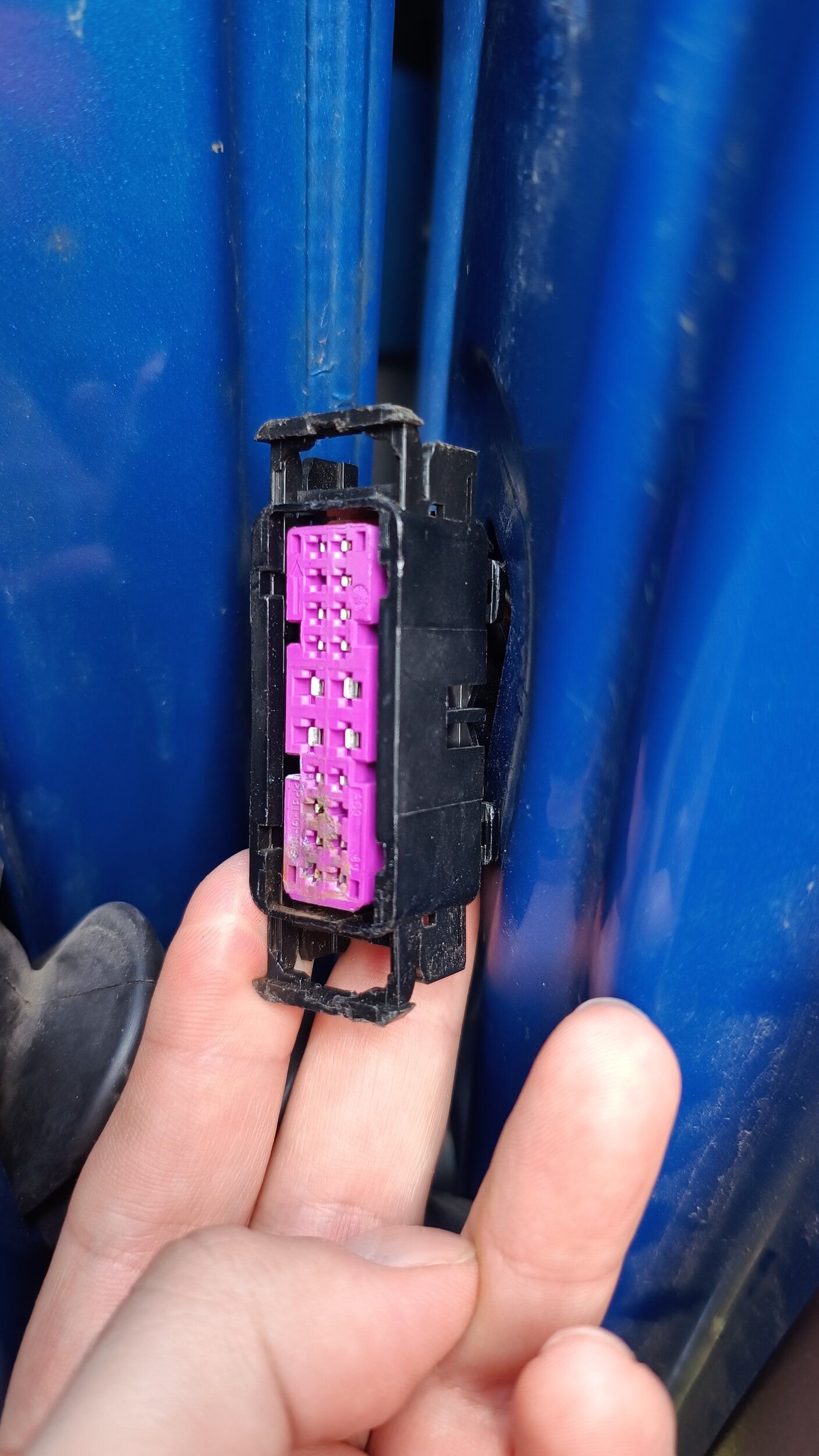

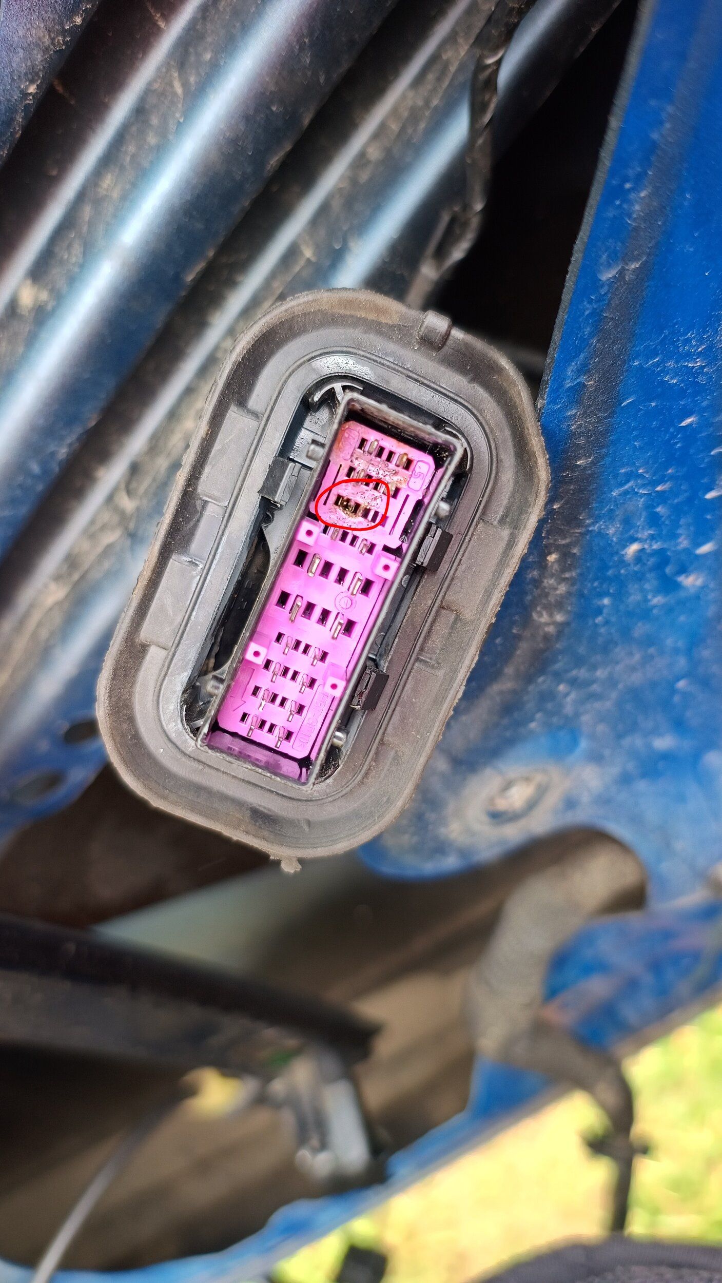

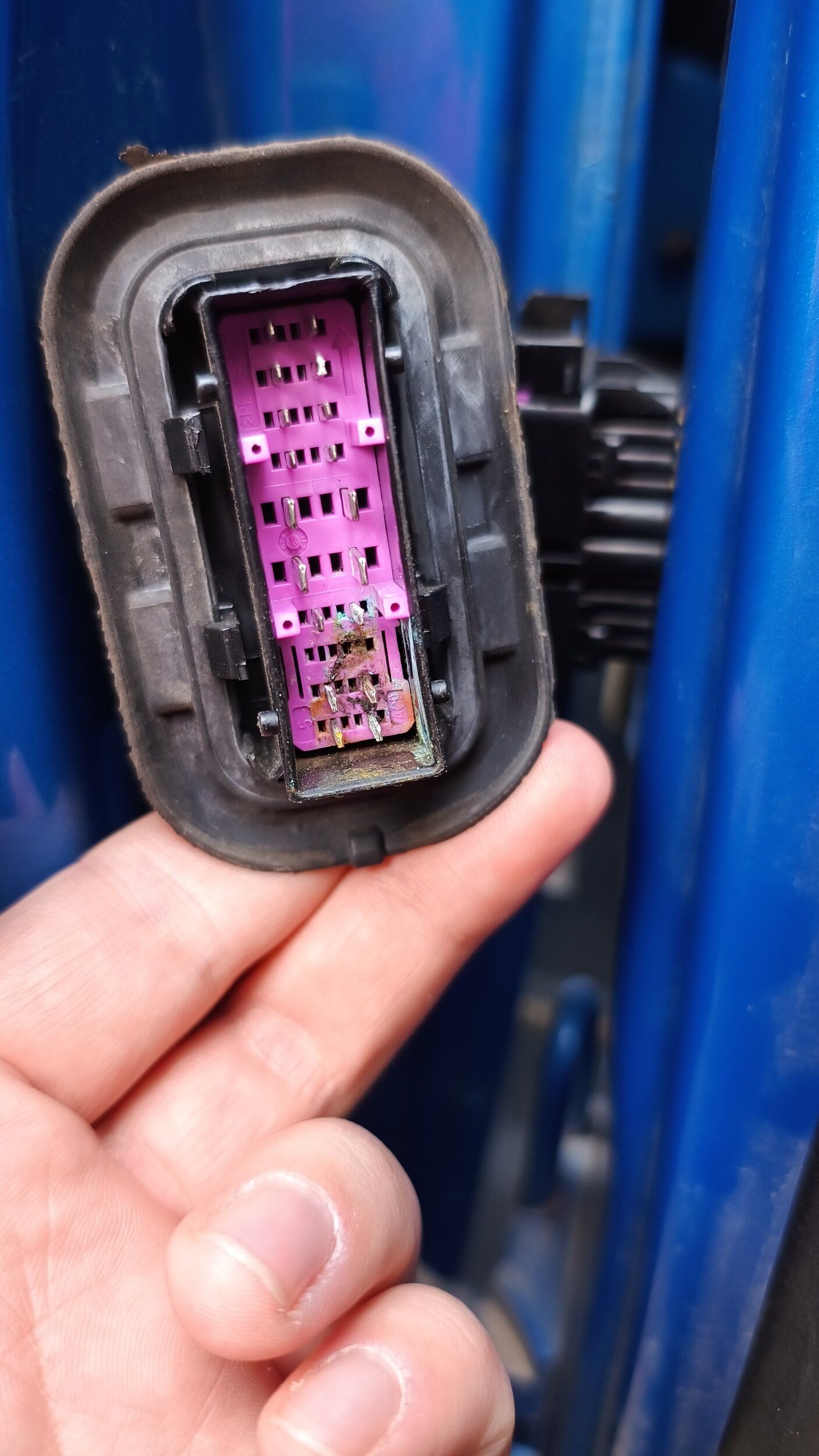

There seems to be some sort of heat damage besides the corrosion. Shouldn't there be a pin in the circled spot?

I'm not sure mate to be honest, quite possible. Heat damage can happen when the connection is so corroded that the resistance of the pin goes very high. High resistance = Lots of heat.
I would try cleaning it with a toothbrush and either isopropyl alcohol (IPA) or better still a good contact cleaner, plug it back in and see if you get lucky. If not then you will have to replace the connector, or do a 'cowboy repair' and bypass the connector.
I did a clean up with contact cleaner but no results. I'm pretty sure there should be a pin there since there's a corresponding metal connector on the female side.
This is beyond my skills and tools so I'll take it to someone in the near future. Will update with the outcome.
Reactions: mty12345
Yeah probably best mate. Should be easy enough for a auto electrician.
