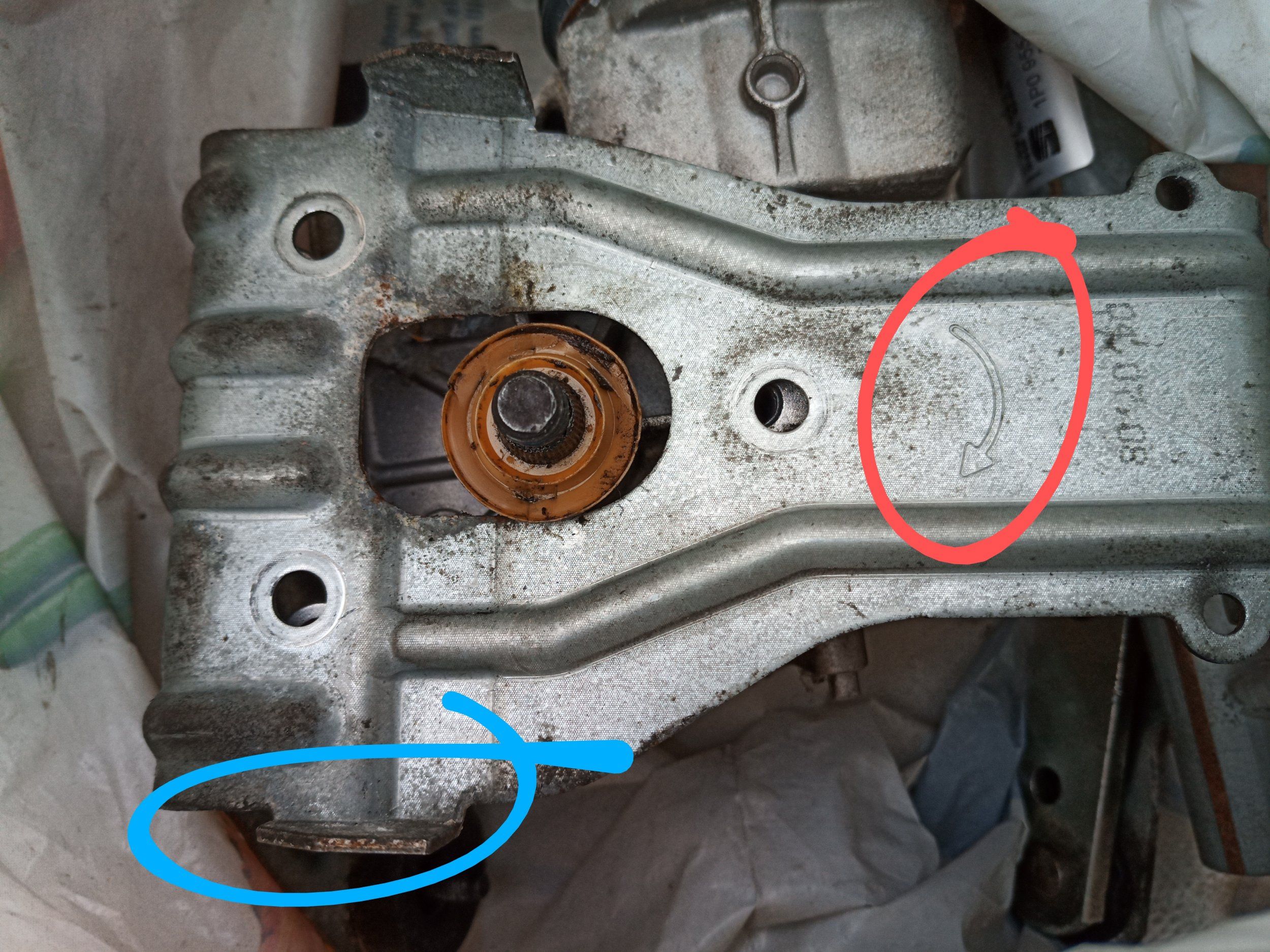

Do you mean this (circled red) ? As in rotate the linkage round in that direction and so it sits against the metal "stop" (circled blue)?

Yer that's the one but for me it was at the stop at the back. It's front of you have it set in service position. It's back if in standard position.

Hey! First of all, sorry for my bad English. I have a question, that connects to the red circle with the arrow. If the linkage sits on the blue circle means it's on service position, or it's on standard/parking position?
Do you mean this (circled red) ? As in rotate the linkage round in that direction and so it sits against the metal "stop" (circled blue)? View attachment 16083
