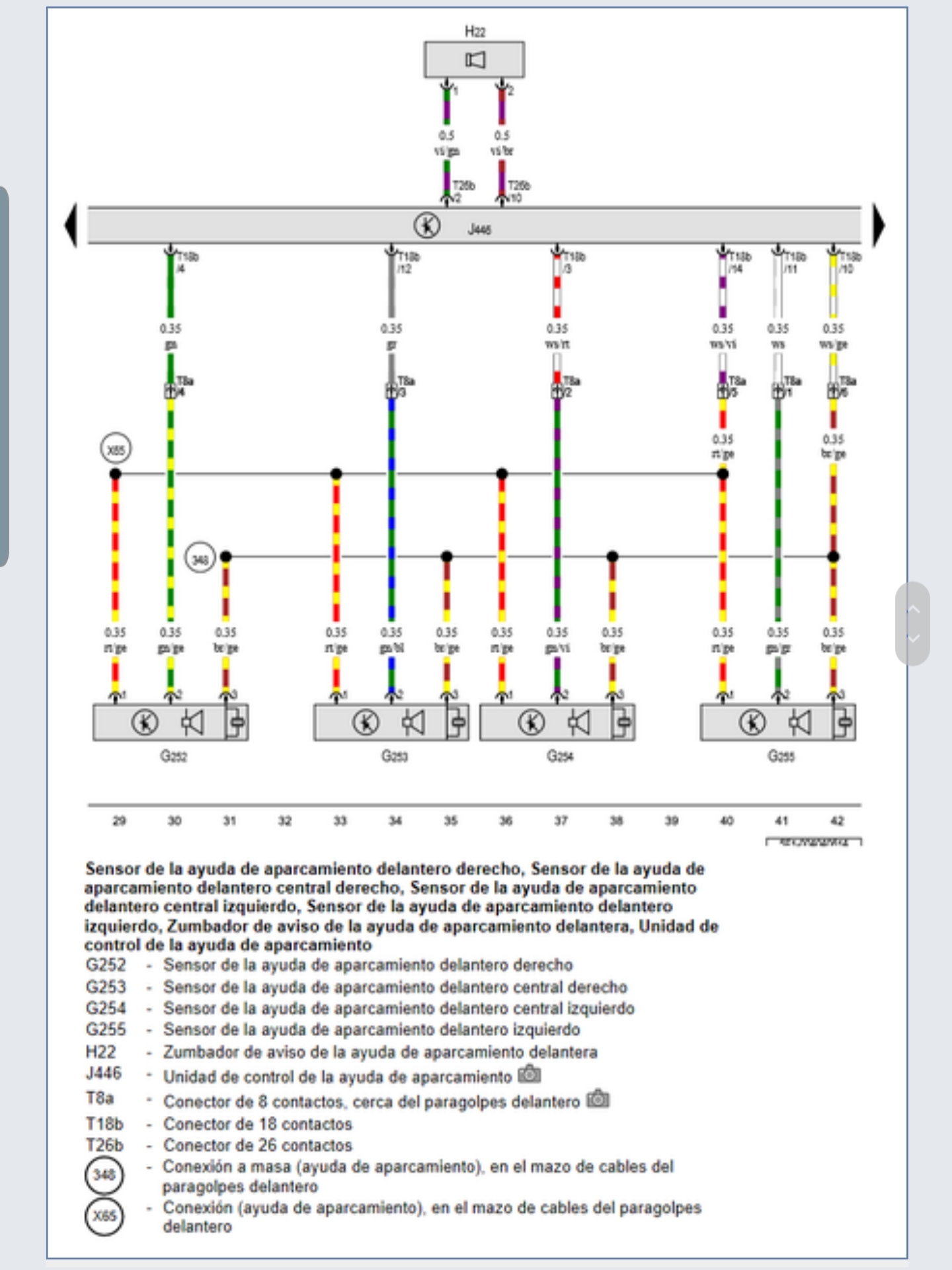

Cheers for the reply, I've got all those manuals but can't find what I'm after. I've seen diagrams like the one below and they seem to be in a program, can't find what the program is called but people have got access to it as I've seen various digrams like this one on other forums:

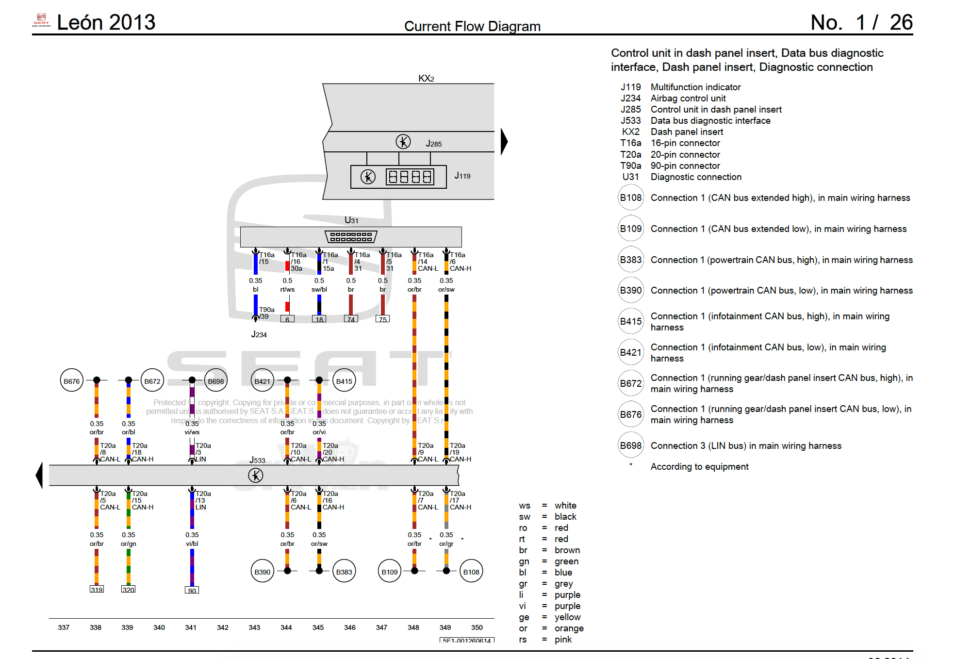

have you looked at the basic equipment document's it has lots of diagramms like below if that is what you are after.
