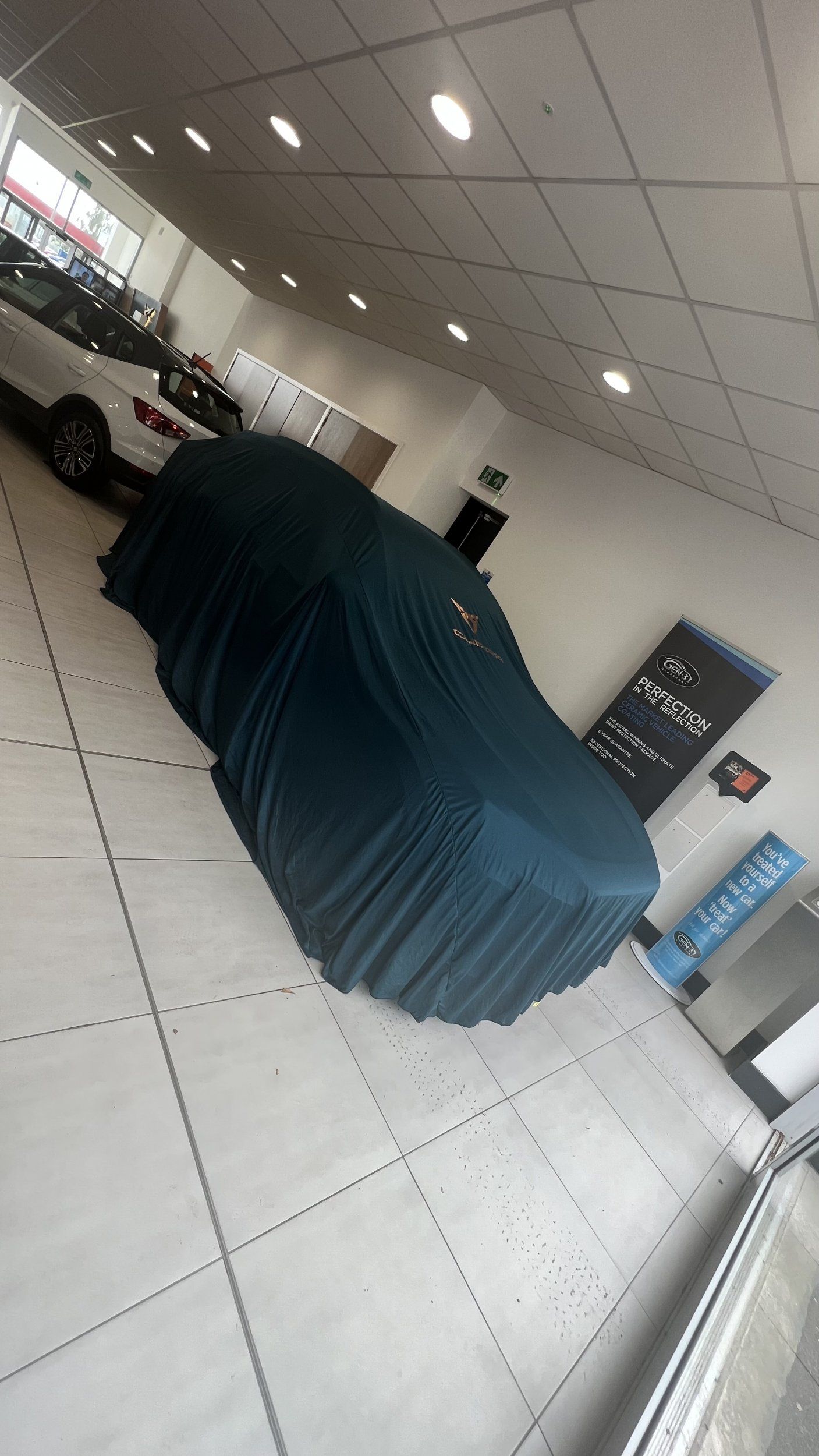

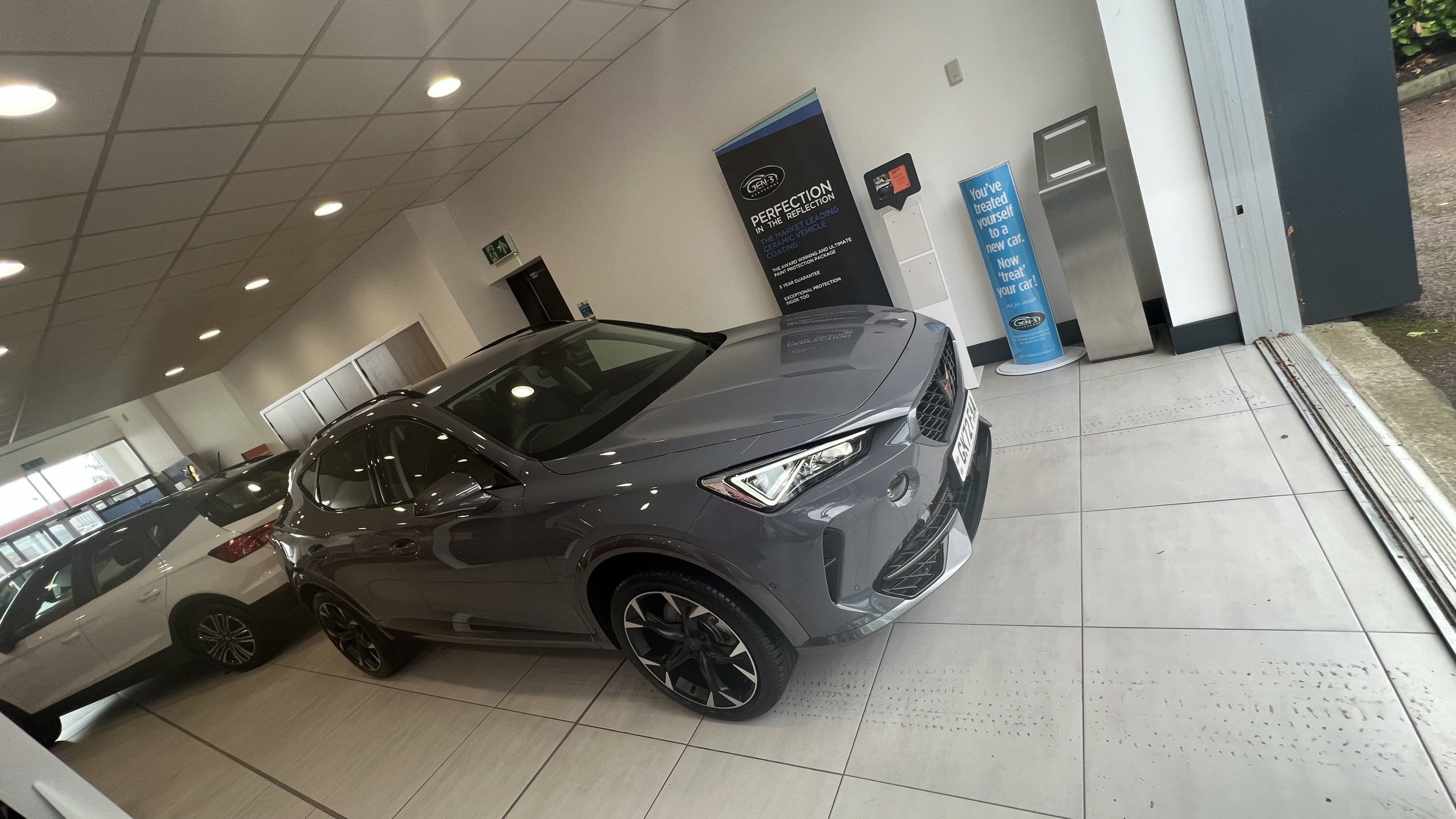

Just taken delivery of our new Formentor and thought best get the dash cam wired up
