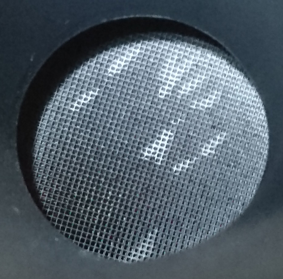

But because of the weird smell I started to suspect the catalytic converter after googling about it. I got some help and he could remove the connecting pipe from the rear end of the catalytic converter and look inside through the hole. There was nothing broken there and he didn't think anything was wrong with it.
We couldn't remove the front since the pipe from the engine is welded to the cat. And since he thought it was ok and he didn't really have the time I let it be. I asked if maybe it's clogged but he didn't think so.
I tried to take a photo of it, but was difficult to get a good pic.
I borrowed a cheap IR thermometer to check the temp of the cat. Drove it a while to get it up in temp and then checked the temp in the front of the cat and in the back. It was cooler in the front and hotter in the back. And from what I've understood is the way it should be.
