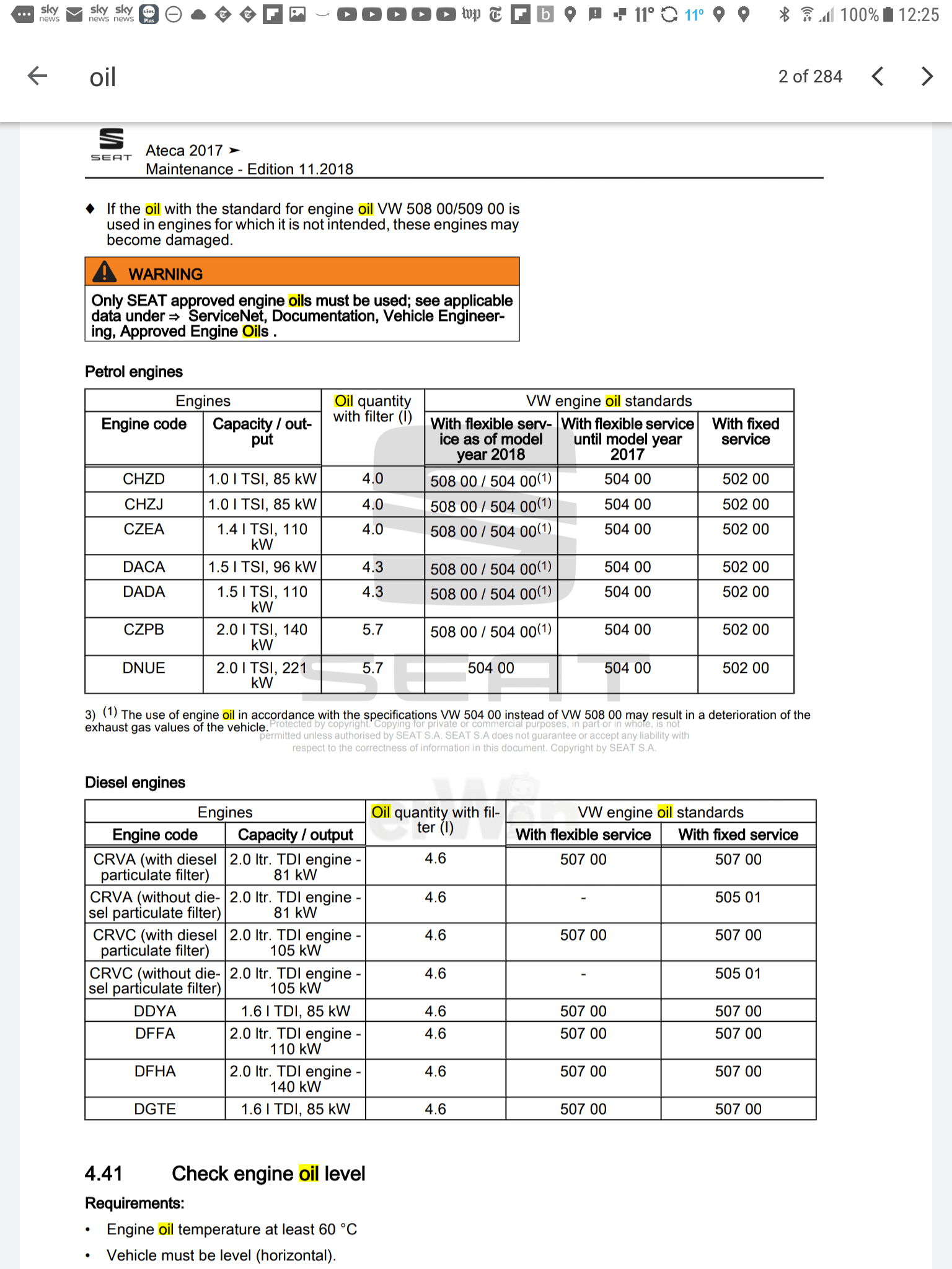

Hi all, can anyone confirm the engine oil capacity of a 22 plate Ateca 2.0 diesel 150 EZ DSG 4 drive?
Had an issue following a dealer first service at 9,000 miles. Two days after the service, warning light for too much oil came on. Took it in, they rang to ask if I'd topped it up since the service as they could see I kept oil in the boot... I hadn't, and i was surprised they'd been through my stuff to find the litre of oil I keep there.
Its really annoyed me tbh. I think they over filled and are trying to muddy the water in case there's damage down the line under warranty...
The job sheet shows 5.5 litres went in, which they confirmed today. I don't know if that is what actually went in, but I can't find anywhere in the handbook or on line what amount should have gone in. 5.5 seems a lot, but I'm not an expert...
