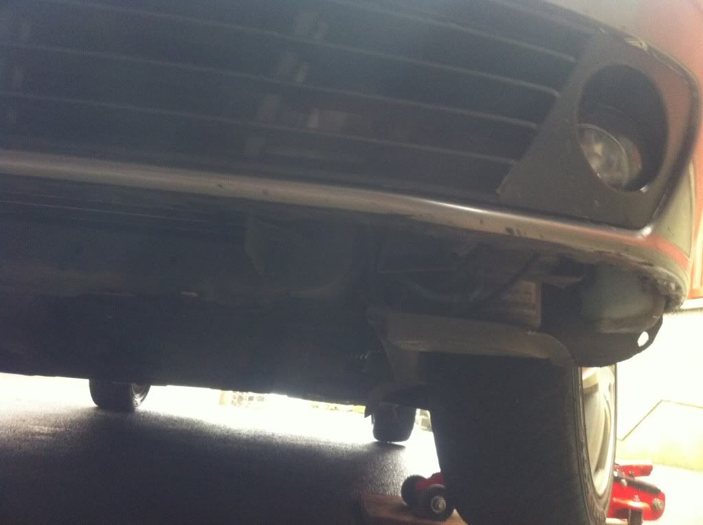

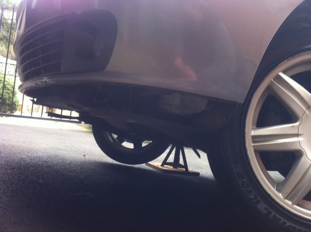

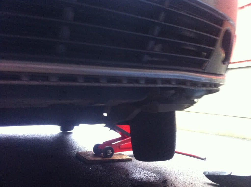

Jack car up to allow good acces.

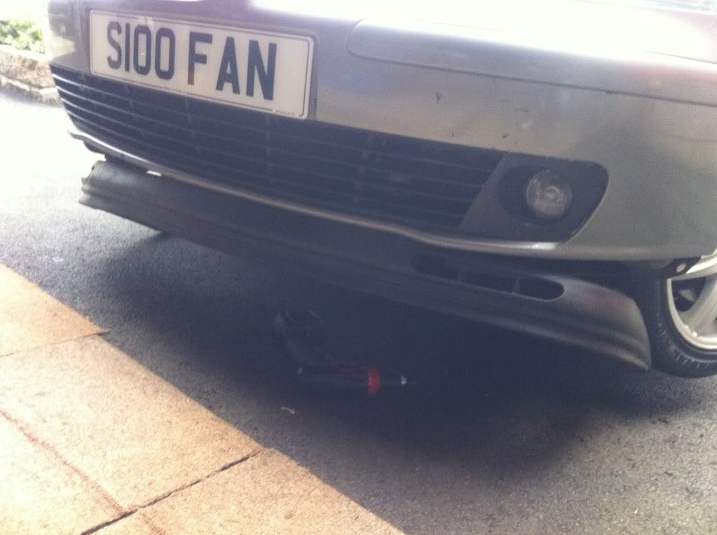

there are 6 or 7 T25 Torx head screws to remove from old splitter.

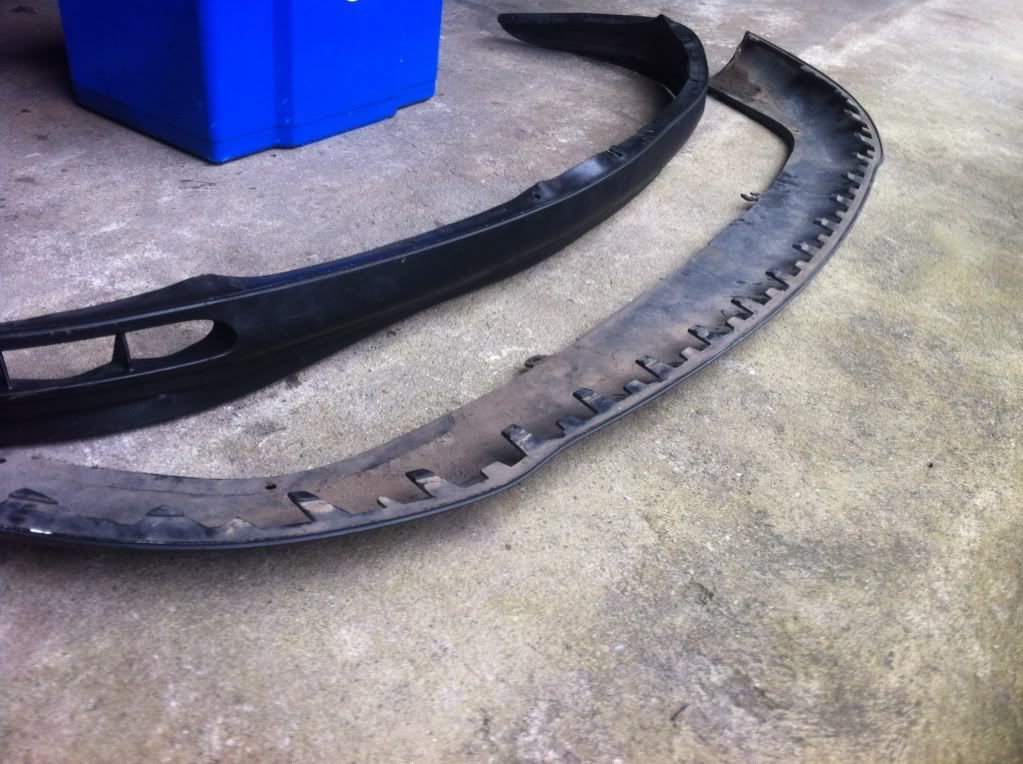

then just start pullin old splitter horzontaly out from the bumper ( dont be shy just jank it )

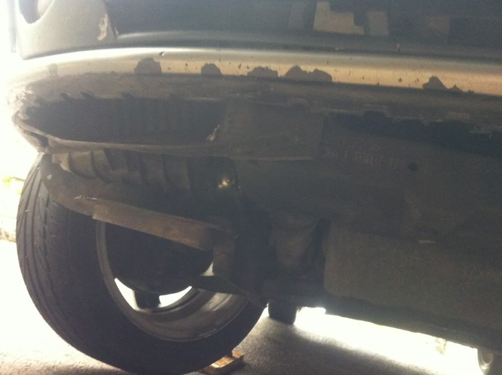

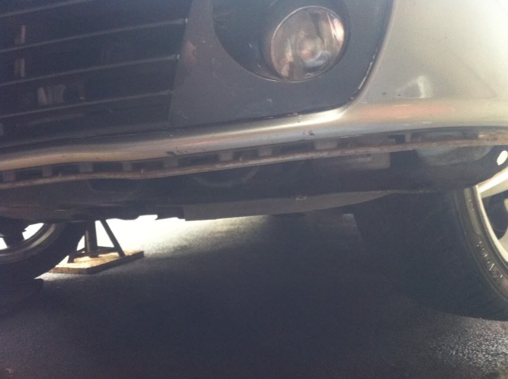

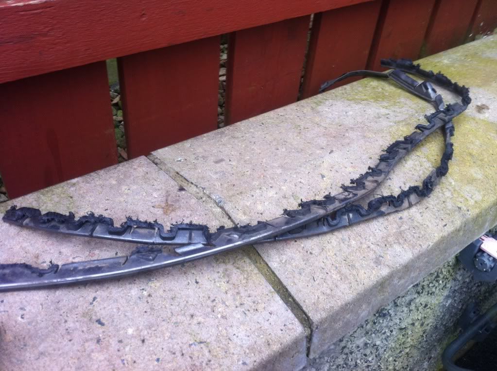

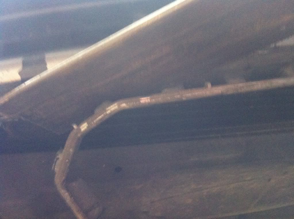

once its off you will see a vented lip of plastic witch held the old splitter on

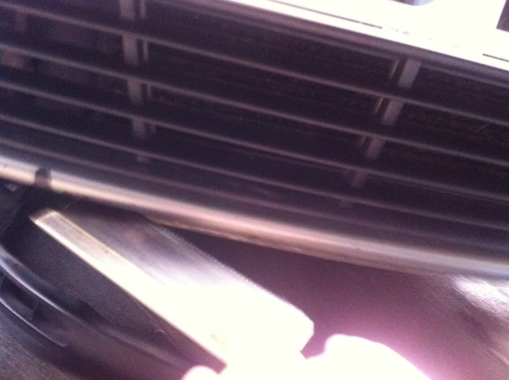

cut the lip of from the bumper (try and be neat with this)

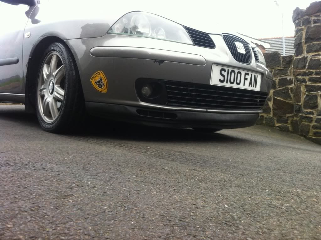

i used a 4mm drill bit along with the origional screws from the old splitter to fix the new one. find the center of the espace splitter and drill a hole threw splitter and bumper then fix screw in place to hold splitter.

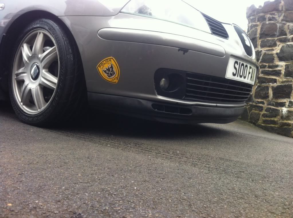

then just evenly continue around the splitter doin the same process of drilling and using the old screws. then just simply cut of the excess at either edge of the bumper.

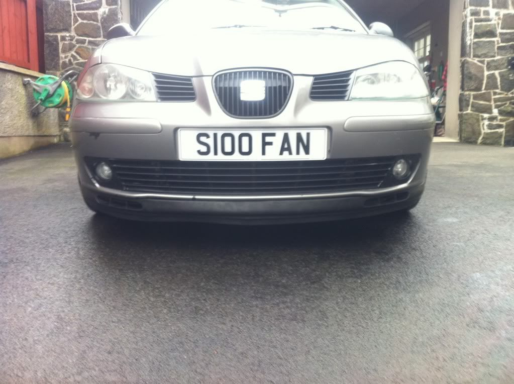

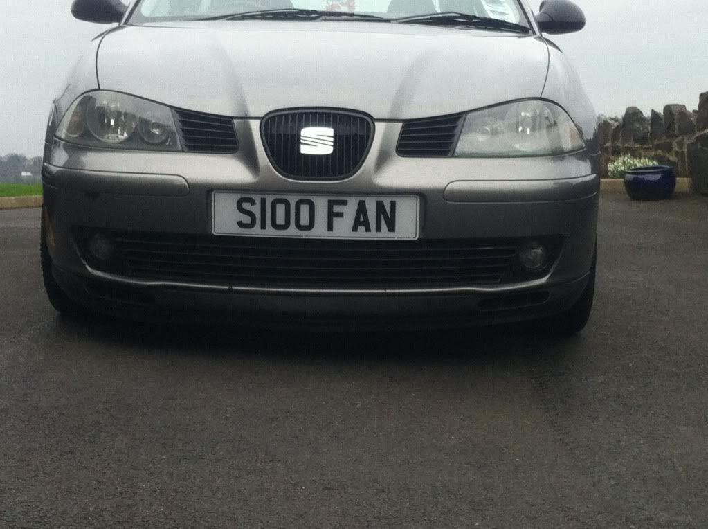

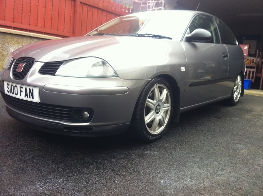

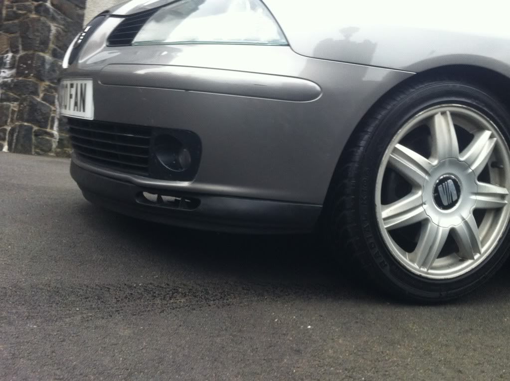

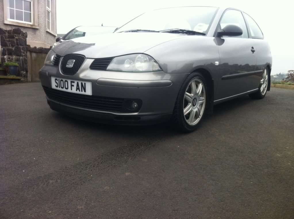

Finished produce - i think it has realy set the car off! Hope this helps folks cheers
