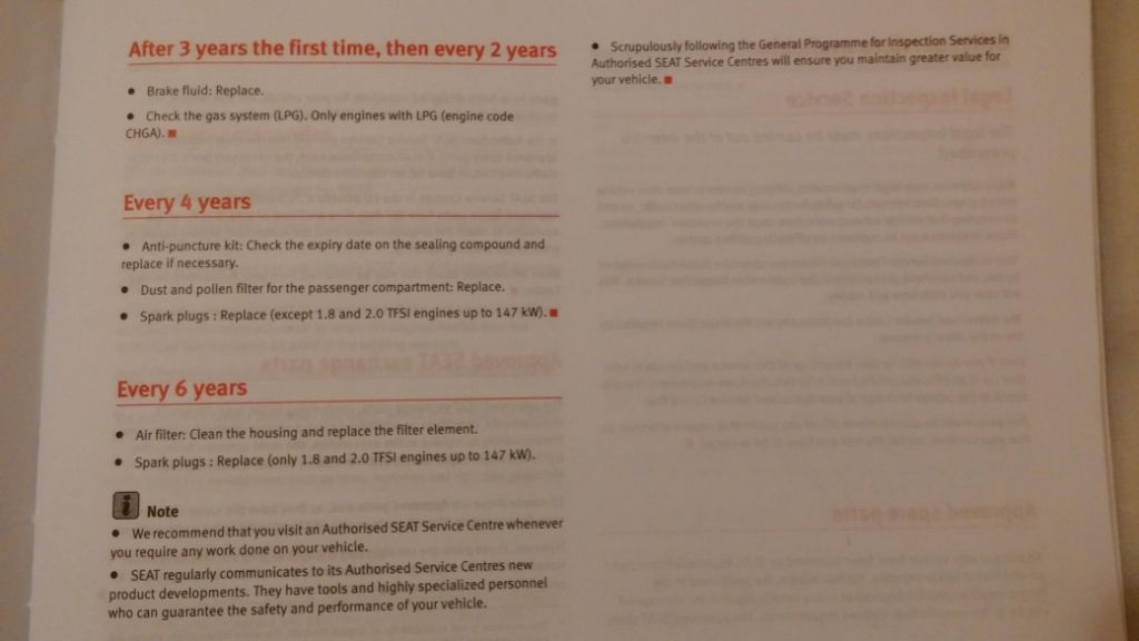

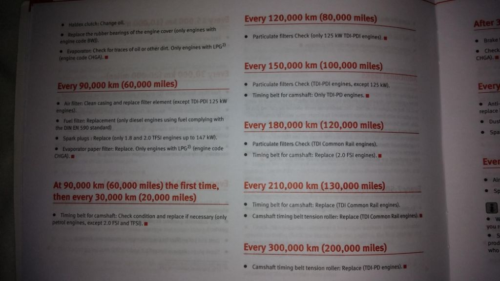

I posted the images of the owners manual up here somewhere and it says 120k for Cupra and Cupra R

Posted the second picture just now, mentions nothing about age.
Although I will scan the manual again and see if it mentions age.

Having quickly scanned the Maintenance Programme booklet cover to cover there is no mention of the age, it purely says 120k miles.
There is a mention of a check of the poly v-belt but that is done at an inspection service which is after the first 3 years or 40k miles (whichever is first) then every 2 years after that.

I'm lucky because it was done when I bought the car less than 10k ago so my plans are not to worry about it at all lol.
If I were you mate I'd just go with what the manual says, as hard as it is because this 4years or 60k kind of gets drilled into you as it's what everyone spouts out when a cambelt is mentioned, but it wouldn't be in the manual unless it was the case.
If you have the money and want to get it done then fair play but if money is an issue then I'd go with what it says in black and white :)
