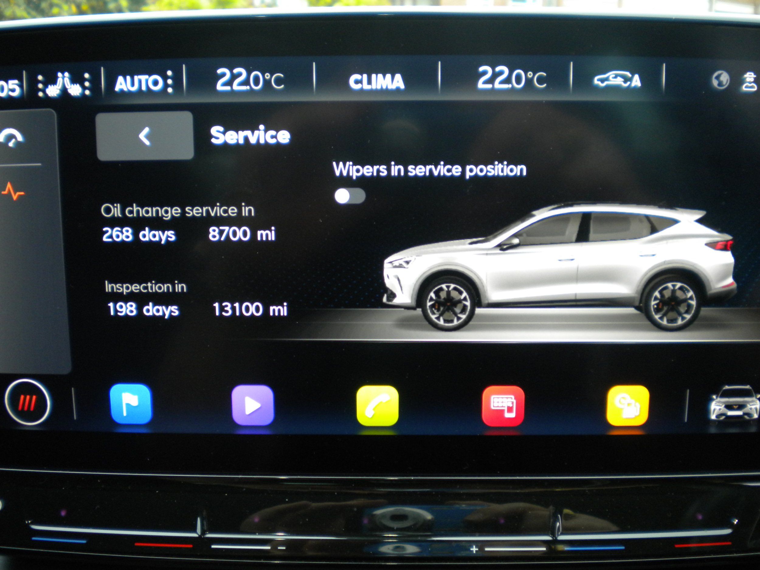

This Cupra servicing is confusing me again, I had my VZN serviced in April 2024 the message in the car stated an "Oil service" was due I had this done which was listed by the dealer as "Seat 1st Service" which consisted of an Oil change (Long Life Oil) and a "Visual health check" for £235 then again this year another "Oil service" 12 months later which was stated by the dealer as "Cupra Interim Service" which consisted of an Oil change (Long Life Oil) an Air Con Re-Gas and a "Visual health check" but with a more intensive list than last time for £458!
Now I have this message in the car so the 198 days will take me to the end of April 2026 for an "Inspection" is that the same again as a "Cupra Interim Service" with a Long Life Oil change again @ £117 a time for the Oil, then 268 days or 9 months later another "Oil service" with presumably another" (Long Life Oil) change!
So whats going on with this Cupra service shedule especially with this expensive Long Life Oil that is apparently changed as any normal engine oil!

The service regime on a vehicle with fixed intervals should be:
Oil change around 9350 miles or one year
Oil change with inspection around 18700 miles or two years and pollen filter (A/C, Brake fluid and Haldex recommended)
Oil change around 28050 miles or three years with MOT (Haldex recommended)
Etc

Hence why I say I am confused - so if the Cupra is serviced every year or 9350 miles there is no need for Long Life oil mine was serviced at 12 months and 6670 miles then again at 2 years old it was on 11350 miles and had the Air con re-charged, pollen filter changed but no Brake fluid or Haldex change!
So if the service regime is as you say shouldn`t the dealers know about it, also the first service they used 0w30 Long Life Oil the second service (same franchise different dealer) they used 5w30 Long Life Oil when I questioned the 5w 30 oil I was told its the same, and since then Its been back to the dealer that did the 1st service with a check engine warning lamp fault and they say 0w30 should be used in newer vehicles as it improves fuel consumption and 5w 30 in older vehicles!
I`m begining to think it might be better to go to Halfords etc for servicing as they might have better knowledge what is required!
You'll probably find that most, if not all oil used in dealerships now carries the longlife wording.
With it being longlife oil it doesn't necessarily mean that it's only purpose is for use in variable servicing. It can be used in most engines with the key advantages being increased efficiency and minimal emissions.
Yes, the dealership should realistically know about the services you need on your vehicle, but more often than not, the person or people you deal with will never have had their head under a bonnet.
You can send me your VIN and I'll clarify what it requires? Or best of luck with Halfords, they have their own level of horror stories...
