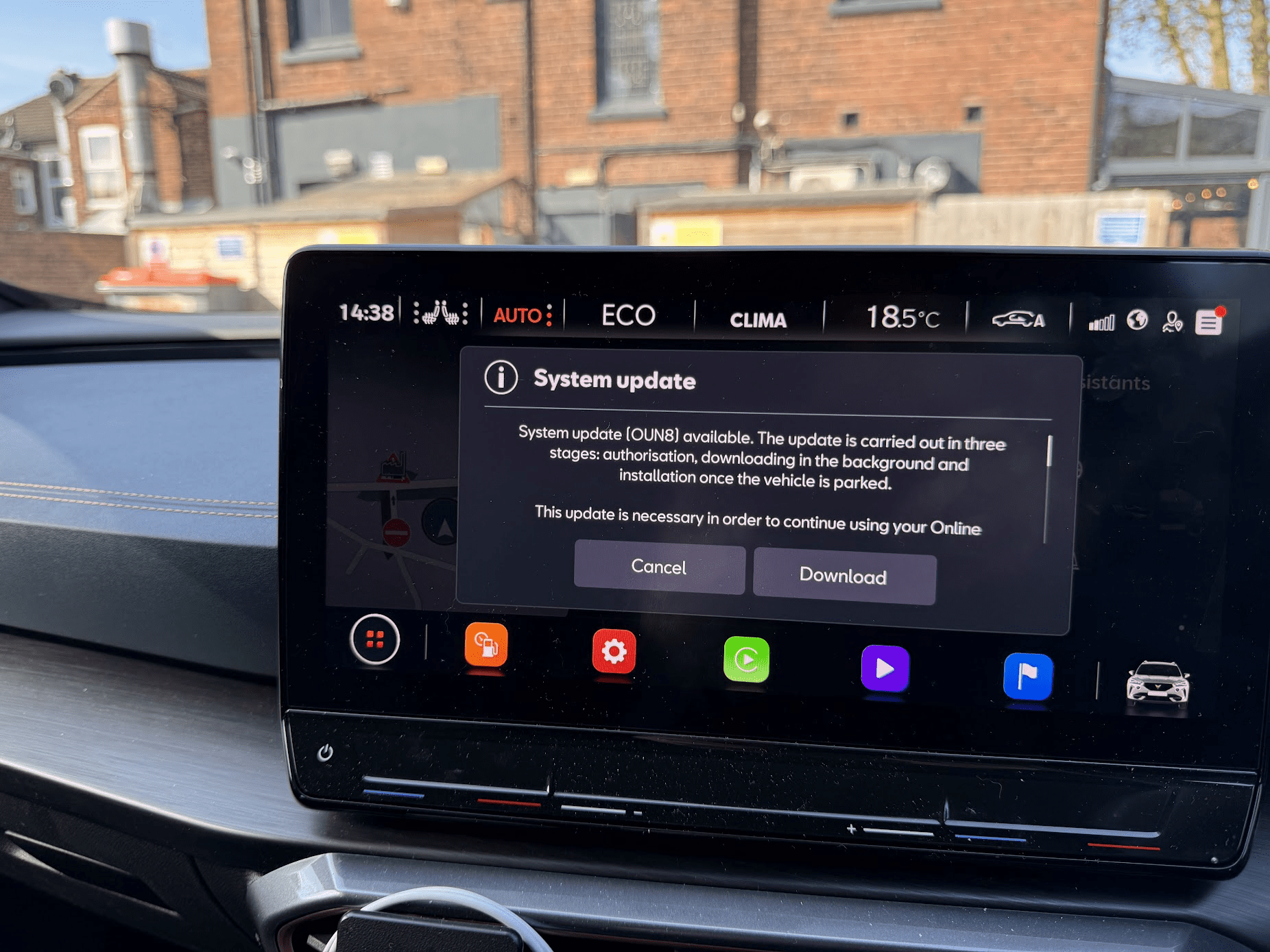

I had the SOS module replaced a couple of years ago... which googling seemed to pertain to... download size is about 140MB... so a sizable chunk... please don't mess things up for me!!!
Well yesterday I received it. It was a pain after that. All user details lost needed to log back again. Trying to recall the password etc. Not sure what it fixes. I didn't want that anyway. I need a car and not a smart phone which just keeps updating every now and then. Time waste.

I've just received it and after logging in it now wants my S-PIN... Not a clue what it is and I don't remember ever setting one. So at the moment limited access as no radio or maps!!!
Just did mine last night and yes it does throw you out of your user record on the car. Fortunately putting it back on was much less stress than last time as they seemed to have made this much less of a problem (it was hideous last time) BUT as you say it asks for an S pin which I took a good guess at and told it not to ask again. You can reset this from the app if you have no idea of it I think.

Does any one have the details of what this update is meant to fix?
Yeah updated this morning and have had to sign back in but seems to have lost all speech commands. I don't see the usual WiFi connection top right of the screen where notifications would usually show so speech to text is no longer working. Anyone else with the same problem or idea what I need to check?
Yeah, I got it yesterday on my Leon. And it was a nightmare for me too. I eventually managed to “sign back in” as the Primary user, but now it won’t let me add a “secondary user” (my OH also drives my car) like I had set up before. Infuriating!
I tried using the website as well as the app, but no good. I even deleted the account of the secondary user, and tried to register with a different email, but it just won’t let me add a secondary user profile now! Gnnnnhhhh !!!
I think the firmware update has something to do with the internal SIM card and the recent switch off of the 3G cellular signals in the UK
