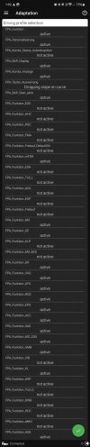

Gateway module 19 - Long coding - FPA function freilauf defaultON change value to "not active"
I forget where this screenshot is from, but I think it might be gateway module 19 adaptations (not long coding)? I took it yesterday so apologies if it’s the wrong screen. The settings on this page are default from Cupra - anything here look like it could disable coasting? FPA function freilauf and FPA function freilauf defaultON were set to ‘not active’ from the factory, yet it still coasts/ sails..

Tried that mate, but I'm missing one of the options. All good, cheers.
