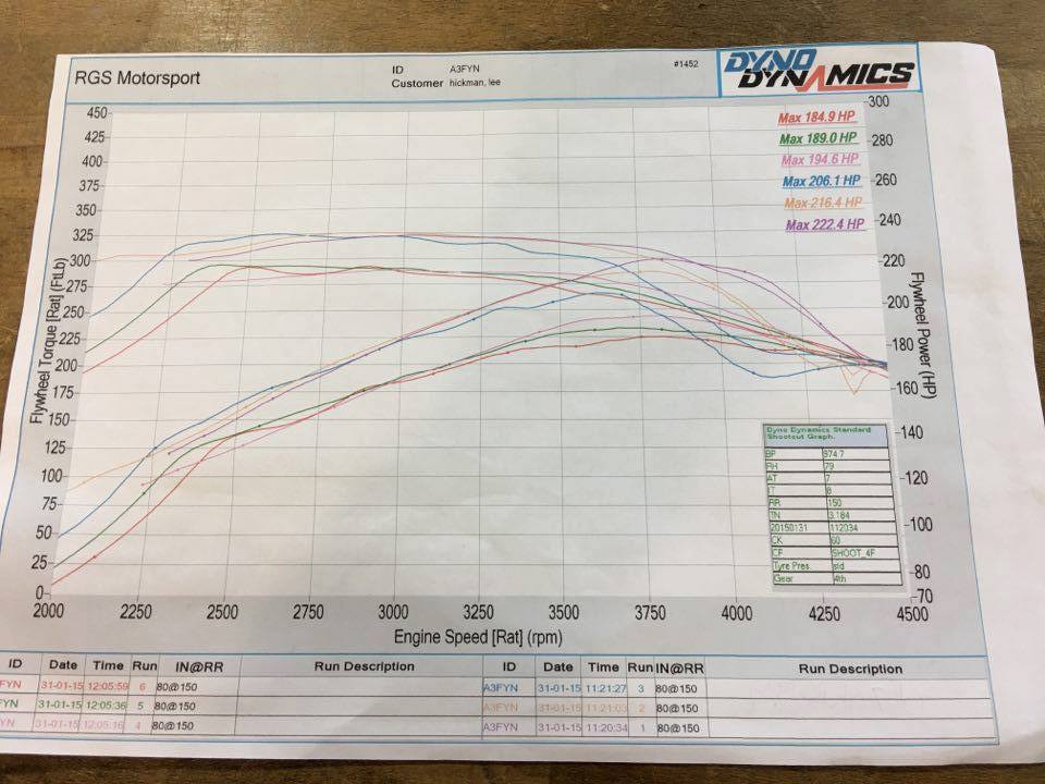

Sorry to hijack your thread pal didn't see the need to make my own, I have the 184 diesel FR I'm looking at getting a stage 1 remap just wondered has anyone here had one done, if so what are their thoughts on it? I know most fwd cars struggle for traction when the roads are greasy after rain but does a remap make that worse? Thanks in advance
well it gives it more power, so when it is greasy or wet outside, you'll need to edit your driving to suit. the 184 responds well and should go to around 222bhp without starting to affect the smoothness of the drive. I have attached our power graph from our file, I have done probably 15-20 cars with this engine (golf GTD/ Leon). You'd be very happy with it I'm sure. always worth doing. decent economy improvement too.
