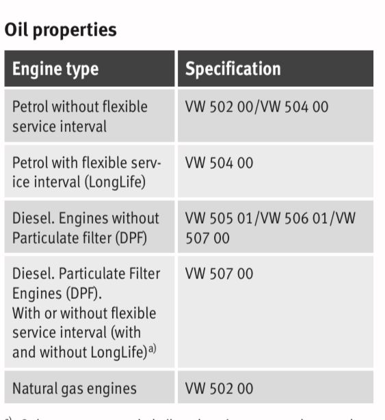

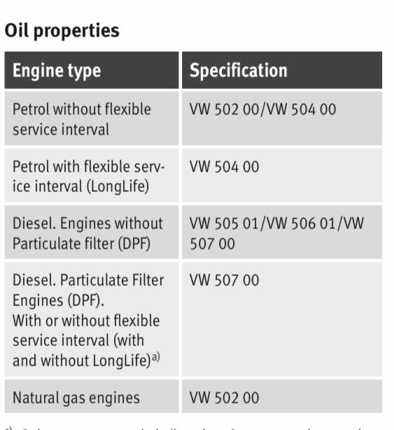

example from 2017 manual:
Interesting stuff. Manual says

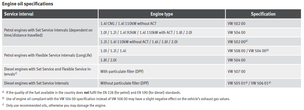

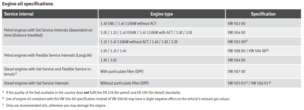

Interesting stuff. Looks like it was changed for the facelift (presumably for emissions reasons). Mine is a 2016 pre-facelift and the manual says:

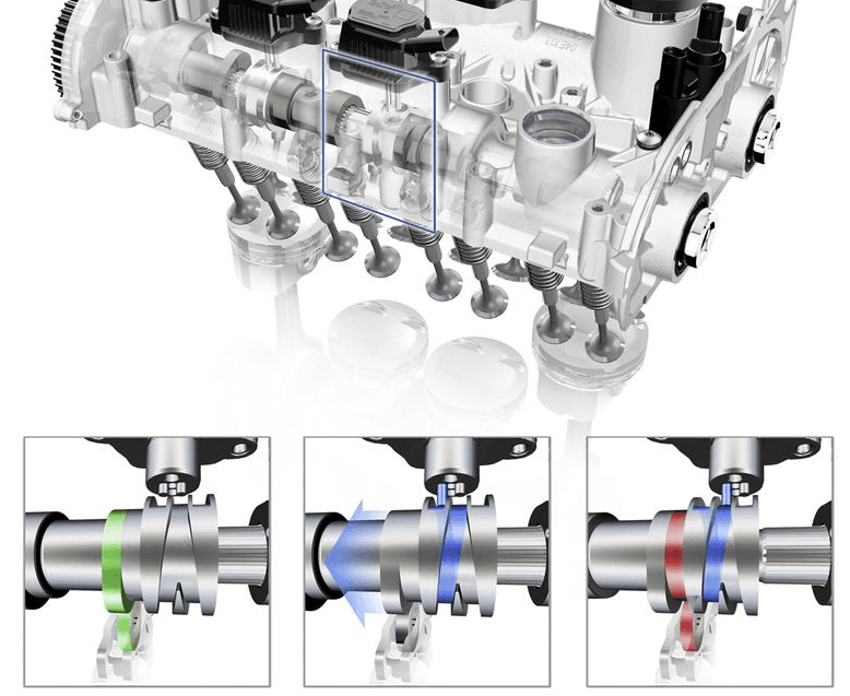

ACT has some rather special variable CAM 'which craft' which may need certain oil flow characteristics so if it was my car I would be using VW504.
