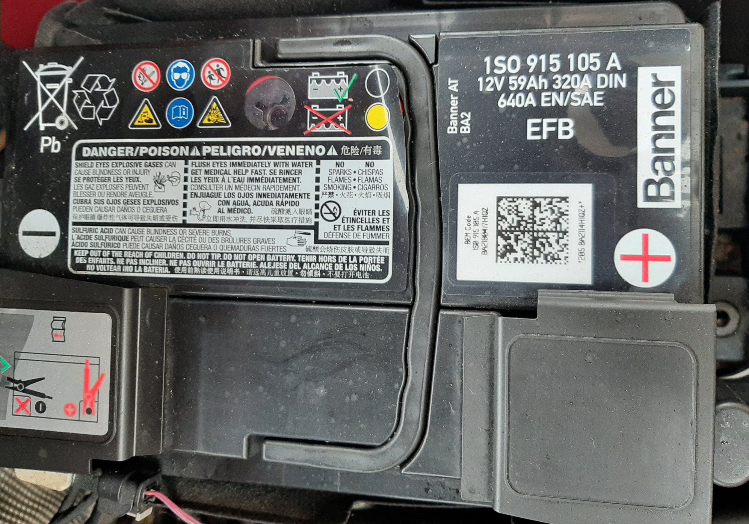

I have a 2016 MY 1.4 ACT 150 still with the original battery, the attached shows the later version of the battery fitted to my car, hope this helps.
I would go with what Tanya has listed. Make sure it's an EFB battery.
