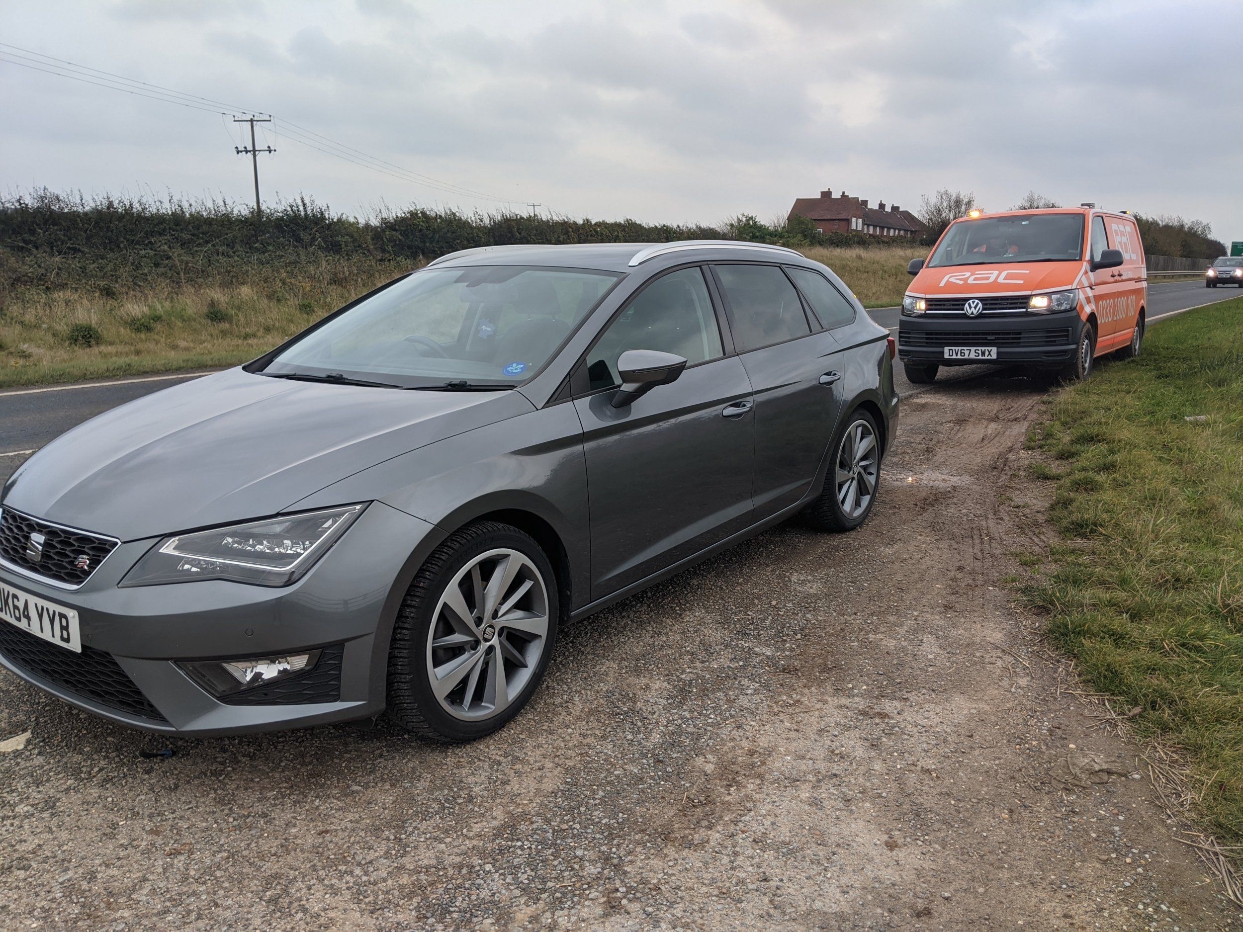

Spoke too soon. Engine ceased, serious oil loss, awaiting 250 mile tow home.

Don't know what to say... Car was running great, until it wasn't!
Cambelt was fully intact, but engine not able to turn over.
Didn't notice the puddle of oil until after moving it. RAC man suspects it's thrown a rod. So yes, potentially new engine territory.
I've just checked where I was parked last night and spotted sign of a possible oil leak, but hard to tell as I'm at a holiday place and it's dark. But there wasn't any warning in the car around oil. I'd hope that the car has a sensor and would've warned me if it was running completely dry...
It's on its way back to the local indie.
Hire car booked, beer open, holiday with the family continues...
