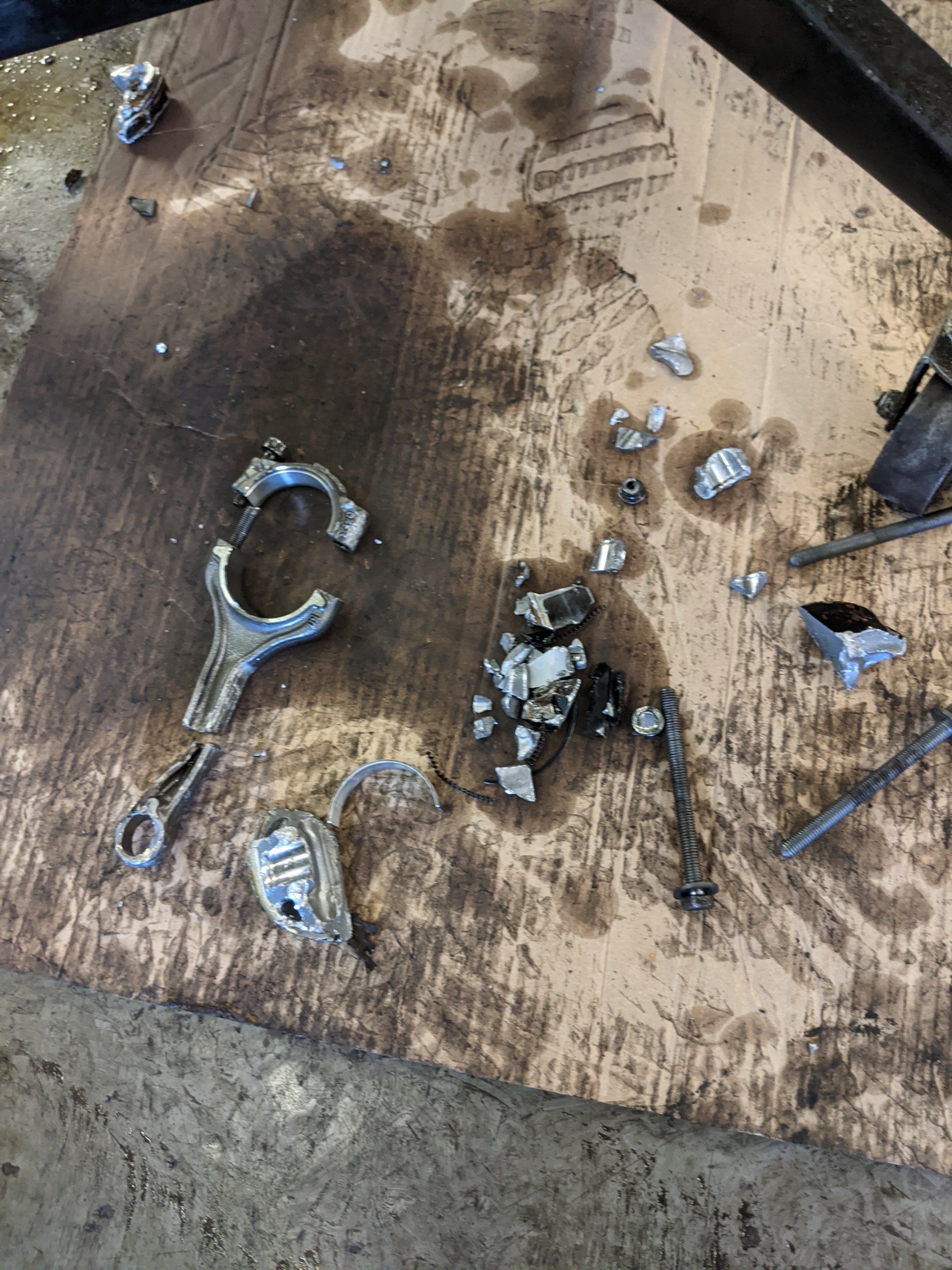

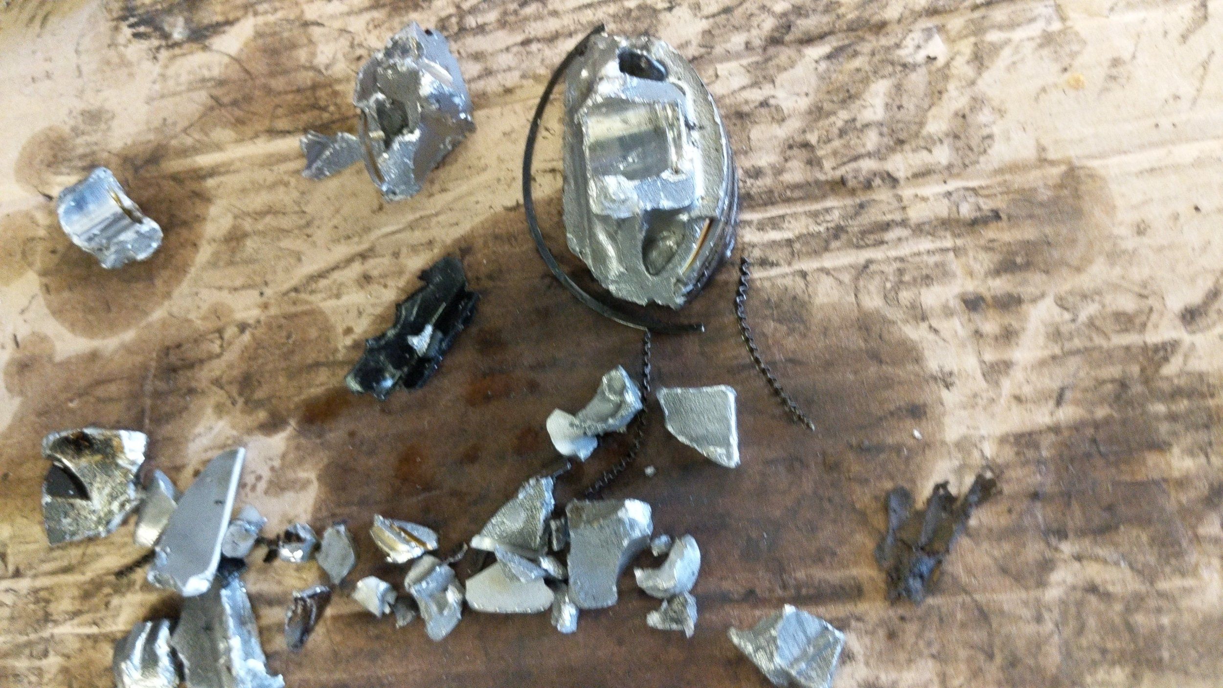

One thing I don't quite get is why, according to the OP, there is no damage to the cylinder head or valves!
the gudgeon pin seemingly prevents the piston going any higher. Gudgeon pin is just visible stuck in the engine block on photo 2.
Lots of bits of piston ring have come out.

other remains...

Like Rooster said, where is the piston? i think that the rod would bend under pressure and not break. If there is impact on the top of the piston it's more probable to be timing related but if so, the head and the valves would have some damage too. Also check that the parts are yours cause you never know :p that's why you need to be there when they open it. At my dealership they told me that they can scan the car and see the errors before failure. Maybe see the oil errors and understand better what happened.
I think that they started the engine with the wrong timing and hurt the engine.

Surely valve contact wouldn’t have done that to a piston? That’s either been overheated or put under a lot of stress. Anyone know if that engine has oil cooler pistons?
My guess would still be timing, the spark firing too early while it was still on the compression stoke. It wouldn’t need to be out by much since the piston would get hit a few hundred times a minute.

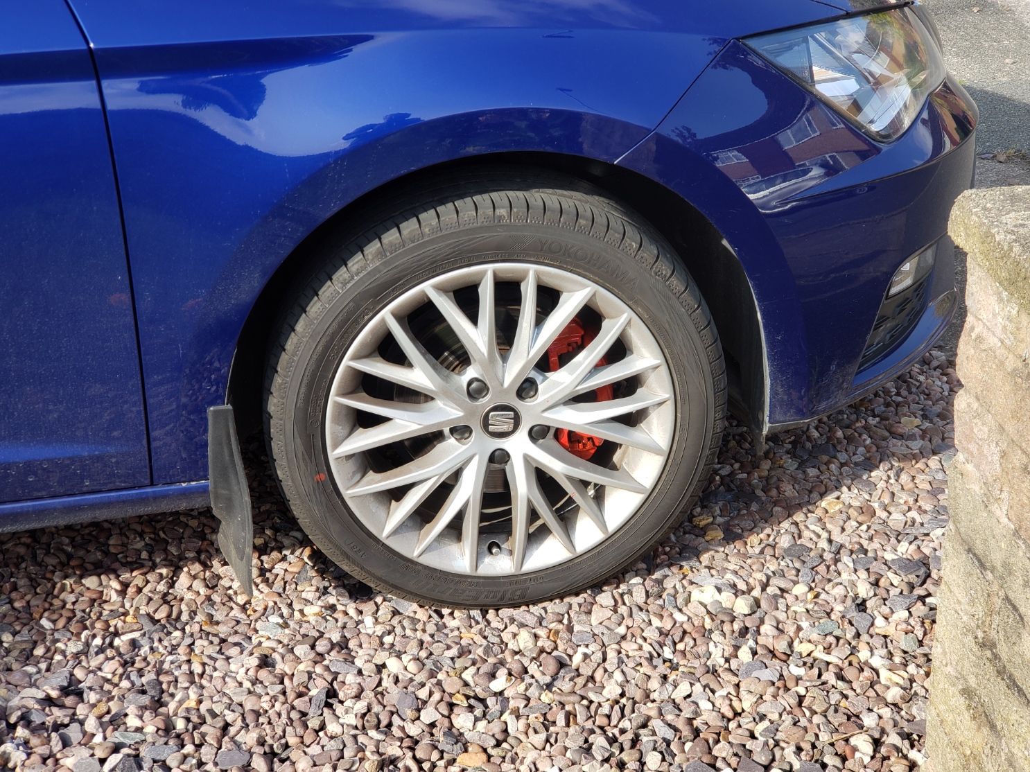

I'm glad I'm not the only one.......Nothing does the OCD in more than the centre cap not lined up properly with the valve, and the locking bolt directly next to (or opposite, depending on the wheel design) the valve....
You are not the only one with regards to the locking bolt! Now you've got me thinking about the centre cap!! :D
